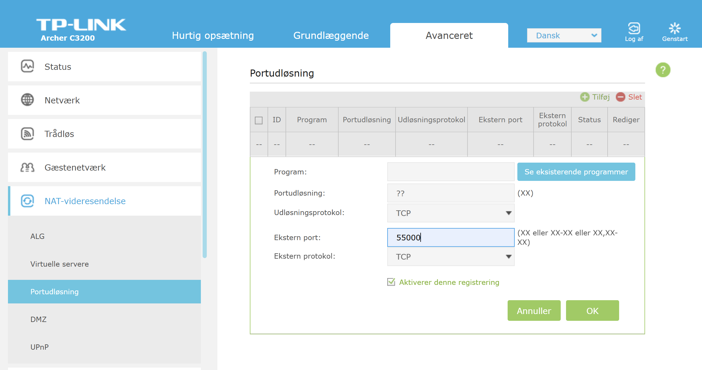

How can I configure my TP-Link Archer C3200 router for ARC Port Forwarding? What is the port (XX), protocol (TCP), External port (55000 ?) and external protocal (TCP).
Please advice how to setup my router for correct ARC Port Forwarding, so I can access Roon via the Roon ARC app, when I am not at my home.
· TP Archer C3200
In essence, on the port forwarding (virtual server) screen you add the following information.
  • Service port: 55000
  • IP address of Roon server
  • Internal port, also 55000
  • Protocol: TCP
  • Enable the service (tick box)
The XXs indicate either one or more ports, or a range may be used.

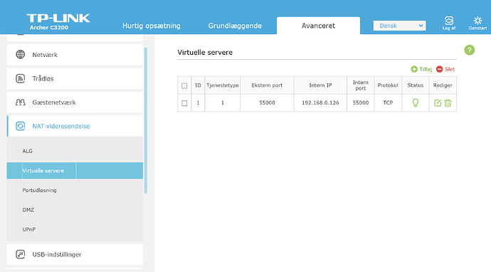

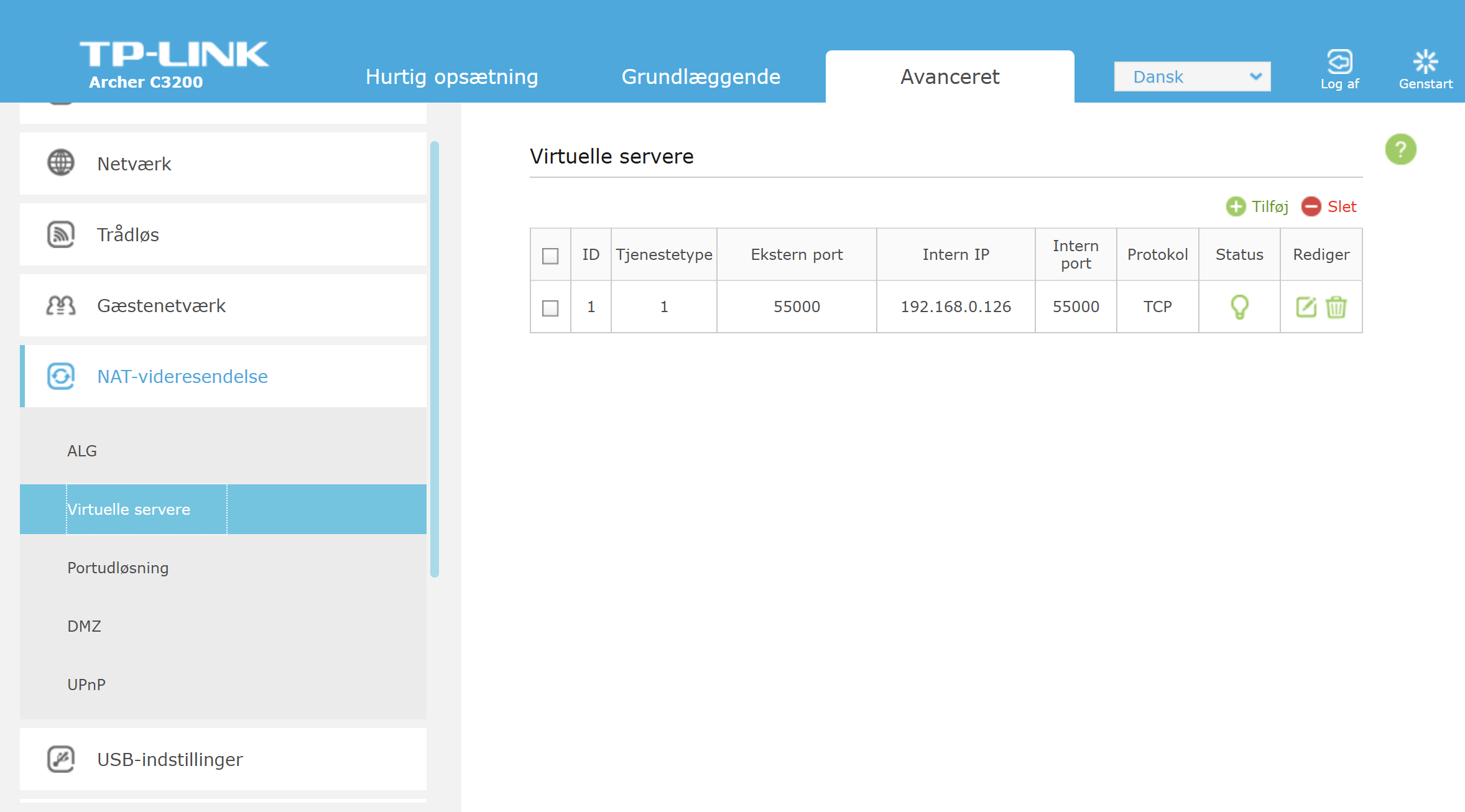

I have tried to follow the guidance for setup of virtual server (instead of “portaludløsning” aka, portal forwarding), but it did not seem to help:

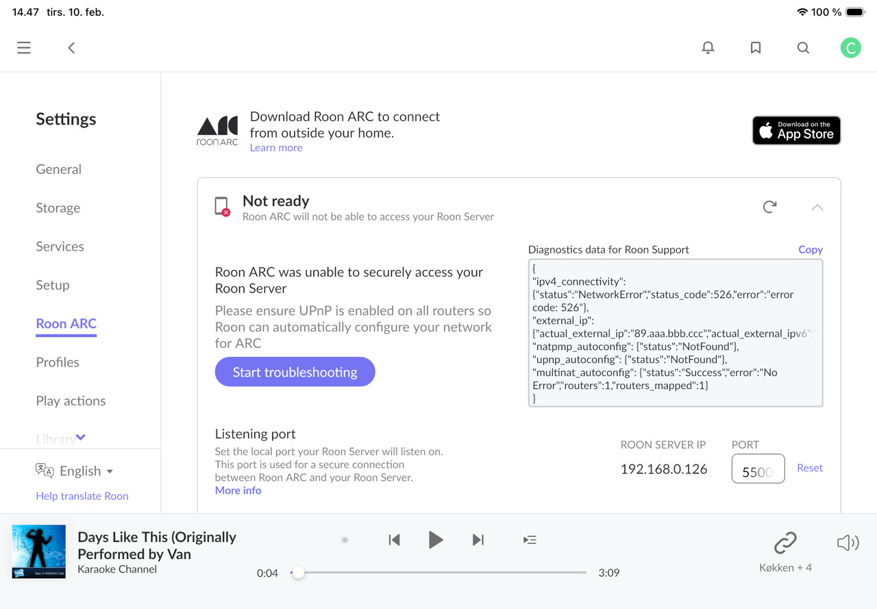

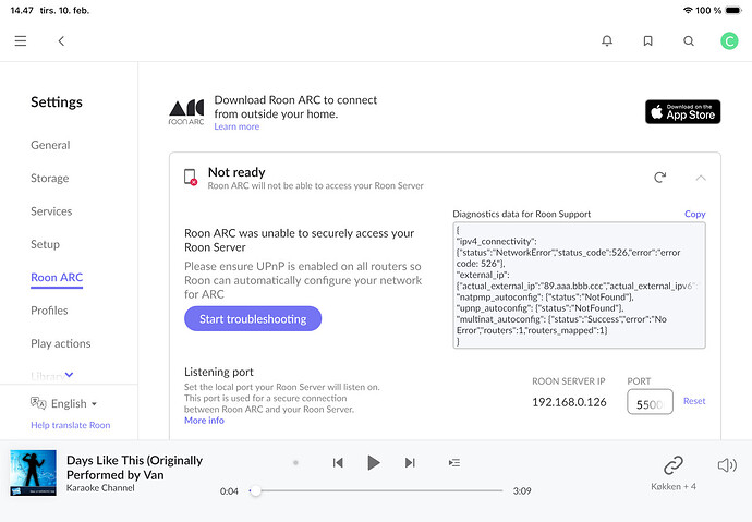

Here is the diagnostics data for Roon Support:
“ipv4_connectivity”: {“status”:“NetworkError”,“status_code”:526,“error”:“error code: 526”},
“external_ip”: {“actual_external_ip”:“89.aaa.bbb.ccc”,“actual_external_ipv6”:“null”,“router_external_ip”:“89.aaa.bbb.ccc”},
“upnp_autoconfig”: {“status”:“NotFound”},
“multinat_autoconfig”: {“status”:“Success”,“error”:“No Error”,“routers”:1,“routers_mapped”:1}

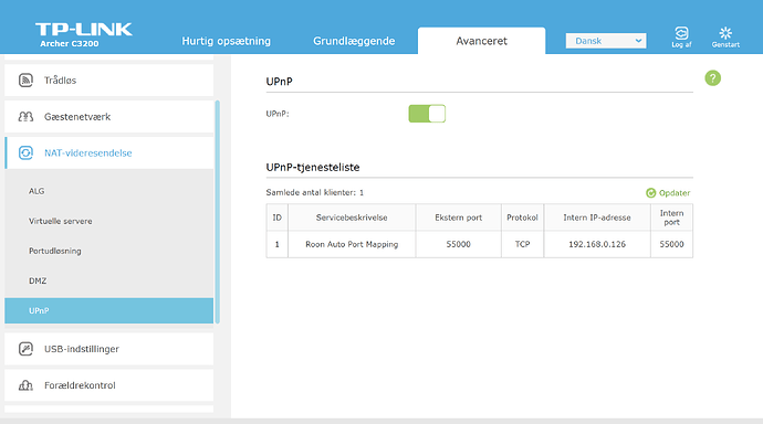

I have also a screen shot of the UPnP settings on my router:
Please advise how to fix this issue, so I can access Roon using my Roon ARC app, thanks.
Trying turning off UPnP (first screenshot.)
Thanks. I tried turning off UPnP and restarted the router, but I still have the same issue.
Error 526 is a Cloudflare-specific error indicating an “Invalid SSL Certificate.” Since Roon ARC relies on Cloudflare’s infrastructure to establish a secure connection this means something on your local network is intercepting the secure traffic and replacing the SSL certificate.
You may have some advanced security setup in your router that is changing the secure connection. You may aslo check if your Roon server is allocated a static IP by the router, as this could help.

Regarding the Error 526 you noticed in the diagnostics: our team has confirmed that this was a temporary issue on the Cloudflare side that has since been resolved. It was essentially a “false positive” error message that didn’t accurately reflect your local network state.
Since you have already configured the Virtual Server (Port Forwarding) and disabled UPnP as suggested, the connection should now be able to establish correctly.

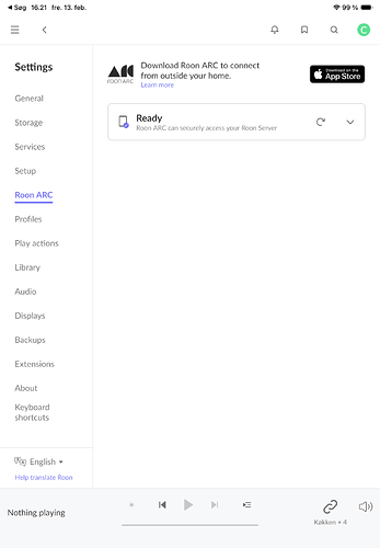

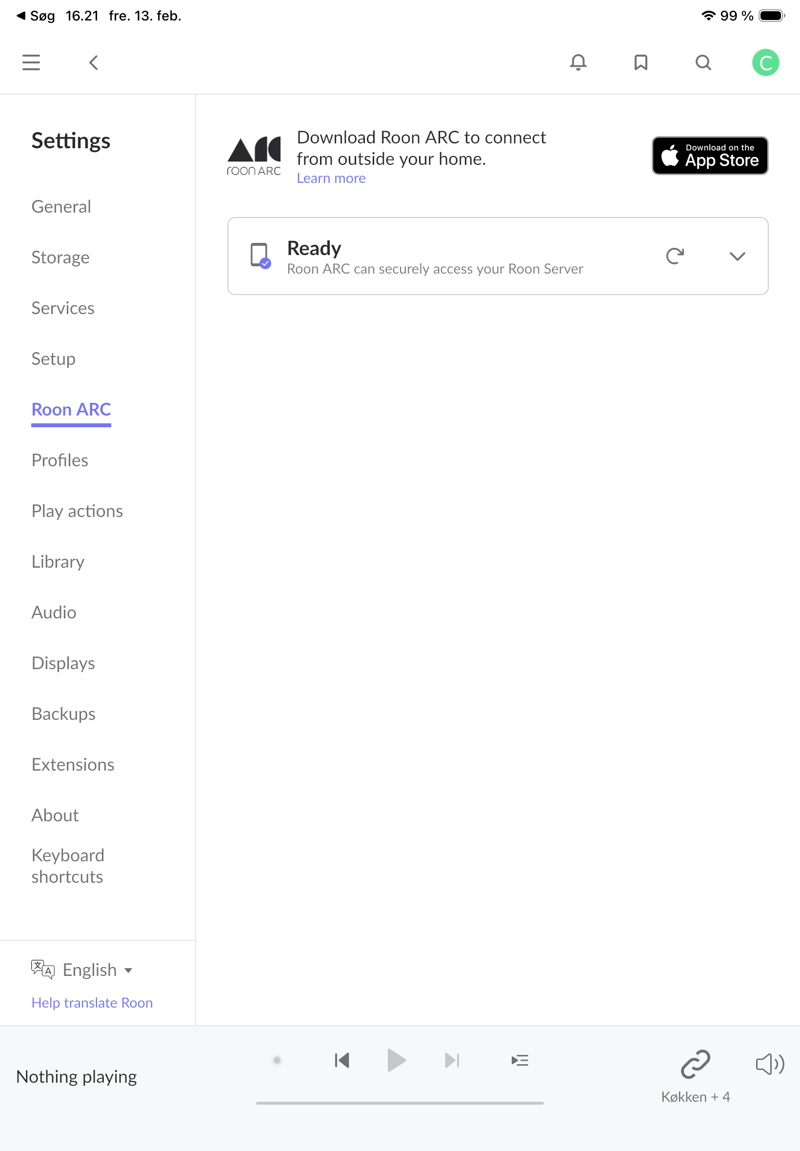

In the Roon app the Roon ARC status changed back to normal as you can see, but I still get the same message in the Roon ARC app when I open it:
There’s an issue with your Roon server. Your Roon server is online but there’s an issue that’s preventing access.
Please advice how to setup my router correct to be able to access Roon using the Roon ARC from anywhere.

Hi @Carsten_Suhr,
If you are seeing the “Ready” status in Roon Settings -> Roon ARC, this is great news! It confirms that your port forwarding rule is working correctly and that Roon’s cloud servers can successfully reach your local Roon server from the outside world.
Since the server side is verified as working, the issue likely lies somewhere in the connection path between your specific mobile device and your home network.
