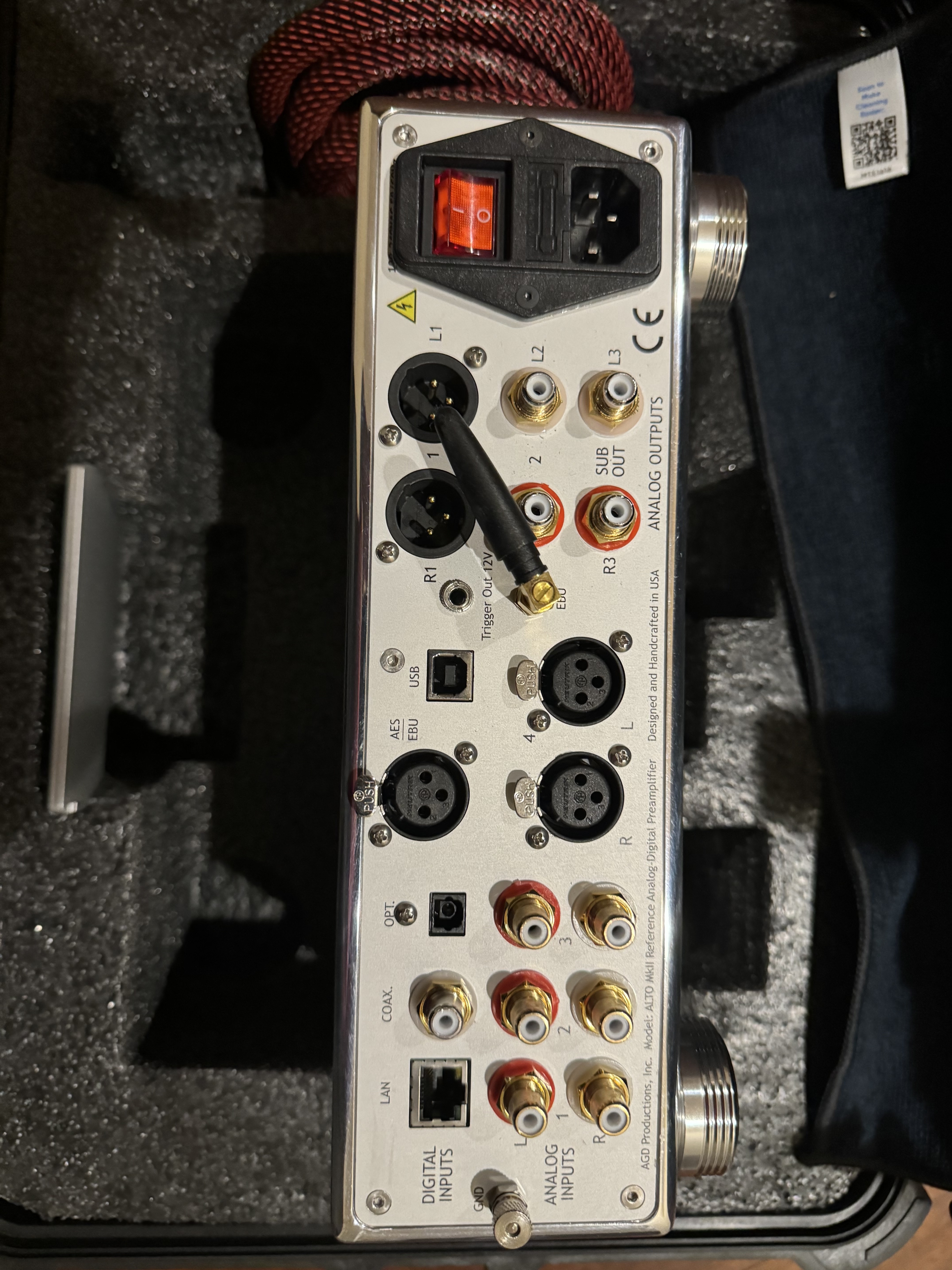

In the basement system running a Salk Stream player III SE acting as a ROON core.
On main floor I have AGD Alto MK II pre-amp connected to AGD Audion MK III amps via XLR to Revel F208 speakers and via LFE to dual Rythmik e15HP2 subs. TV also connected to pre-amp.

It seems that your preamp does bass management internally, but their site is showing something with an entirely different rear panel as "Alto MKII? so its hard to say. If yours does have all of these digital inputs, then any streamer with a digital output should work. Depending on how much you want to spend on it, and how nice you want it to look, anything from a RaspberryPi or an old laptop with a USB port, to a dedicated streamer (Rose, Lumin, Holo, there are tons of them) would work.
