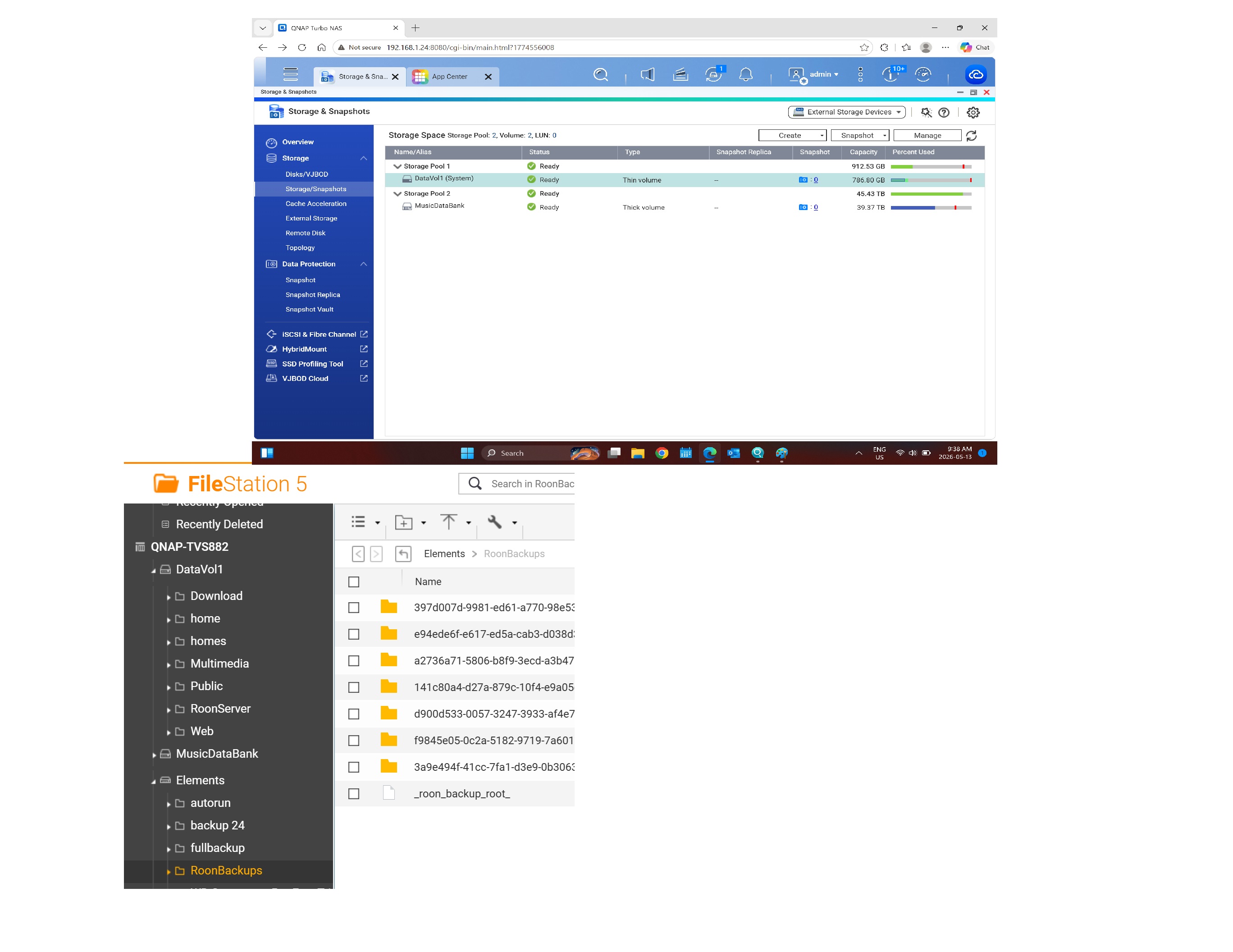

· Confused, in the volumes section of the docker compose file (yaml code) specifically the 1st (roon data ...) and 3rd (backups) are pointing inside the container. Is this not dangerous you could loss everything. Can I put both outside of the container as long as the storage mapping points the them. ie. /share/datavol1/roonserver/roon:roon
