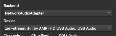

Select in the output the NAA
Screenshot 2023-02-18 at 7.21.55 PM
Yes, you setup HQP to use the Red NAA. Then as mentioned, Roon configured to output to HQP.

Now, you need to configure an output for HQP. The output you want is NAA and the Device will be your Red. The Red will advertise itself as NAA (once NAA is enabled) and appear in the dropdown (see example in response #6)
