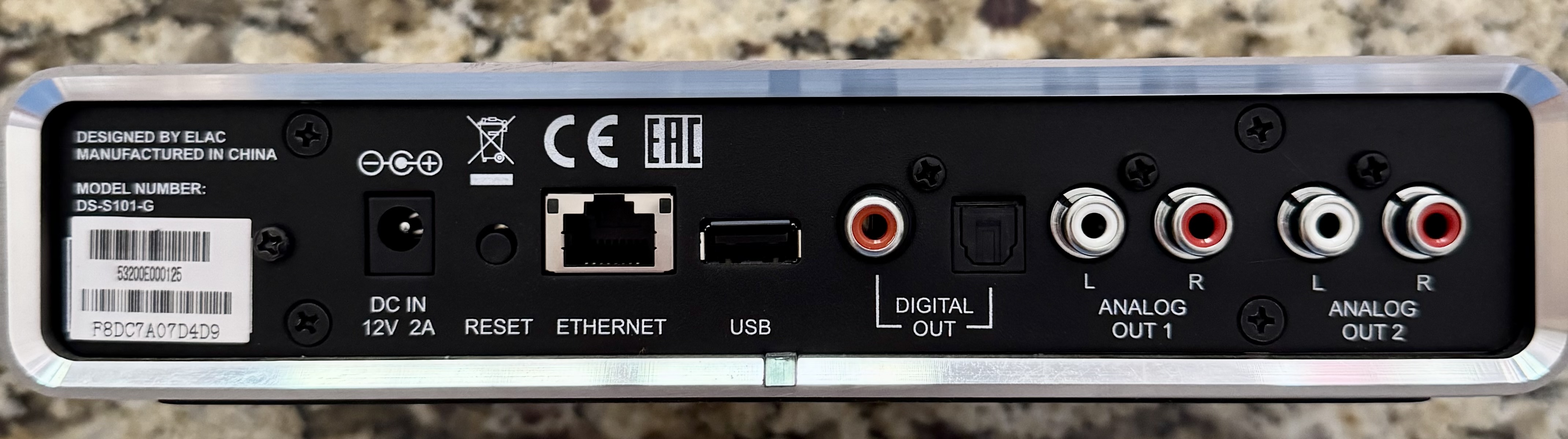

I needed to replace my ELAC Discovery DS-S101-G streamer so I ordered a Nucleus One.
Upon receipt I discovered I’m unable to plug it into my old beloved DAC, an Enlightened Audio Designs DSP 7000, Series III, since it doesn’t have USB or an HDMI port. I had used my ELAC streamer plugged into my DAC via RCA outputs, which the Nucleus One doesn’t have.
What are my options now? I won’t replace my DAC which I still love. Is it possible to connect the Nucleus One to my ELAC streamer via the USB port or some other way. I much prefer to remove the ELAC streamer from the system. Are there other alternatives?

There are USB-to-S/PDIF (coax and optical) converters:

If you’re determined to use USB, then a USB-to-optical converted as mentioned above will allow for a connection.
Alternatively, this ELAC Discovery series is a Roon Ready device. Is there a reason you’d prefer not to use ethernet?

But as the Elac is Roon Ready, this is probably the better approach.
I’m using Ethernet for Roon and my Synology NAS. I just don’t have a way to connect either to my roughly 35 year old DAC which was previously connected via coax or Toslink. I am currently researching which USB to coax/Toslink converter to purchase.
But you can use Roon Ready on the Elac and then output the signal from the Elac to the DAC with Coax/Optical as you did before.
Worth checking one thing before you spend anything: a DAC of that vintage usually only locks to 44.1 and 48 kHz on its coax/Toslink input. If you keep the Elac as the Roon Ready endpoint (simplest, no extra box), open that zone’s Device Setup in Roon and set Max Sample Rate to what the DSP 7000 actually accepts, with Sample Rate Conversion on, so hi-res tracks get downsampled by Roon instead of dropping out mid-album. Play something 96 kHz and click the coloured dot to read Signal Path and confirm what is really reaching the DAC. If you do buy a converter, USB to coax is less fuss than pulling audio out of HDMI, and coax generally behaves better than Toslink above 48 kHz. One buying note:

Thanks to everyone for the help. I ordered a USB to coax/Toslink converter. It’ll be here tomorrow and I should be good to go. Currently copying files from my NAS onto the SSD I installed in the Nucleus One.

I was able to resolve the problem. Since my DAC is ancient and Red Book only, I had to change Up to 96kHz to up 48kHz and Max bits from 24 to 16. Everything works now. Thanks all.
