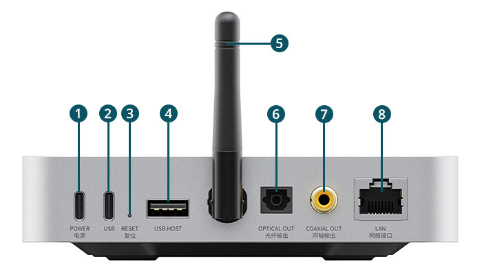

Buy a WiiM Pro, if you want to use coaxial or optical to connect to your DAC. Buy a WiiM Ultra if you want to use USB to connect to your DAC.
Connect WiiM over ethernet.
Stream Roon to your WiiM streamer.
Done.

I generally agree, but WiiM does not support DSD (something that @Jose_Cadalzo said they were looking for). I’ve tested the FiiO SR11 up to DSD256 and 32-bit, 768 kHz PCM from the USB output. DSD64 works from the S/PDIF outputs via DoP with compatible DACs.

Fans of DSD are generally not satisfied with streaming transports that convert DSD to PCM. They want a transport that bitstreams DSD to an external DAC instead, like the FiiO SR11, Raspberry Pi running RoPieee, etc.
I love the WiiM products. I personally own nine of them. They are my default recommendation for Roon-compatible audio devices. However, WiiM is not a fit here if native DSD playback is important to @Jose_Cadalzo.
They mentioned that USB jitter/noise is a concern; however, a modern DAC, like the Geshelli J3 is incredibly unlikely to be affected (measurably or audibly) by the tiny amount of jitter from these devices.
Reference: Playing DSD Audio Files on WiiM Devices : Audio Help Center
