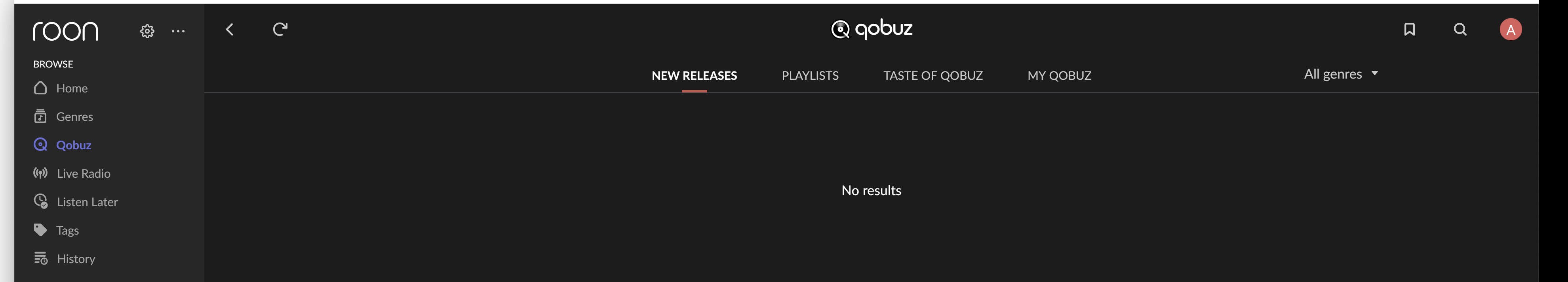

· Still running V2.64 server and remote on a Mac-Mini that is too old to update. Don't seem to be getting a connection to Qobuz; therefore no New Releases; Playlists, search results etc.
I've also have Roon on a MacBook;iMac and phone. running v2.67 as remotes. I am presuming that this is acceptable.
· Router is a provider issue; Provider is Plusnet. No switches or extenders or VPN; Server is installed on a MacMini within a couple of yards of the router. Can connect to Qobuz directly. Haven't had any problems previously.
