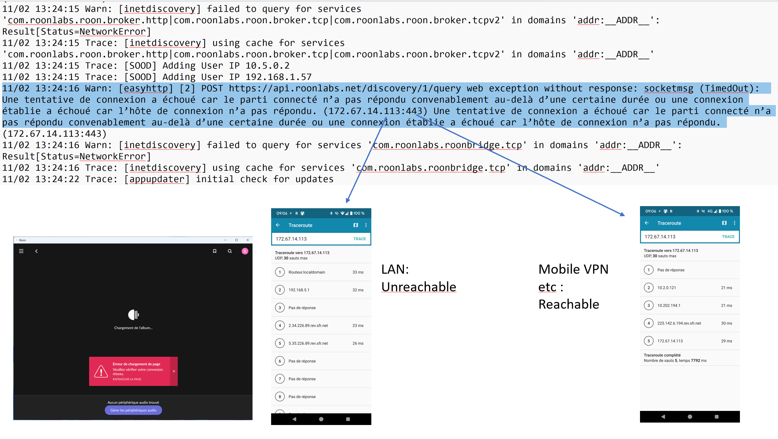

If I look at the log file of roon it says unable to connect to 172.67.14.113 socket timeout. the result is that I’m not able to perform any search on the Radio or Qobuz ( album will not be displayed and will not be accessible of course ) and I will end up with a message that says : check you internet connection or " please refresh your page"
If my Roon server is plugged to a VPN I’m not getting the 172.67.14.113 socket timeout error message and all my searches on Qobuz are accomplished in less than a second.
If my Roon server is plugged to my mobile on a LTE or 5G network I’m not getting the 172.67.14.113 socket timeout error message and all my searches on Qobuz are accomplished in less than a second.
If I perform a traceroute to this adress from my LAN ( including a traceroute from the modem itself that does not require a device on the LAN and that does not have any firewall enabled) I can see that the packets are being routed to my ISP network and stopp responding when they are about to reach the cloudfare servers.

I have been through this article before , the strange thing is that I can ping with no issues at all the servers that belongs to cloudfare and that are close to this IP’s range ( for instance 172.67.14.112 / 172.67.14.114 / 172.67.14.111 etc ) only 172.67.14.113 reject the connection ( and the ping from my landline ip ) and unfortnuatelly it is the server than Roon keeps trying to join.

11/05 09:58:02 Warn: [easyhttp] [2] POST https://api.roonlabs.net/discovery/1/query web exception without response: socketmsg (TimedOut): Une tentative de connexion a échoué car le parti connecté n’a pas répondu convenablement au-delà d’une certaine durée ou une connexion établie a échoué car l’hôte de connexion n’a pas répondu. (172.67.14.113:443)
11/05 09:58:02 Warn: [inetdiscovery] failed to query for services ‘com.roonlabs.roonbridge.tcp’ in domains ‘addr:ADDR’: Result[Status=NetworkError]
11/05 09:58:02 Trace: [inetdiscovery] using cache for services ‘com.roonlabs.roonbridge.tcp’ in domains ‘addr:ADDR
