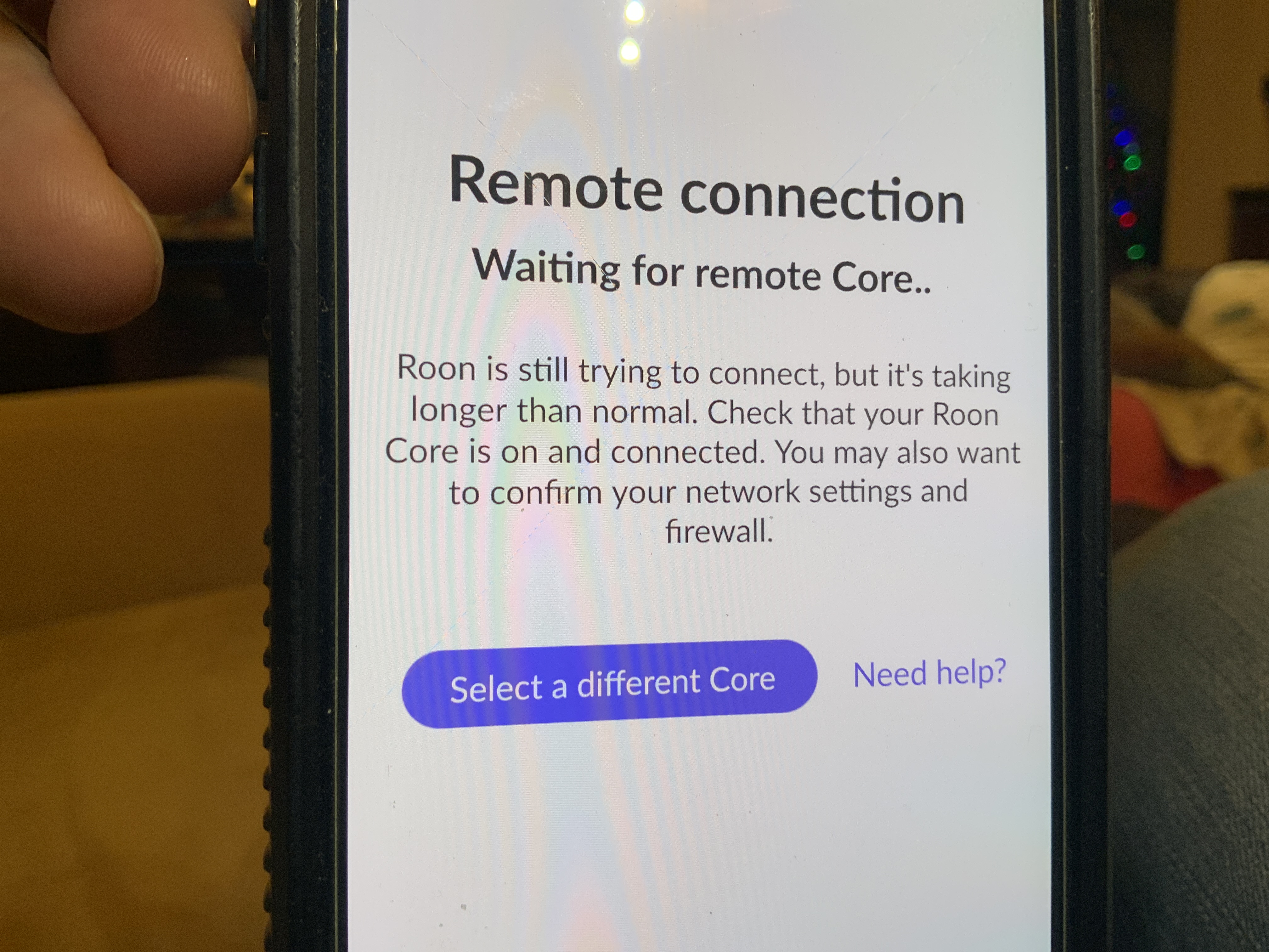

Connection issues with Roon causing pauses and disconnects (ref#YQLBSH)
Roon has trouble connecting. When connected pauses,freezes and kicks out.
Router and wifi
More information is needed to help the user community and the support team help you.
What device is the Roon Server running on, Nucleus - NUC - Desktop - Laptop etc?
How is the Roon Server connected to the Network? Ethernet or Wi-Fi?
If Wi-Fi then connect with Ethernet to see if that helps.
