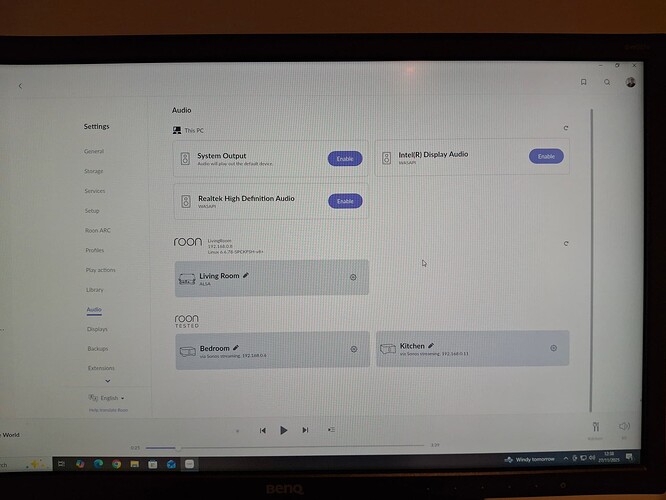

In the UK, I have changed broadband provider from EE to Sky. My new router is model SR203sUK. I have a simple set up of 1x raspberry pie endpoint and 2x (10-15 year old) Sonos boxes, all hard wired.
When I first connected the new Sky router, all endpoints were showing as white in the audio section of settings and I could control all zones from the main pc (which is acting as the roon core) using the mouse but I could not see the server from any device connected via wifi (phone, tablet) however these devices could access the Internet ok so they are clearly connected to wifi ok.
I have tried to fix the issue using Chat GPT and have changed Windows firewall settings on the roon apps (that are available to me) to make them both public and private. Now all endpoints are showing as greyed out. Roon cannot control any zone.
The sonos zones work ok when controlled via the sonos app on my phone.
I have tried restarting the roon core and the sonos boxes a few times without success. I have not tried restarting the raspberry pie endpoint.
Please can somebody help me reaccess these three audio zones and enable my phone and tablet to see the roon server? Thank you.

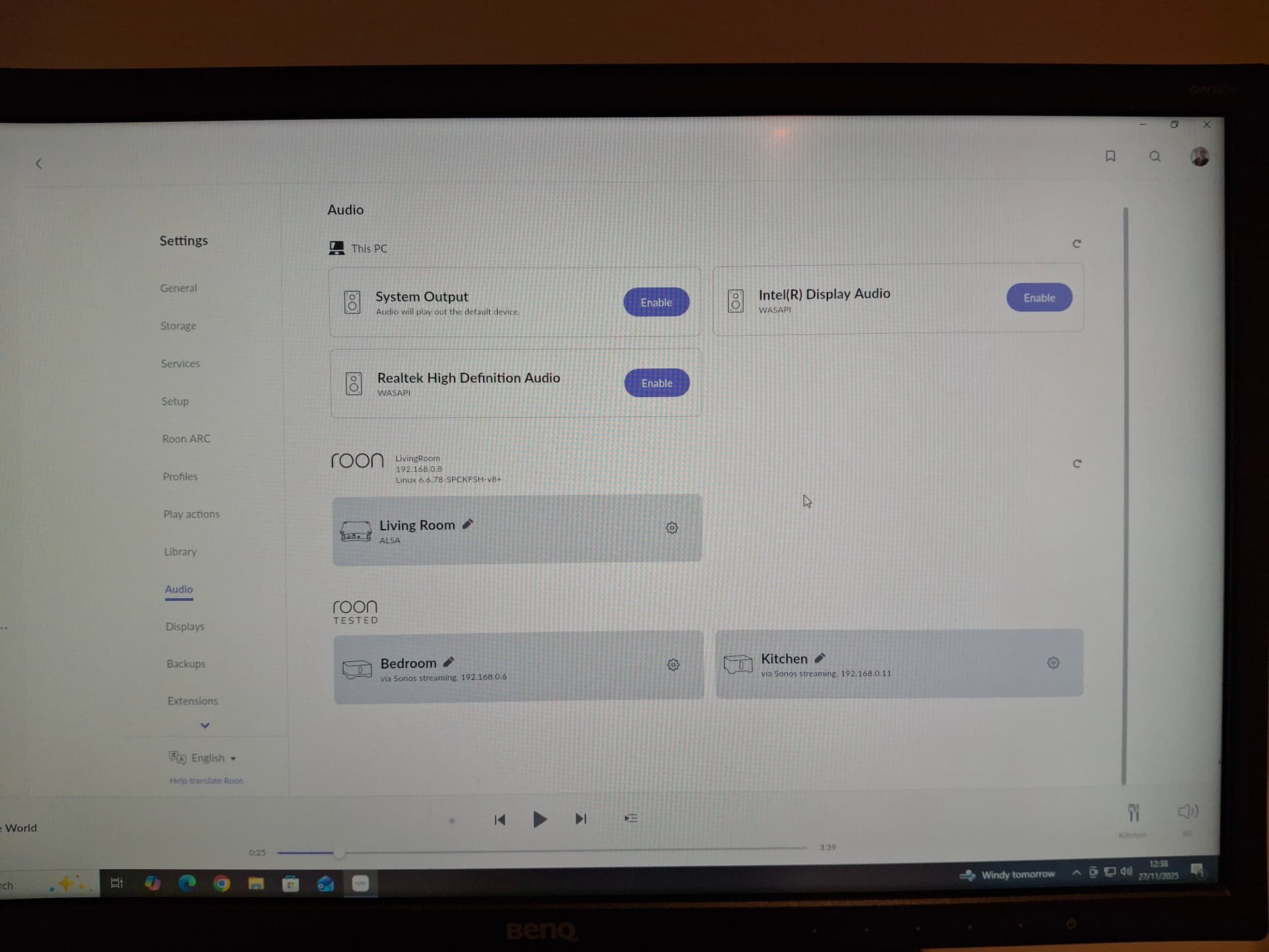

I have actually got a lot of success following @mjw’s suggestions. Everything worked fine after that. I can see roon on my phone and can operate all endpoints from it and the main pc via mouse. I notice that all endpoints are still showing as greyed out in the Audio section.

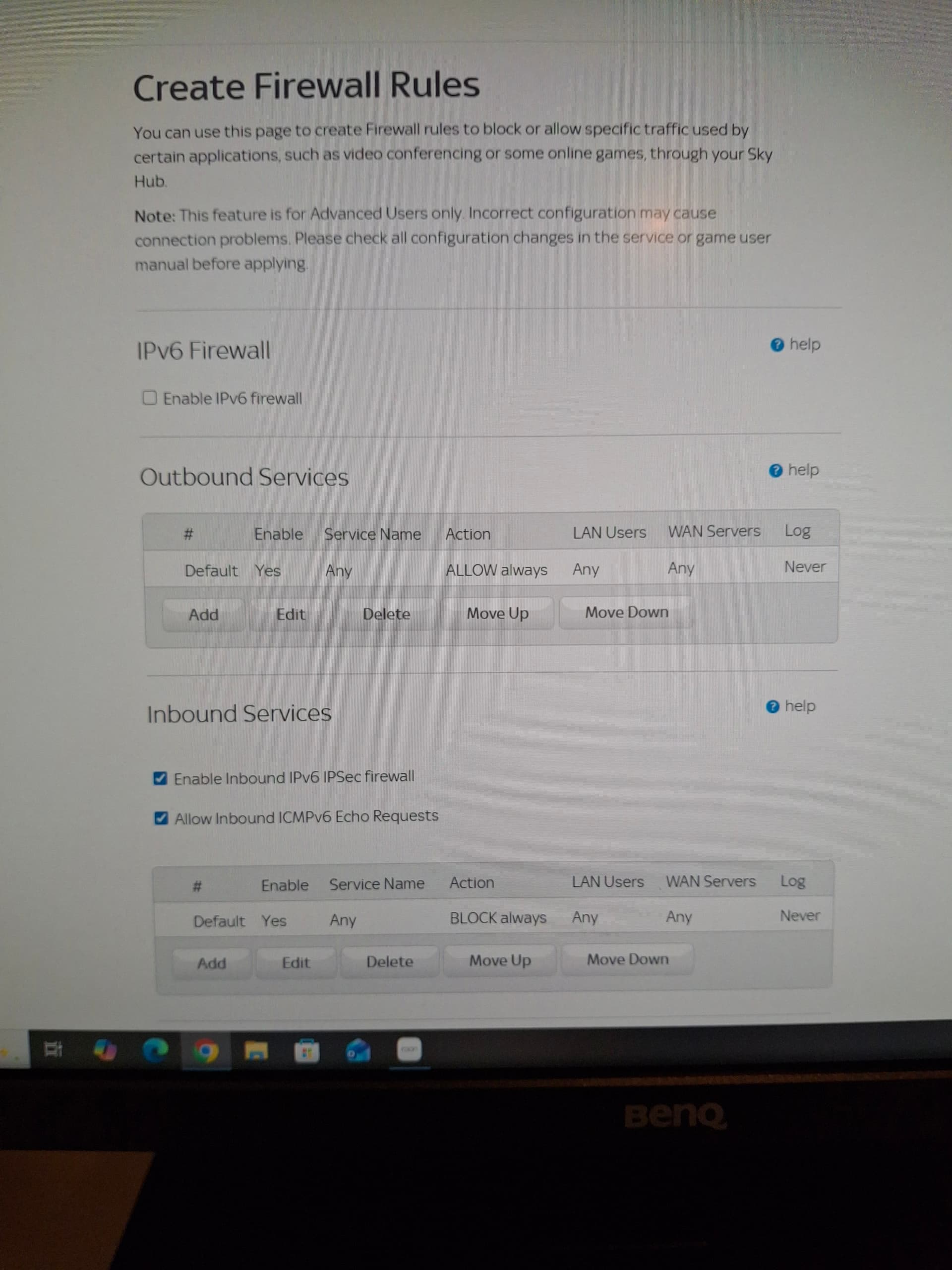

I have made one further adjustment to the router and switched off IPv6 (see attached image). This doesn’t appear to make any difference. Everything works but all endpoints still show as greyed out. I cannot find any button to make any of the other changes you suggested.
Would it be best to turn IPv6 back on?
Actually, I think UPnP can be switched off. Should I switch off?
I’m not concerned about the greyed out status unless you tell me I should be!
Christian
Those endpoints aren’t greyed out. Grey means they’re enabled. Aren’t you able to select them as normal?
And best practice says UPnP should be disabled in the router unless you need on-demand inbound port forwarding.
Ah, ok. Thanks @Giles_W. My memory clearly doesn’t serve me well! I’ll disable UPnP. All is working fine. Thanks to all :folded_hands:
