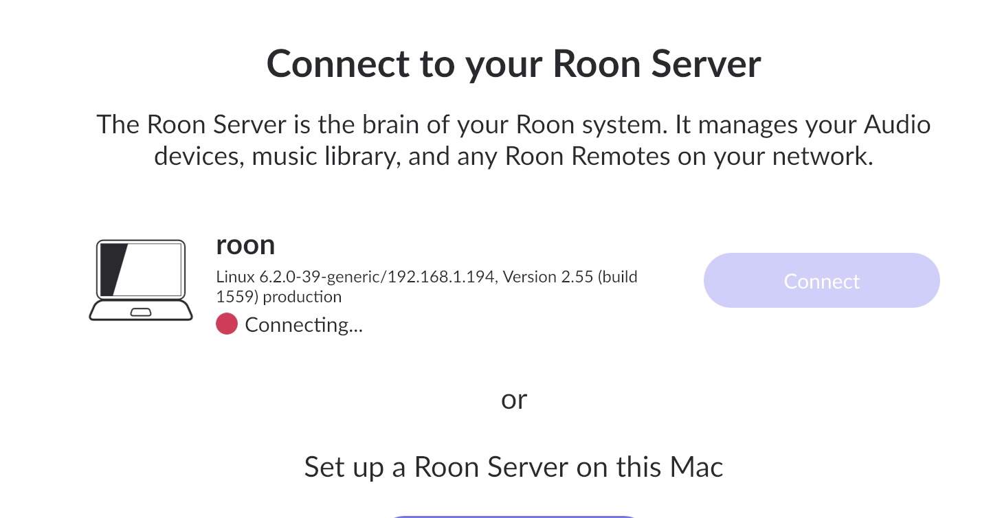

Only since upgrading to build 1559 I have connectivity problems. Roon endpoints disappear, macos client loses connection to server (shows only with red dot symbol). Sometimes even the macos roon application crashes. Restarting both server and client helps - that however is not a solution.
I have tried disabling other services running on the same server, tried disabling ipv6 entirely, no change! I would like to downgrade both server and client to the former, working version. How can I do that?
roon server is running on linux on a mac mini (intel), connected via ethernet. Macbook Air and Raspberry roon bridge is connected via mesh wlan (amplify hd). no issues in the past year until this upgrade to 1559

Good day @Roger_Miliker !
From the diagnostics logs we were able to spot that the connection is being established between your remote (Mac) and Roon Core, however, when data transfer starts it is not able to be completed and the process terminates.
This might mean that the issue is either with the network or Roon Core is unable to complete the data transmission due to some internal reasons.
We have also spotted that your Roon Server has quite an old CPU which is on the verge of matching the hardware requirements.
Thus, we would like to ask you to disable all non-Roon processes on your server and connect to the Roon Server with only 1 remote and try to play the music without real time Signal Processing on the Core’s side.
Let us know please whether this way it is going to bring more stability.
