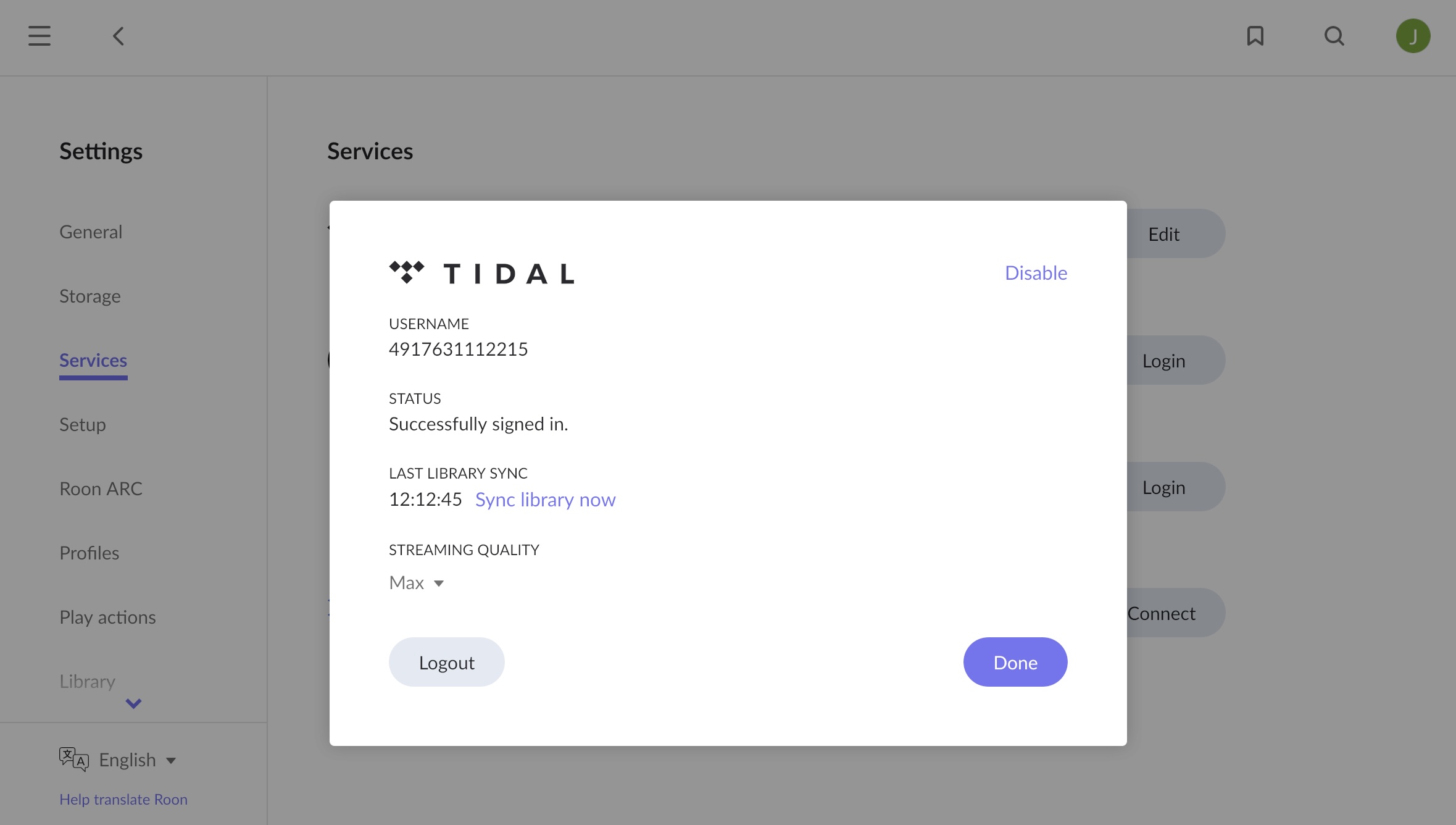

With that, can you please share a screenshot of your Roon Settings>Services>Tidal>Edit pop up? Have you recently logged out and resynced your Tidal account with Roon? Please do so.

Hi Benjamin,
I have logged out of Tidal and logged back in. Requested screenshot is here:
Also I have created a new RAATServer folder as instructed.
Both of these actions did not lead to a remedy, the problem persists.
