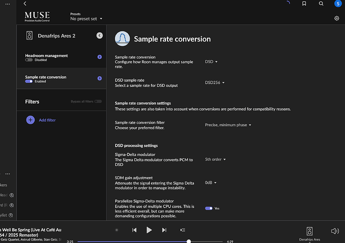

I’ve had good success upsampling PCM to DSD using the Muse settings. Thats what i want to be to do in the future…

This is what I use…. I like the way it sounds.

To give you a direct answer regarding your server choice: If your goal is high-rate DSD upsampling (DSD256 or DSD512) using Roon’s Muse (DSP), the Nucleus One will likely not be powerful enough for your needs.
Upsampling PCM (from Qobuz) to DSD is one of the most CPU-intensive tasks you can ask a Roon Server to perform. It requires significant “single-core” processing power to calculate those delta-sigma modulations in real-time.
  • Nucleus One: While it is fantastic for library management and light DSP (like EQ), it will struggle or “stutter” when trying to upsample to DSD256, and DSD512 is likely out of the reach of its processor.
  • Nucleus+ (Used): It has much more “horsepower” and can typically handle DSD256 comfortably. DSD512 is possible but can still be hit-or-miss depending on which filters you choose in Muse.
