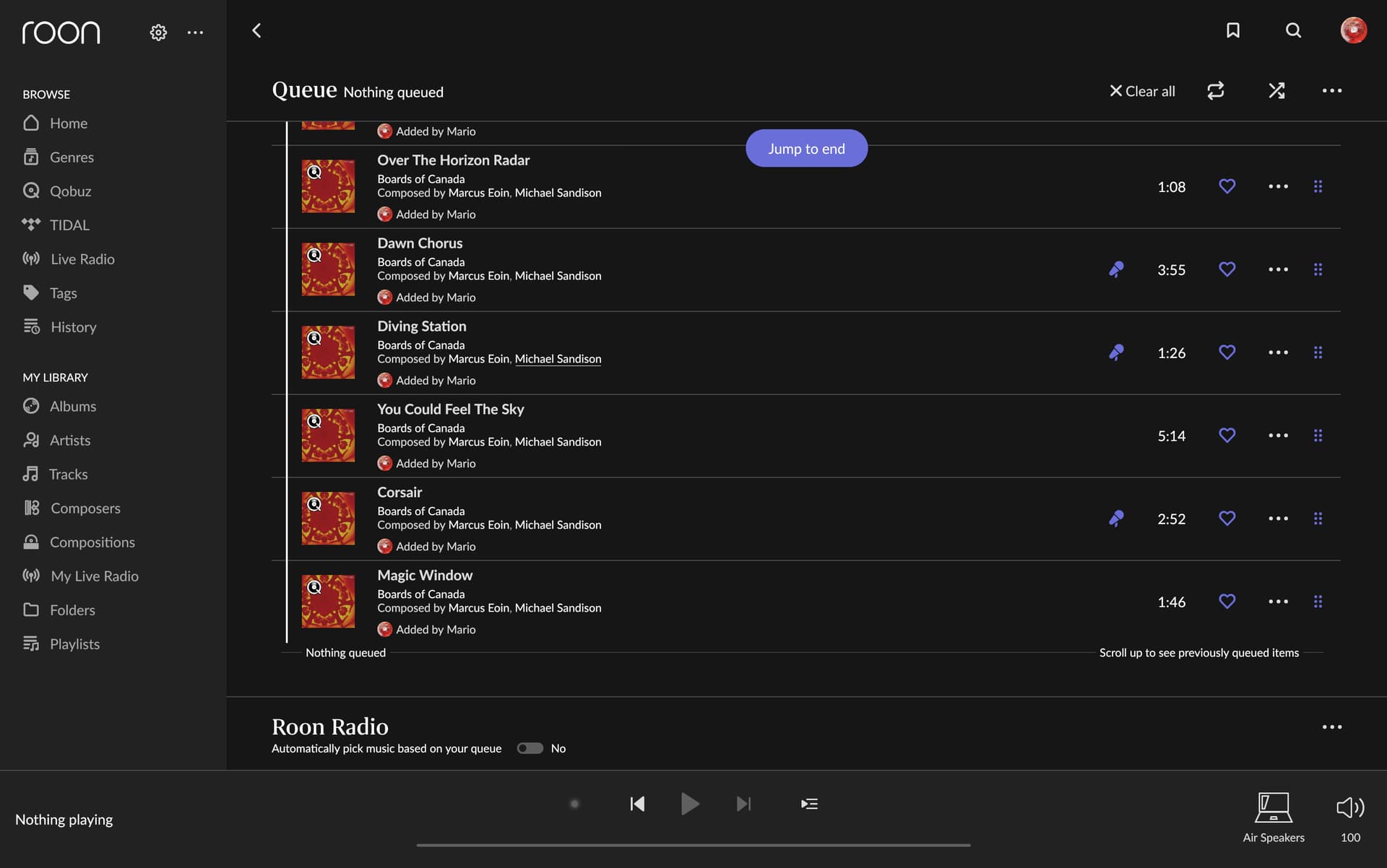

  5. Check macOS local Air Speakers queue: different old stuff from this queue is back!

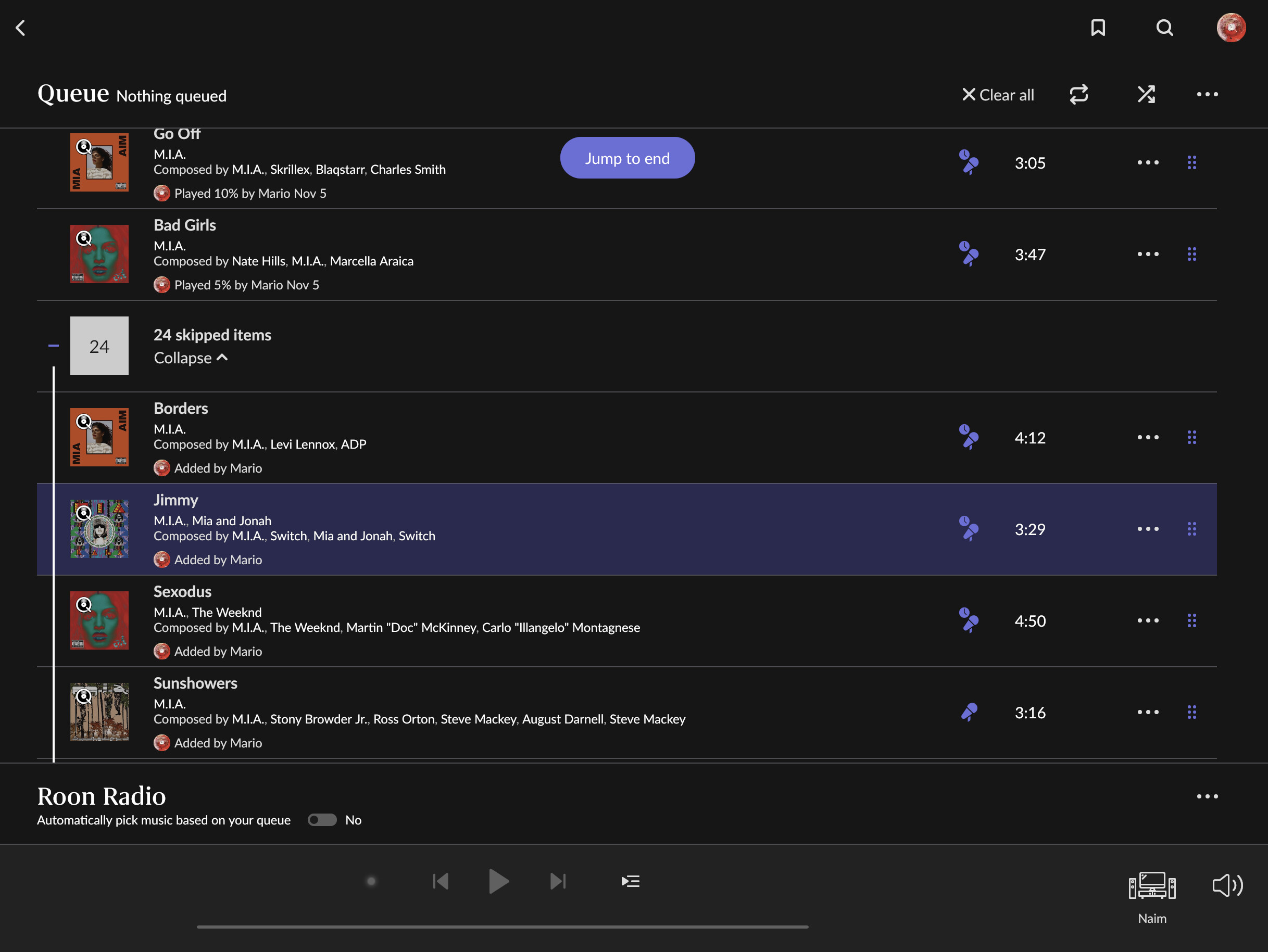

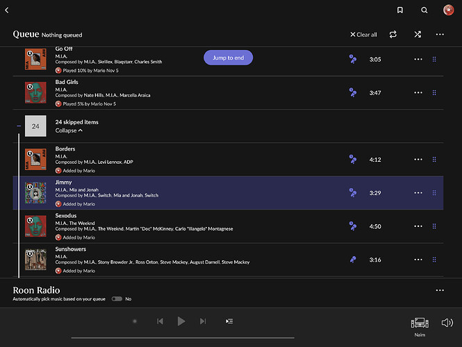

  6. Check the remote Naim and Shower queues in the macOS app. the old stuff from these queues is back as well!
    Naim queue with expanded items:

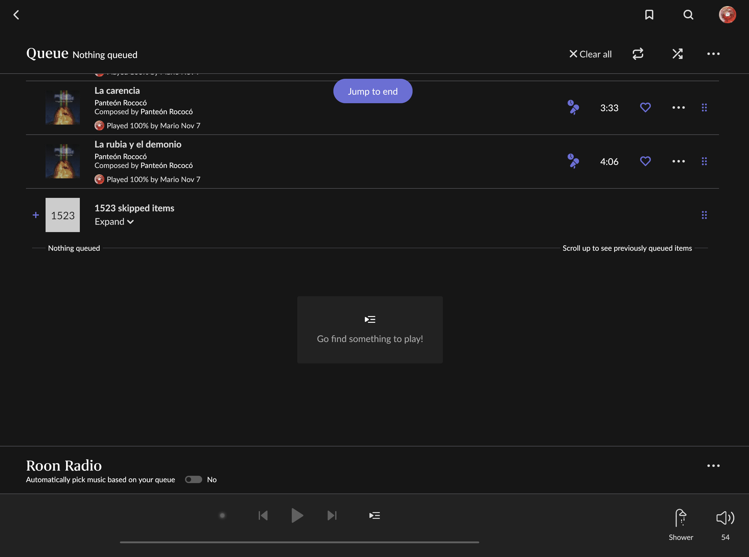

    Shower queue is super long again, first screenshot with collapsed items:
    After expanding, looks similar/same as in older screenshots above, with lots of old content.

I’m having the same issues. This is in the production version from the update from yesterday. For me it triggers whenever grouped zone goes on or off. Momentarily Roon goes blank when an endpoint that is grouped goes on or off, saying “Go find something to play” and then when the Queue comes back it is not the same. Includes random stuff from above the current played item.
