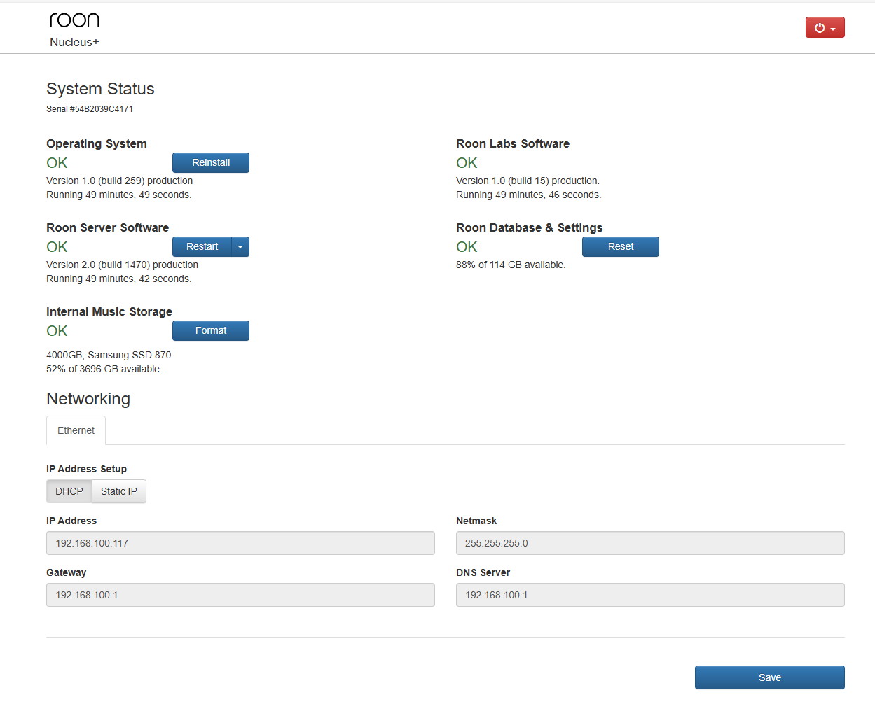

Can you post a screenshot of your Nucleus’ web administration interface please?
Based on other threads, you’re likely running out of memory or storage space. A screenshot may help detecting a storage issue. In any case, official support may have to take a look at your Roon Server’s logs and you have to wait until your ticket reaches the top of their queue to get a response (on a work day).
Here we go
