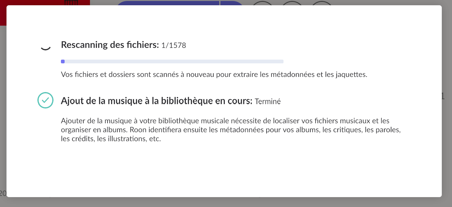

Continuous rescanning issue on NUC with ROCK after library import (ref#L12LOA)
· Since ROON is not running anymore on my QNAP NAS (without changing everything...), I build a NUC with ROCK as my new server. All is great BUT when importing the Library, ROON is turning continuously to rescanning files even if import is completed and library is ok. The main issue is my NAS is never stopping resulting on high temperature...

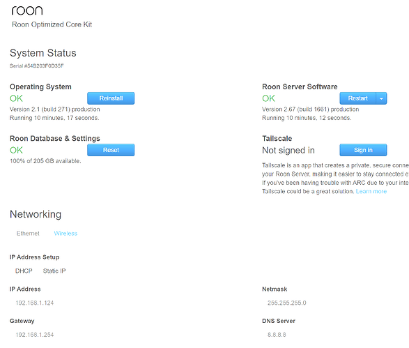

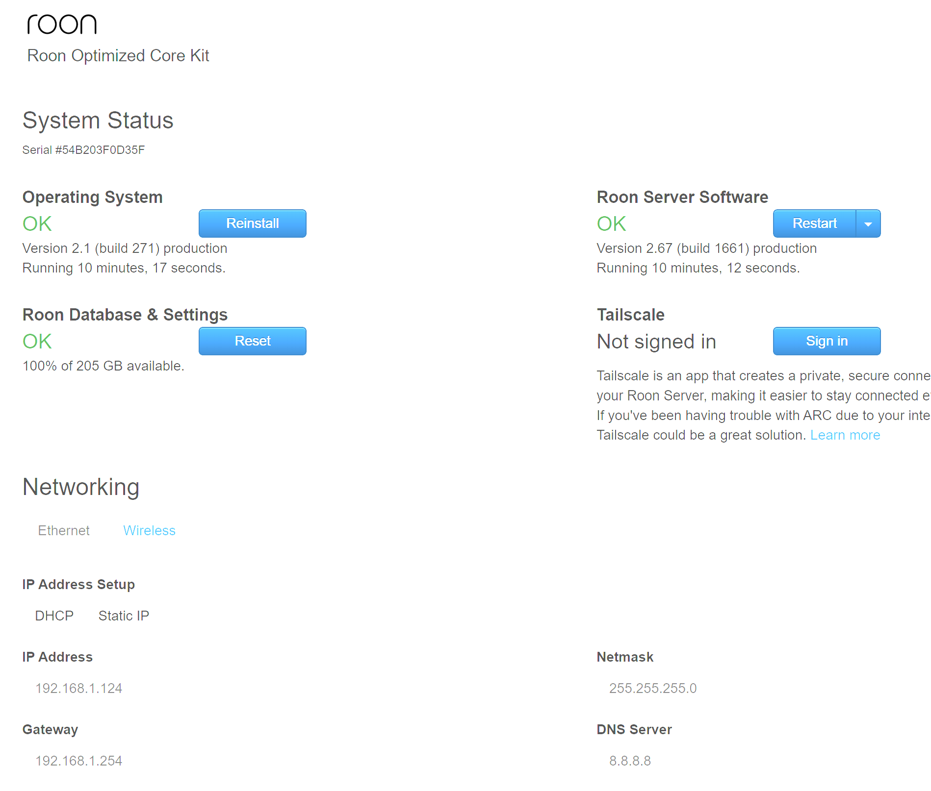

First, the good news on the hardware: your NUC itself is healthy. It has 32 GB of RAM (so this isn’t a memory issue), the CPU was sitting around 30 °C at boot with no thermal throttling, and the internal boot SSD is fine. The heat you were seeing really was just the NAS being kept busy, not the server struggling.
The key finding is that what looks like “continuous rescanning” is actually Roon Server being restarted on a roughly 15–25 minute cycle. Each time it restarts, it re-mounts storage and re-runs library identification from scratch, which is the rescanning you see and what keeps any connected drive active. So the restart is the cause, and the rescan is the symptom.
