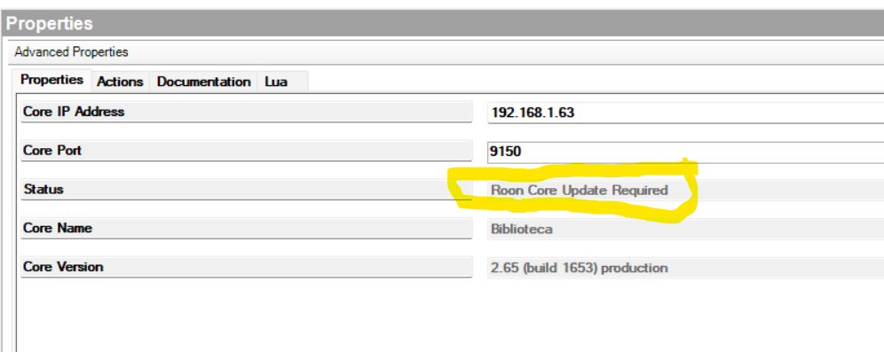

· Control4 integration with latest v2.65(build 1653) production running in QNAP container station.
Status in Control4 Composer now reads Roon Core Update Required.
Control4 can see the Roon instance but cannot communicate with it to see the zones. How do we get the Control4 driver updated on GitHub to make this work going forward?
· Qnap TS-1685 running 2.65(build 1653 production) in Container Station.

Thanks for the details, and for including the screenshot. Please try removing the Control4 driver from your Roon Extensions, then re-adding it.
That should be the next step here. Let us know what you see after that, and we can take it from there.
2.65 (build 1652) production.
