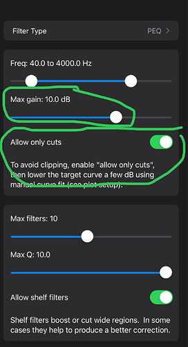

This is not about that. You are not yet at the stage of Roon using the convolution filter. You are just configuring the correction values that HC should use.
You can configure HC to automatically fill a maximum trough of, say, -5dB and not more. Or alternatively you can tell HC to allow only cuts so that all corrections are reductions of volume.
This is in the HC manual on Equalize Setup - HouseCurve
