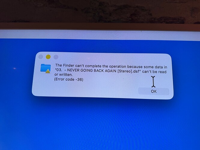

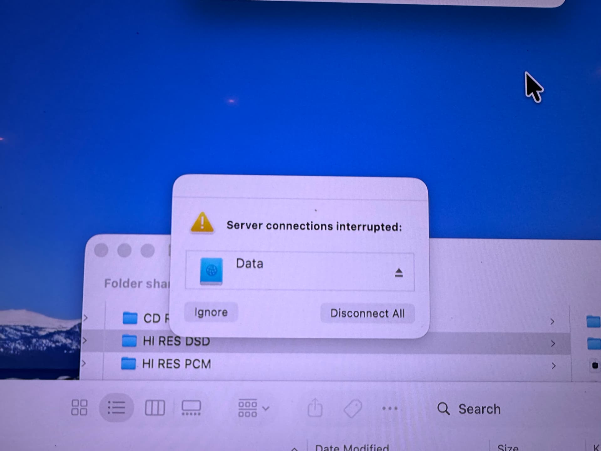

Anyway, the problems persist even with the server halted. The network connection does not seem to be consistent and disconnect at times which crashes the copy process. When I do the same from Mac to Mac with the same drives it works without fault and a lot faster as well.
I will attach the error message screen shots.
In short: over my network I can copy the same data from the same source drive Mac to Mac and Mac to DMP-A10 but not to the nucleus. It feels like you have a networking bug in your OS.
