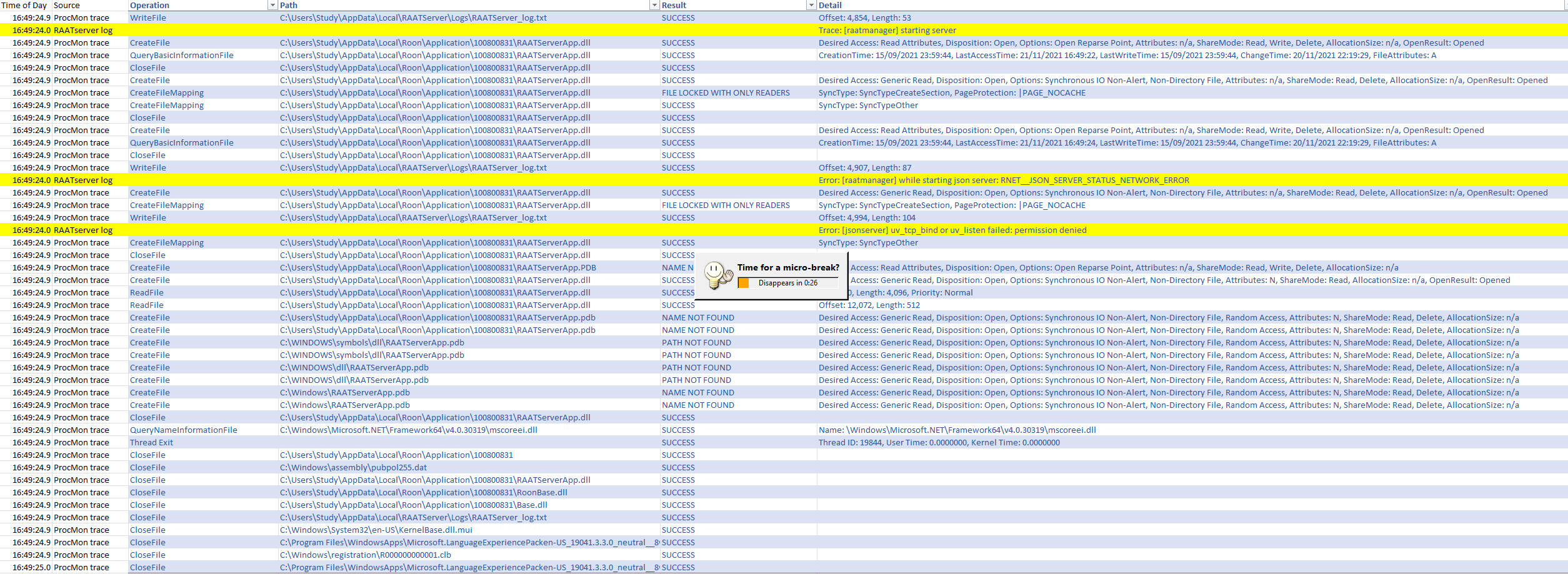

I pulled together synchronised RAATserver log and procmon logs with the raatserver log highlighted.
Nothing there seems to explain why the JSON server is throwing an error other than the RAATServerApp.PDB file not being created…
IF someone with some expertise can advice what to look at next I would appreciate it…
regards
Rod

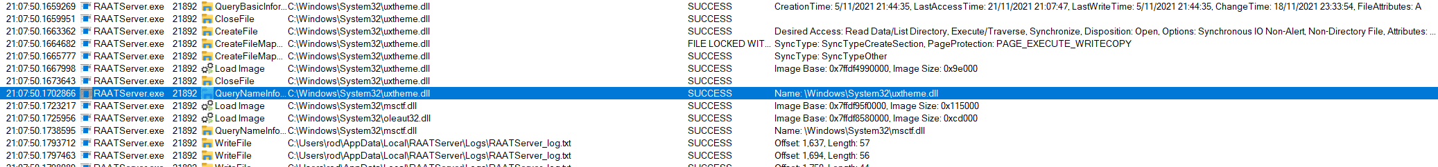

Drilling down into a comparison of Process Monitor data I find this machine - which is stuck at “initializing” is taking some different steps that fail relative to my laptop where it works
This sequence is where the RAATserver is preparing to load the server.
Now compare with the working laptop

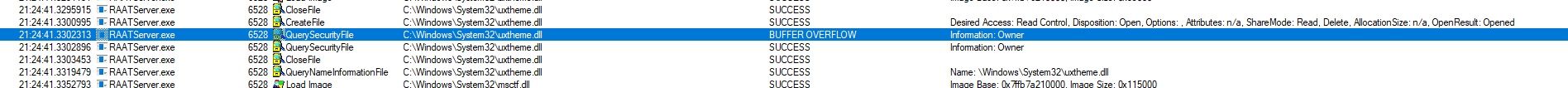

This desktop does a “Query Security File” which results in a buffer overflow. This instruction does not execute on the laptop at all - and the laptop works.
This may be a complete red herring as both the dll’s have the same permission structure on both machines. But strange. Ultimately the query I think shows appropriate ownership.
In general where it works on the laptop there are not “QuerySecurityFile” operations, rather they are “QueryAllInformation”. THe former result in buffer overflows on first call the latter no errors.
