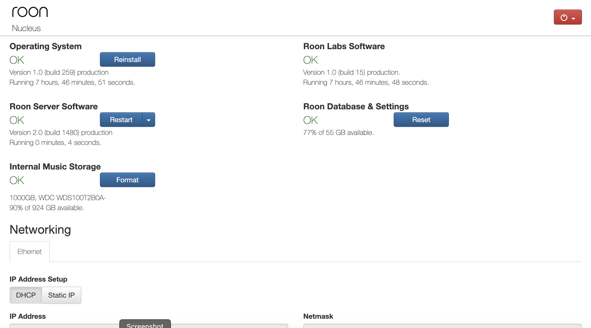

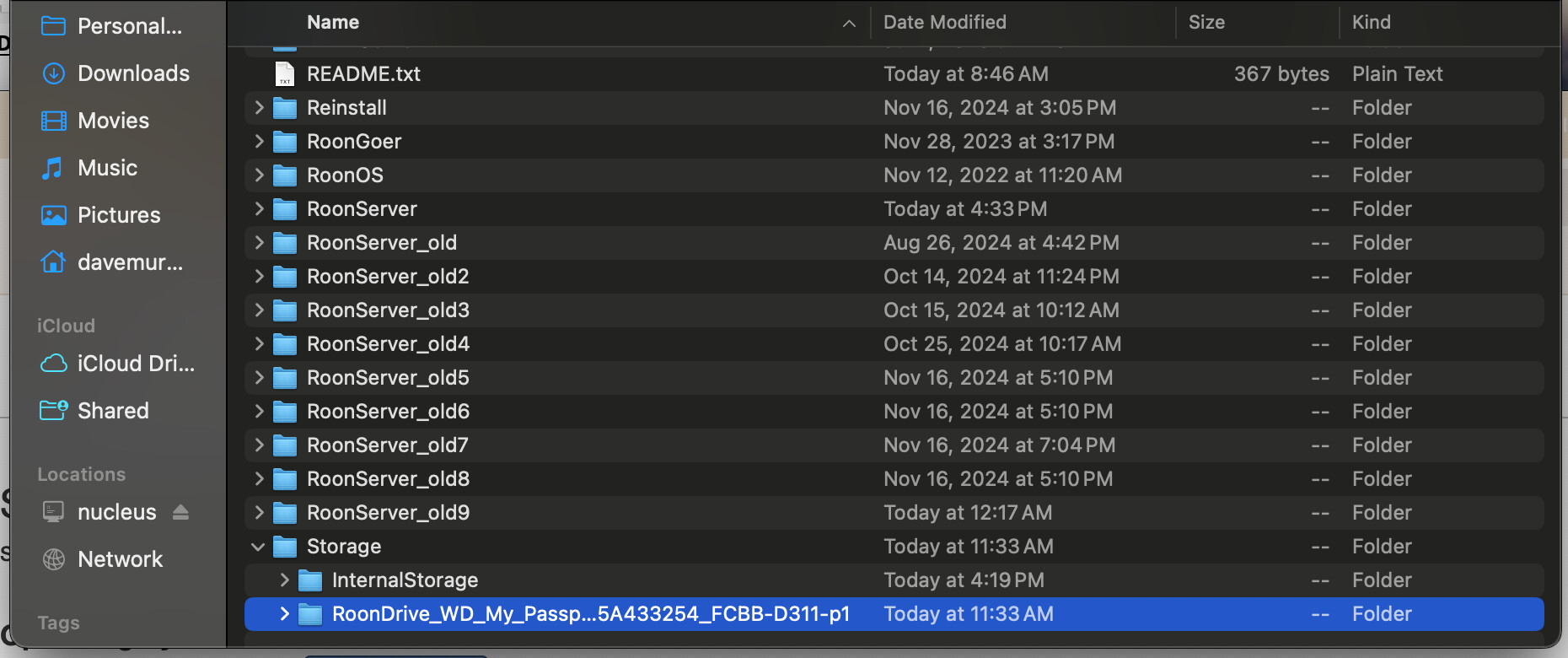

I do have one other question. I loaded the files onto the Nucleus from a USB Hard Drive that I plugged directly into the Nucleus. I used my MacBook to copy the files onto the Internal Storage Folder. The Hard Drive showed up in my Finder as a folder so it is not giving me an option to eject it. How can I remove the hard drive from the Nucleus without just unplugging it?
I looked in some of the forums and somewhere someone said that I could eject it using the browser interface with the Nucleus but I did not see the drive folder anywhere or any options to eject anything. Screenshots are attached.

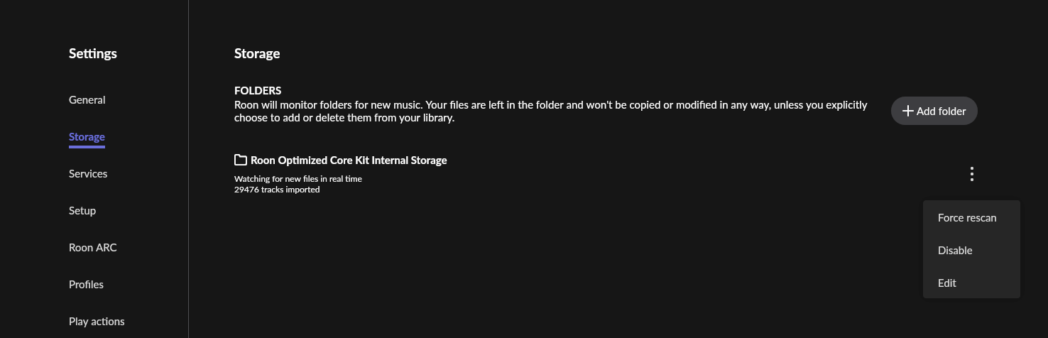

The setting is not in the Web Administration Interface, but in Roon’s :gear: > Storage screen. Choose “Disable” from the “3 dots” menu by the Internal Storage entry.
This is not an “Eject the drive” operation per se - that is not a function contained in Roon OS, so it may still show up in the Mac’s Finder.
Edit: just tested it on my ROCK system - disabling the Watched Folder does not “eject the drive”. It can still be seen and browsed in Windows File Explorer (and presumably in a Mac’s Finder).

Thanks for the suggestion @Geoff_Coupe
I ended up just turning off the Nucleus and unplugging the drive while it was turned off. I wanted to “eject” it because I was concerned about corrupting any files on the drive by removing it while the Nucleus was trying to access it. I have had enough challenges with corrupted files that I am trying to be really safe with them now.
