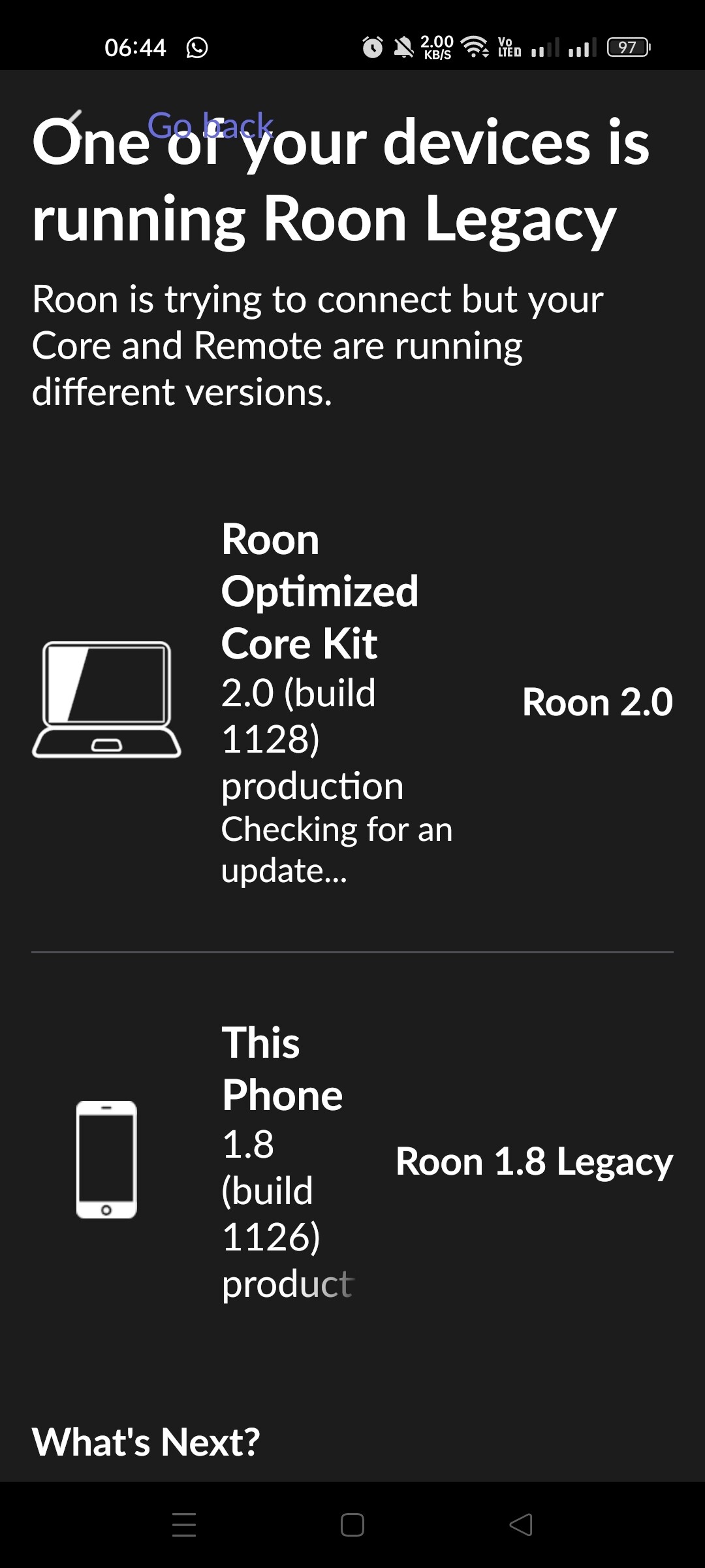

Trying to connect the remote to the core gave me a cycle of two screens without the ability to connect or login:
Then I tried what I have successfully did yesterday with my NUC8, I copied roon file to branches, stopped server, and click Reinstall, but still I get Roon 2.0 b1128.
This is with an empty database. Should I login to it first? But my Remote would not let me connect as the following screens show.
