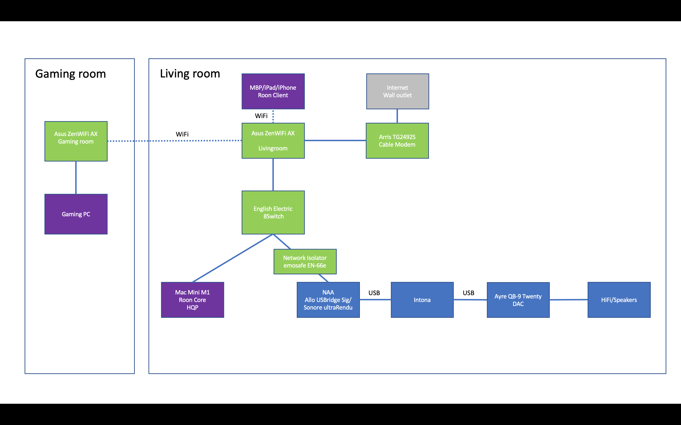

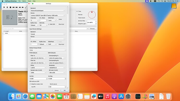

Here is are my settings and simplified picture of my set-up and connections
I’m not an experienced user, first I would try to USB connect DAC to M1 mini Roon Core. If there are cracks and pops I would turn all the settings upside down until all fine. Then start adding one by one all the devices. But with shut down and proper power on sequence when I add a device. Hope you’ll find the problem.
Change max volume to -3dBFS (minus)
At the moment it is 0
Its hard to see from your screenshot if youve been experiencing intersample overs (limiting)
But the CM3+ won’t be the limiting factor here, unless it is somehow faulty
0 dBFS volume setting will produce inter-sample overs and limiting. So unless the source has particularly low recording level, -3 dBFS is maximum volume to use. This is why the volume control also first turns yellow and then red when you go above. If there is limiting even at lower volume setting (possible), then the knob will turn red and Limited counter increments.

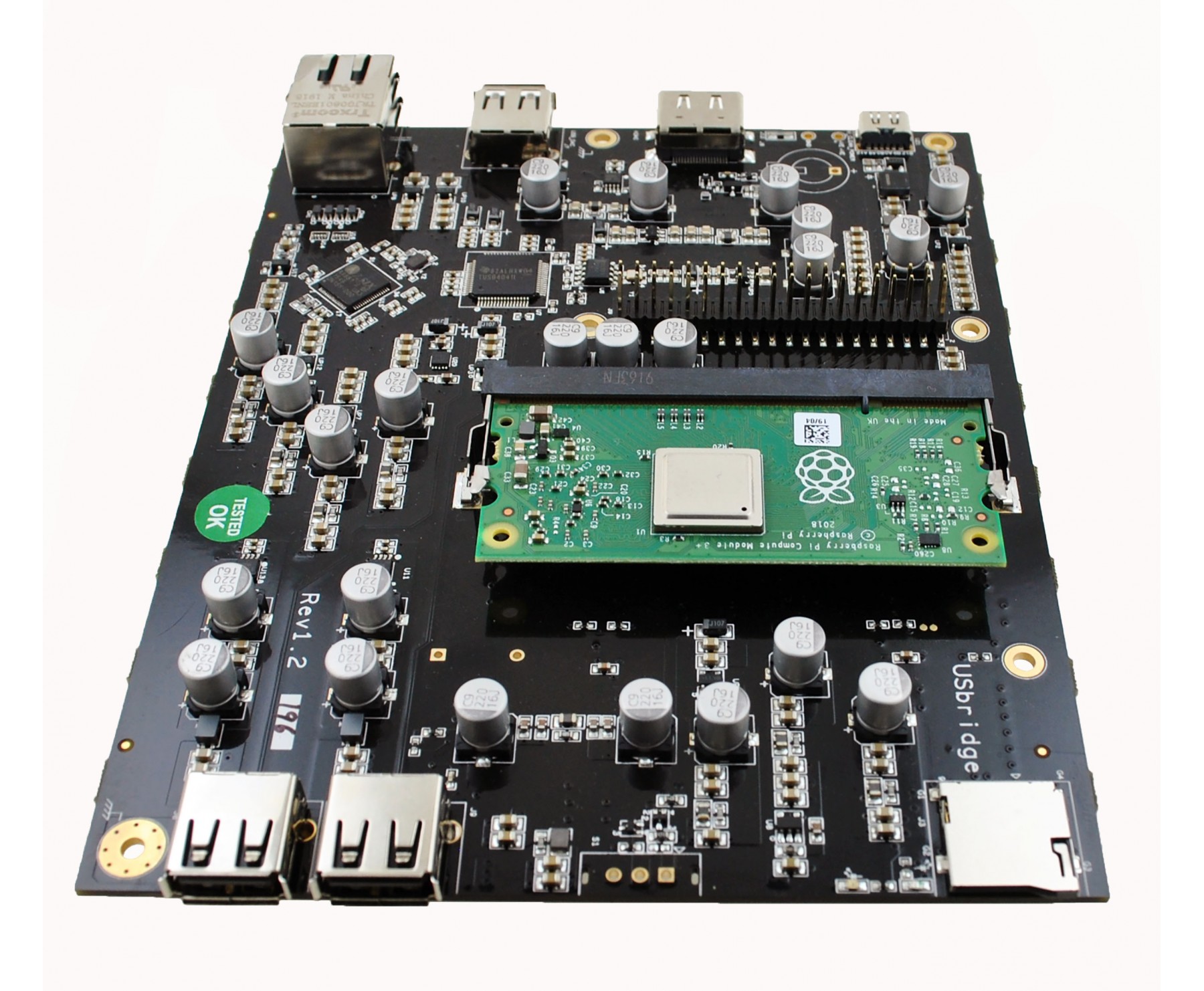

@Marko_Kanala Allo USBridge Signature is still using a shared CM3+ USB2 BUS for both Ethernet and USB.
Unlike Pi3+, USBridge Signature use a separated ASIX Ethernet to USB chipset. However, this Ethernet to USB chipset (theoritically could support USB3) connects back to the Pi CM3+ USB2 BUS via a TI USB HUB chipset on board.

The bottleneck of the Allo USBridge Signature might not be the shared USB2 BUS but the CM3+ processor / RAM power.

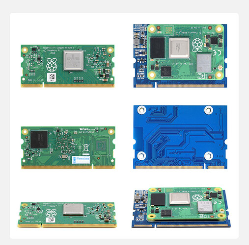

Replaced the CM3+ module in the USBridge Signature by a CM4 via a CM4 to CM3 adapter, I could run DSD512 smoothly with both GentooPlayer64 and the latest Jussi’s Pi4 NAA image.
The TI USB2 HUB in this case still connects to the CM4 USB2 BUS.

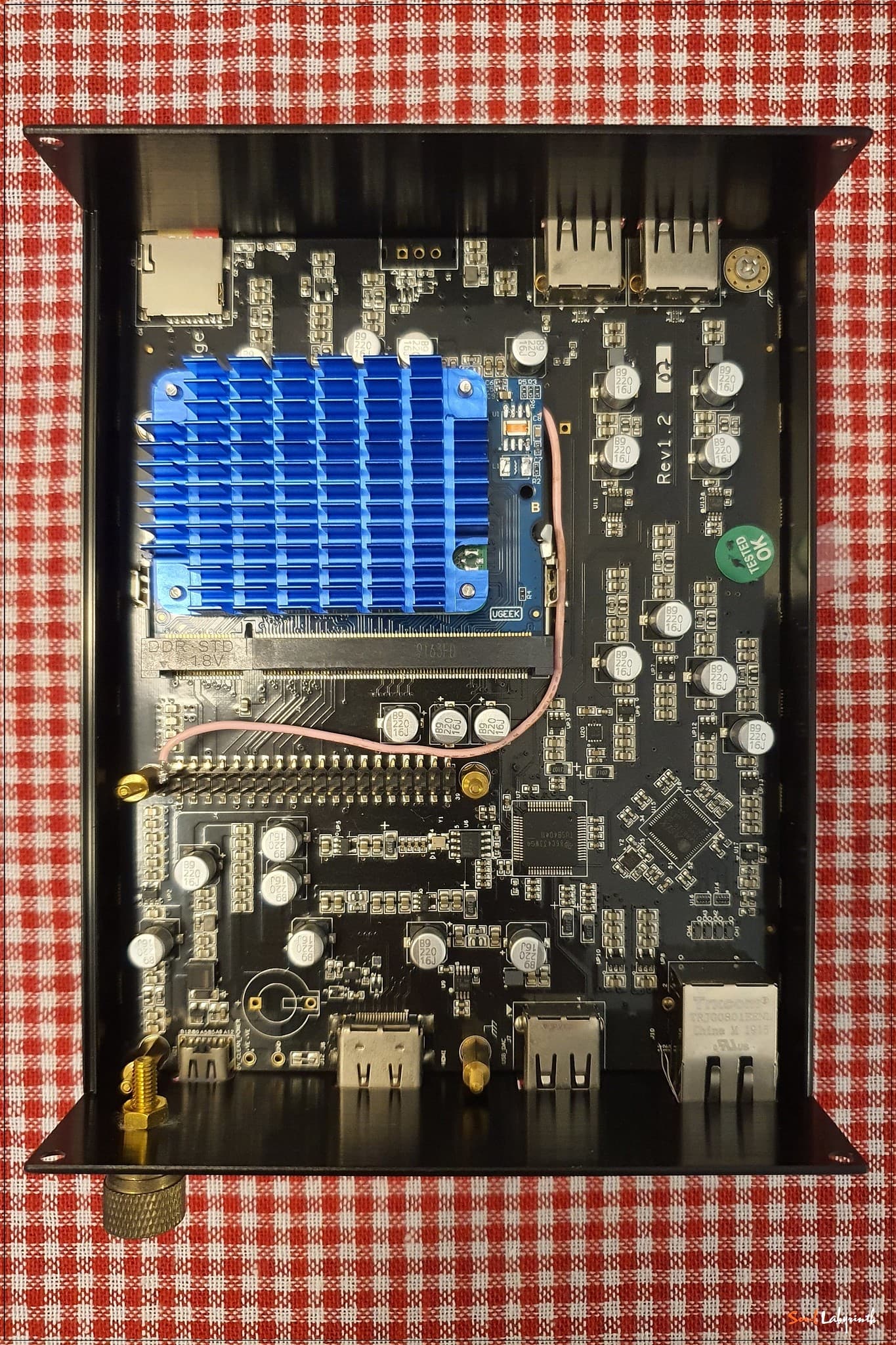

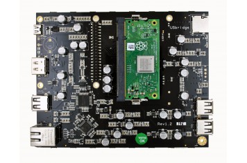

That sounds interesting! Just curious, how do you fit the CM4 to CM3 adapter with CM4 to Allo’s board, isn’t it quite a lot bigger? At least based on pictures I would assume it is hitting those capacitors, or are they lower that it seems in the picture?
usbridge-signature-pcb

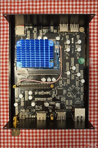

The CM4 to CM3 board did cover some capacitors indeed. However, there is no components at the back of this board. We can use some kind of thin electrical tape between them for more safety.
Below is how my one looks like
Ok, great! Definitely something I might try someday
