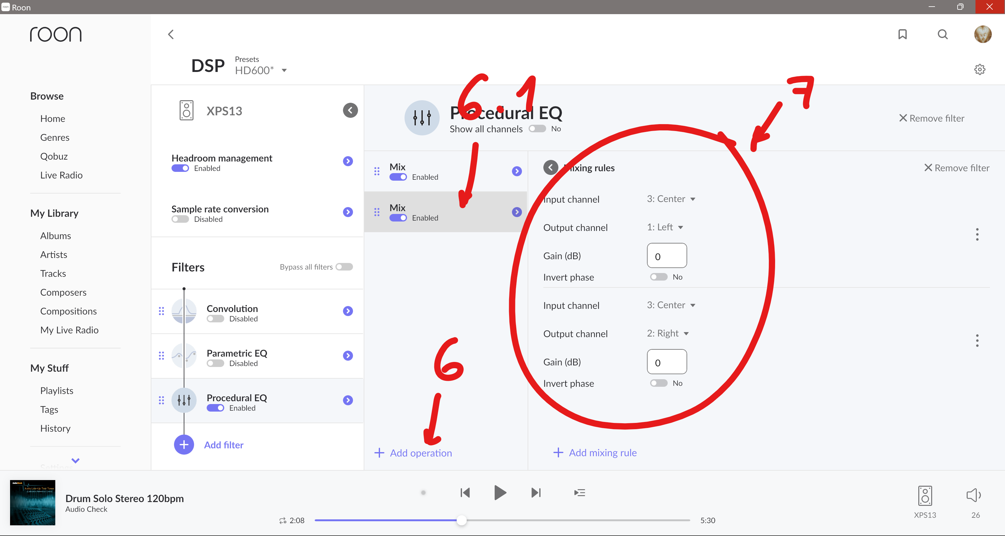

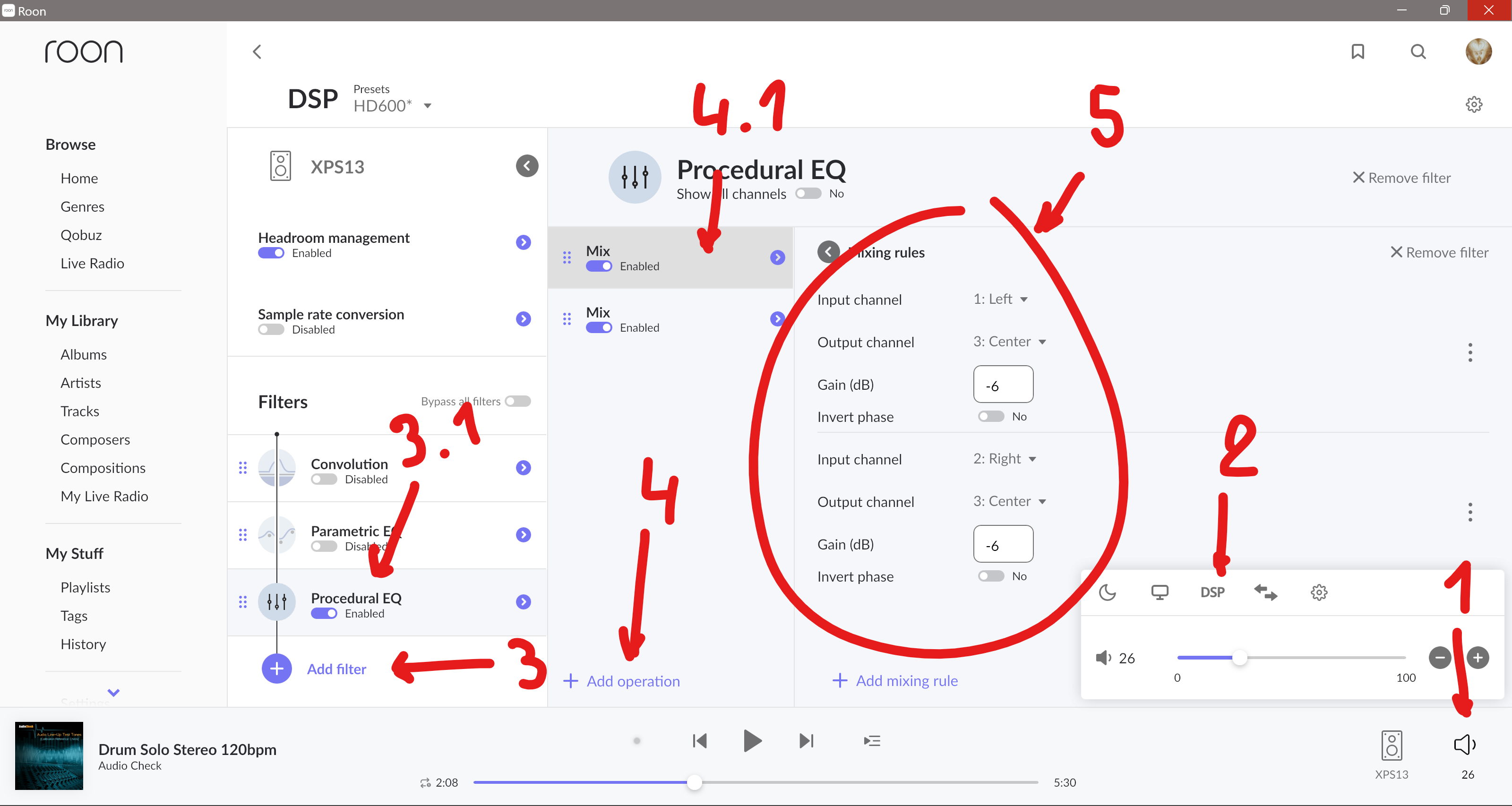

A couple of pictures tell more than a thousand words …
Et voilá - Stereo to MONO without clipping
I tried to do Left/ right to center and center to left/ right in the SAME mix panel. It requires two mixers, as you point out.
Works fine.
Much appreciated!
