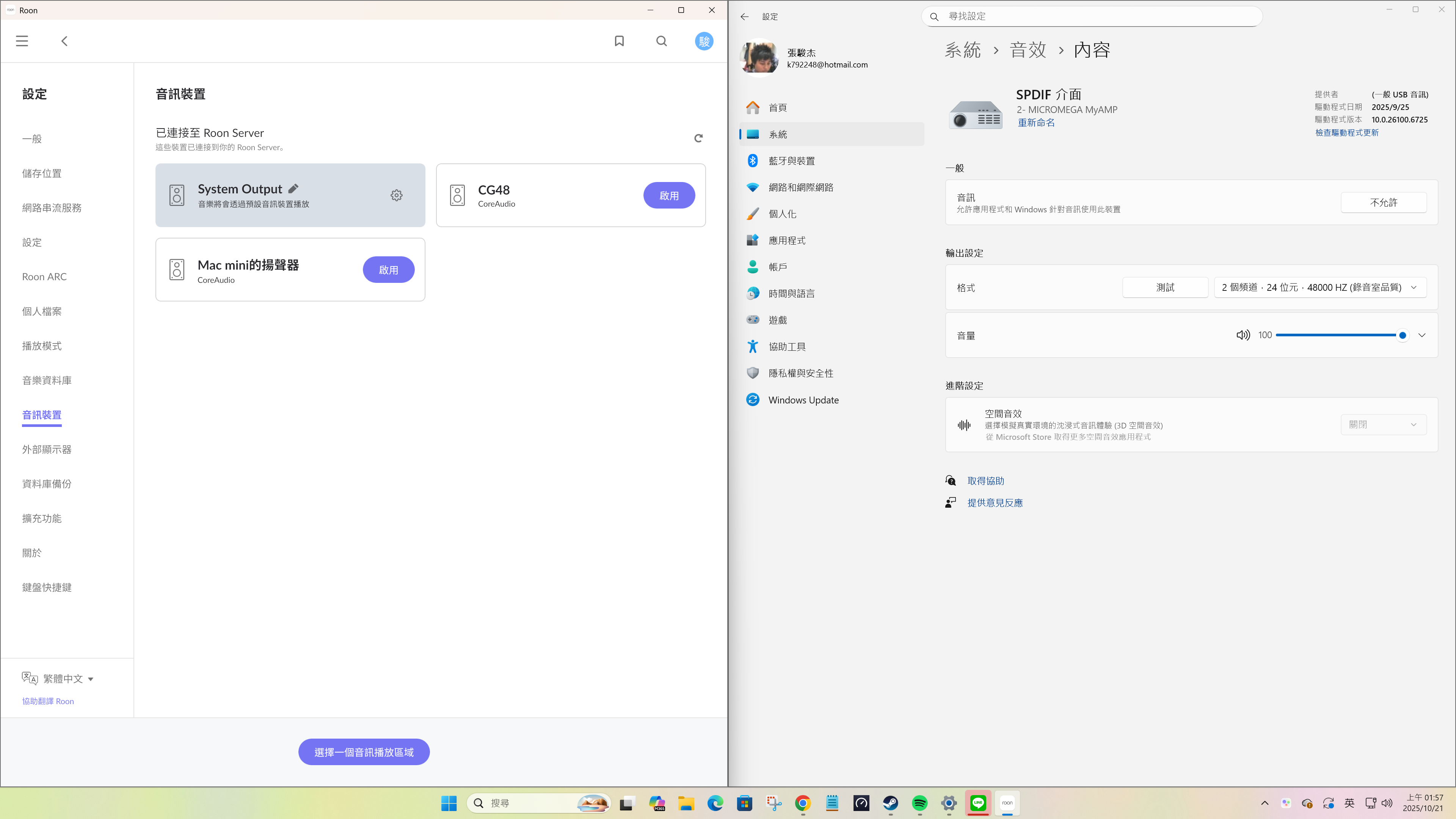

· 在ROON 還沒更新找的到DAC 更新ROON軟體找不到DAC ROON安裝在MAC 在W11打開ROON找不到DAC 電腦有抓到驅動可以撥放聲音的
找不到電腦中的DAC
(Translated)
Can’t find the DAC in the computer
I can’t find the DAC in Roon even though it hasn’t been updated. I can’t find the DAC after updating the Roon software. I installed Roon on a Mac and can’t find the DAC when I open Roon in Windows 11. My computer has the driver and can play sound.
Hello @k792248 ,
Thanks for reaching out. Just to confirm, this DAC is plugged in via USB to the PC, or is it using the SPDIF output from your PC’s hardware? If it is using the direct SPDIF connection, you should be able to select your “System Output” zone to play to it. What is interesting is that your PC zones are not at all seen, and just a Mac zone is. In this case, I suspect you have an issue with your PC’s firewall blocking Roon from seeing zones.
Since you are using a Windows PC, I would verify that both Roon.exe and RAATServer.exe have been added as exceptions to your Windows firewall.
You can use these instructions to add the exceptions and the executables themselves would be located in your Database Location/Application folder path.
I would also add these exceptions to any Antivirus or other Firewall blocking applications you may have and ensure that you connected to your network via a Private network, not a Public one, see this guide for more information.
