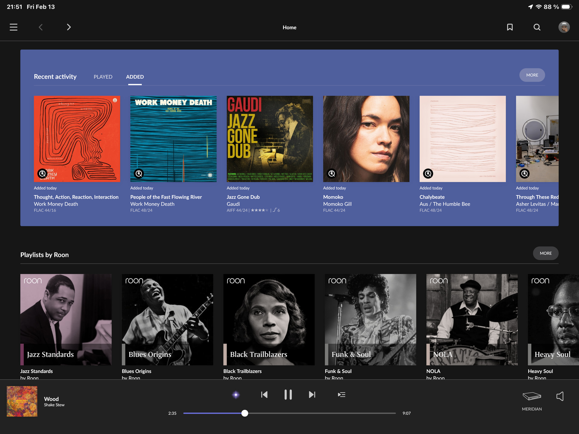

This is how my Home Screen looks like after the last update
It looks like it’s more than Daily Mixes. If I load an artist, I see Albums in my Library and Appearances in my Library. Then I get the same spinning logo for a minute, and then not much displays. I can’t say what’s missing, but it’s definitely not as much as before.
