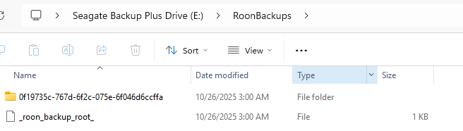

Clicking on Show > Hidden Items didn’t seem to reveal anything new. There is a folder called RoonBackups, which I expected as I have performed a few backups to this drive the past few days after discovering previous backups were gone.
However, looking in the RoonBackups folder I see this

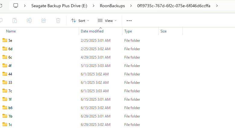

If I click on the first folder I see this (just a sample of the MANY files). I noticed that the “Date modified” dates go from the last backup performed yesterday, Oct 26, 2025, all the way back to early this year, well before the backups seem to disappear from the drive. Does this mean all my prior backups (I have Roon Scheduled Backup set to once a week, 26 max) are still there, but Roon just doesn’t see them using the Find Backups function?
Well shucks. Going to View - Clean/restore, the only backups that show are the same 5 that I performed the past couple days, after I discovered all were missing, that also show using Find Backups.:frowning:
