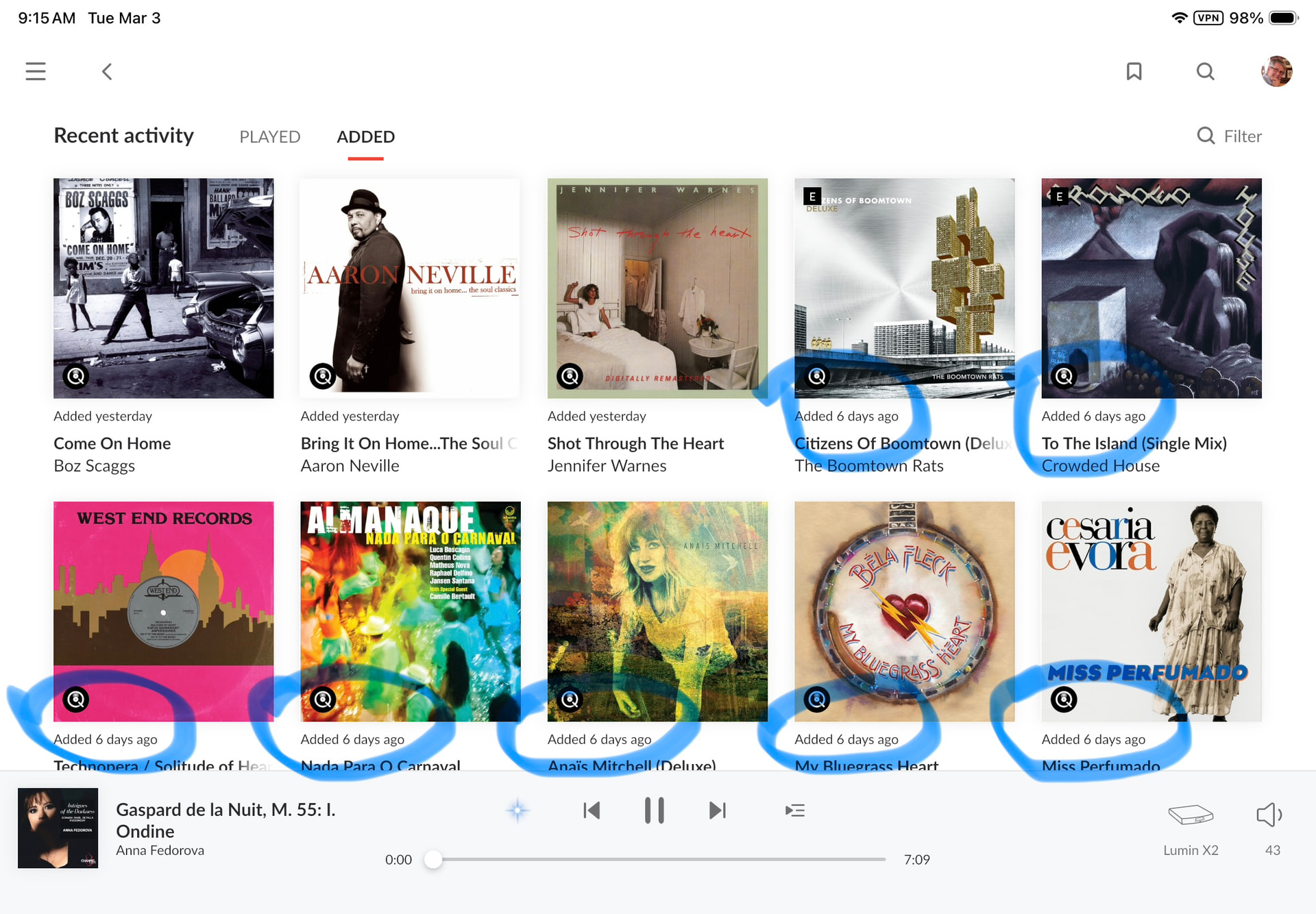

My system is acting normally now with no new Qobuz files to delete (my stored library was unaffected). As I have a rather large streaming collection, I have no idea what was deleted. Is there a way to determine this?
As you’ll see from the screenshot, the deletions happened six days ago.

I originally saw the ~4,000 track number when I went to library maintenance. That was the number to be cleared.
Benjamin, I navigated to “My Tracks” and applied the focus filter as you suggested. Out of my 111,346 tracks, 891 (Qobuz only) are unavailable. So I guess of the ~4,000 tracks that were cleaned up, that lesser number remains unavailable. I briefly checked the list and there were lots of tracks that I have not played in a long time. Any thoughts as to why the large number appeared suddenly?
