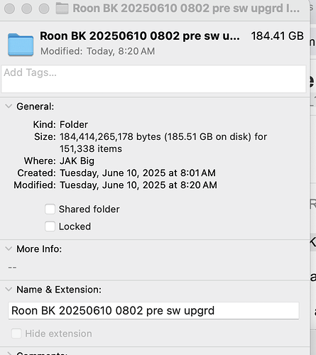

Thanks for reaching out to us about this issue. I see that your database is larger than expected but I’m unclear if Roon is not working in some way. Is the large database the only issue or is something else going on?

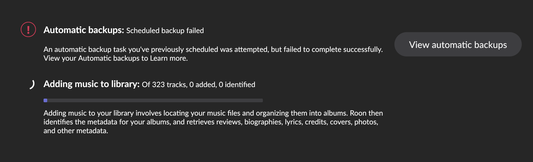

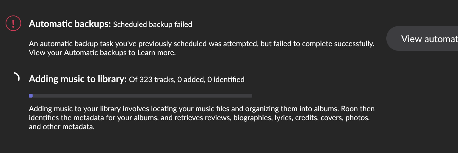

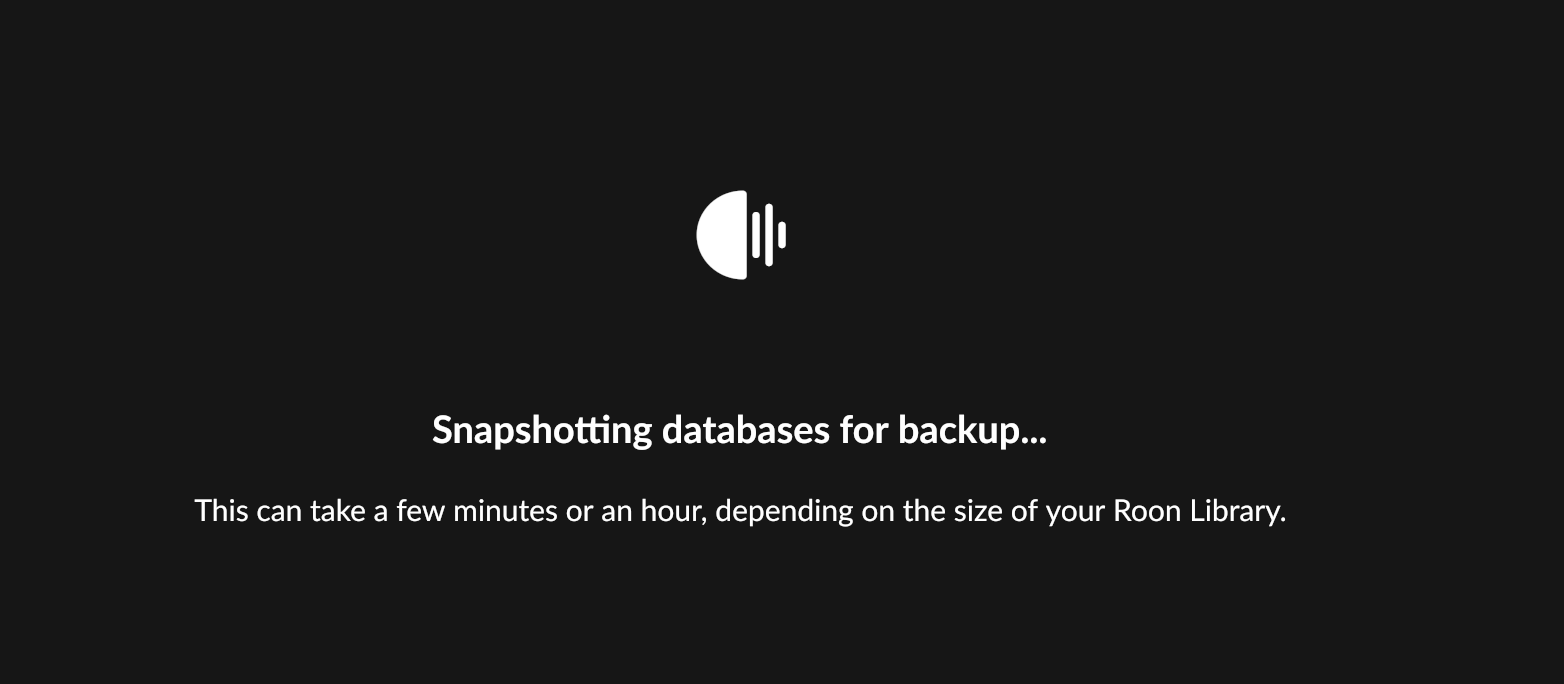

Roon will stop playing music sometimes when the rotating circle in the upper right is activated. This occurs after I add or move music files. The most recent example was after upgrading my Mac OS and Roon stopped for over 30 minutes.

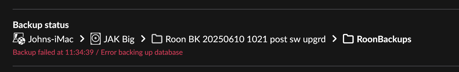

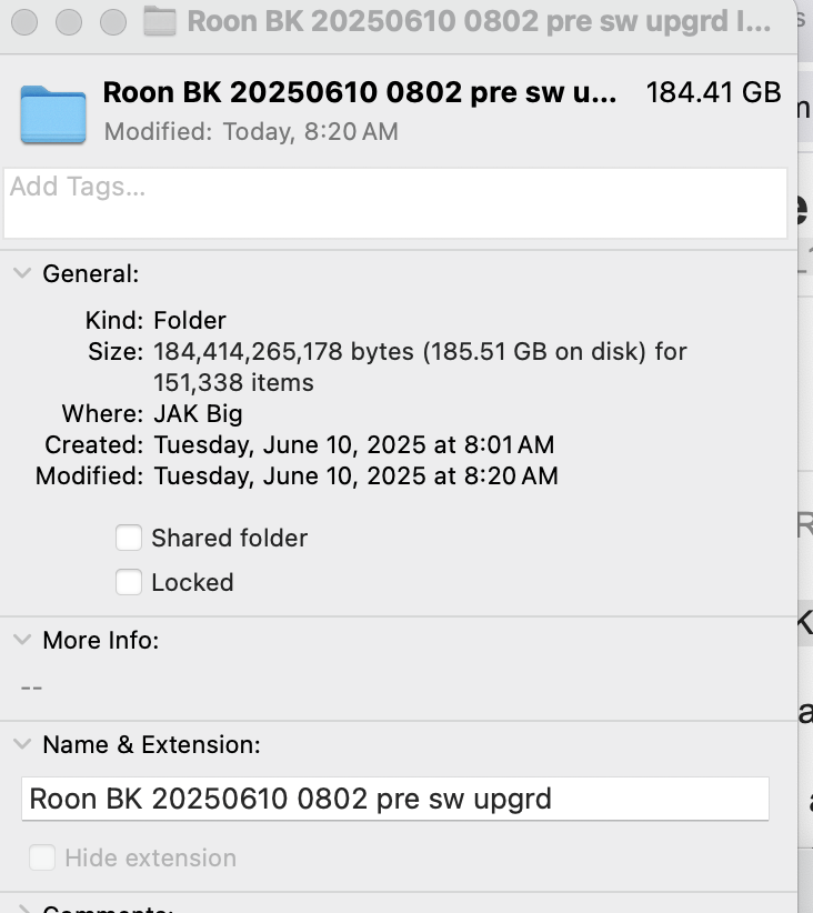

Also, the Roon Backups have been allocated 500 GB of disk space but Roon after 2 ‘saves’ now fails to back up and the 500 GB is full. I only ask Roon to save 2 copies. Its unreasonable to have to allocate so much disk space for Roon. I thought it was normal to have such large DB. But other users are stating that mine is extremely large for comperable library sizes. I have 160k tracks.

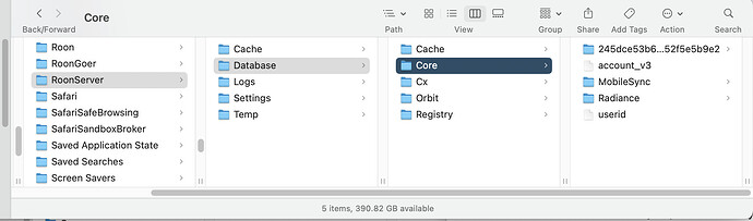

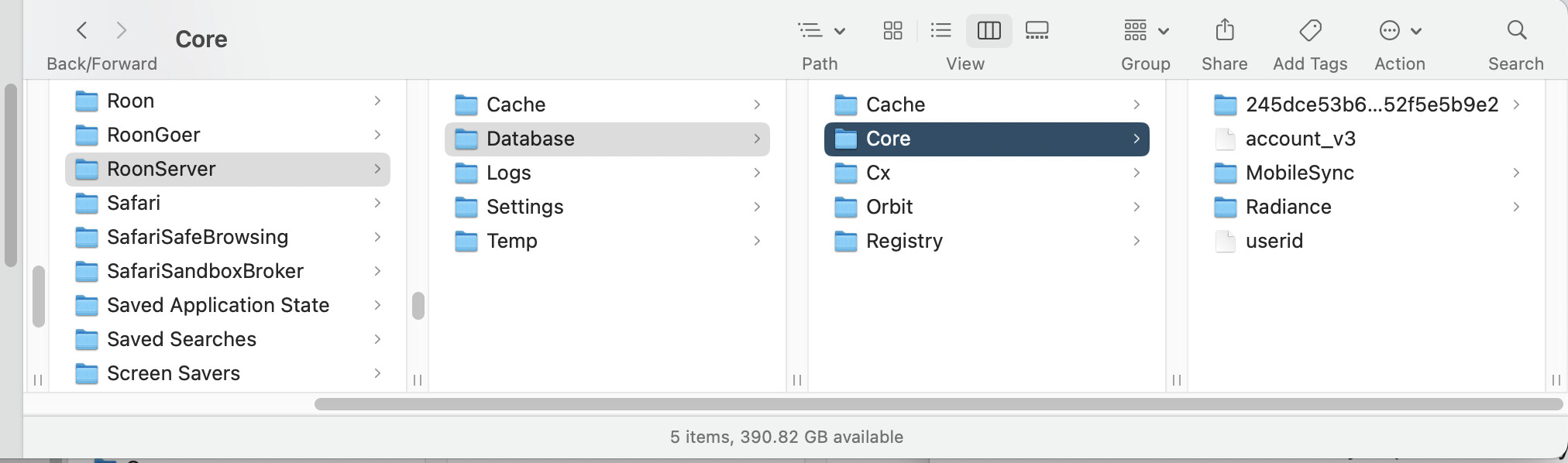

Could you please access your Roon Server database folder and share a screenshot of what you see?
To access your database folder (best to do this with all instances of Roon closed):
  1. Click ‘Go’ under Finder and hold the option key
  2. Click into ‘Library’
  3. Find your ‘Roon Server’ folder
Snap a screenshot of this, and then navigate to the subfolder ‘Database’ and snap a screenshot of this as well.
We’ll be on standby for your reply! Our team won’t be around over the weekend, but we’ll be back first thing Monday morning.

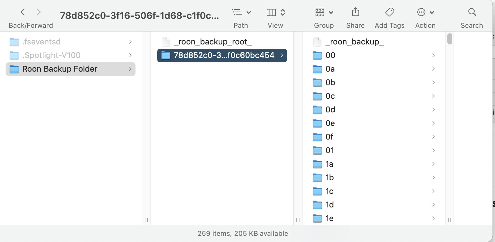

Backups are saved on their own partition on an external HD. The parti
on is 500GB.

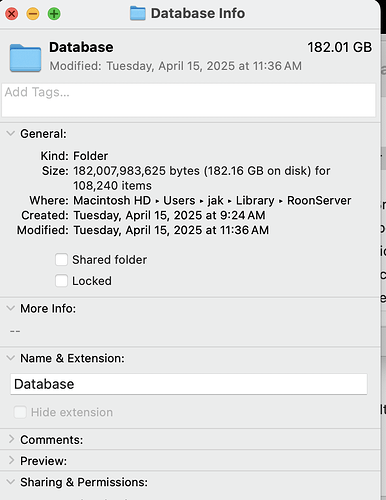

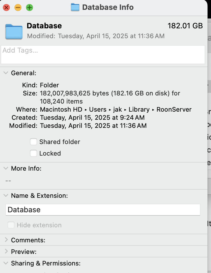

Hi @John_Kustak1 ,

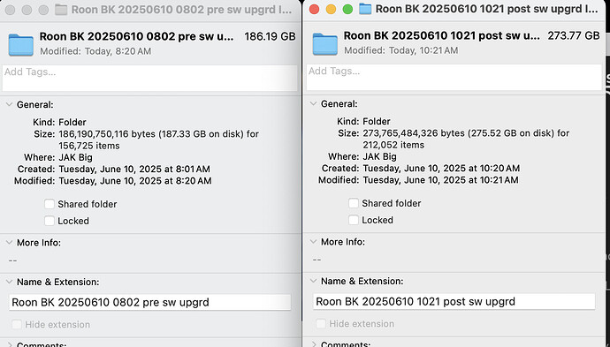

Thanks for that screenshot, that does look odd. I am escalating your case to our team for further review and will get back to you once it has been reviewed.
Is there anything I can do to help or how can we get the size of the DB down to a reasonable size?

I also woke up this morning to the screenshot attached. If the backup process started at 2am, then it was/is running 5+ hours. It likely will not finish.
And yesterday I did some editing on my AppleMusic library. This is where I change the artist name from First last to Last, First. Which causes the folder to change. Which causes Roon to do its magic and track the change and keep the files connected to the Roon library. I did what I think is a handful of artists - maybe 20. Which could be 40 albums and 400 tracks. Roon was playing music during this but at one point the cache ran out and it stopped playing music. I did not time how long it was unavailable - we switched to watching TV.
This is common over the year(s) when a large number of files are moved, Roon takes a while to catch up and sometimes stops playing music as I presume it is busy doing housekeeping.
Hello @John_Kustak1
Please send over a file with the output to our File Uploader.
File uploaded.
Hey @John_Kustak1,
You have my apologies if this has been glazed over, but could you:
  1. Perform a library clean-up in your Roon Settings>Library
  2. Perform a fresh backup to a completely new backup location
  3. Share the size of this fresh back up
    Thank you!

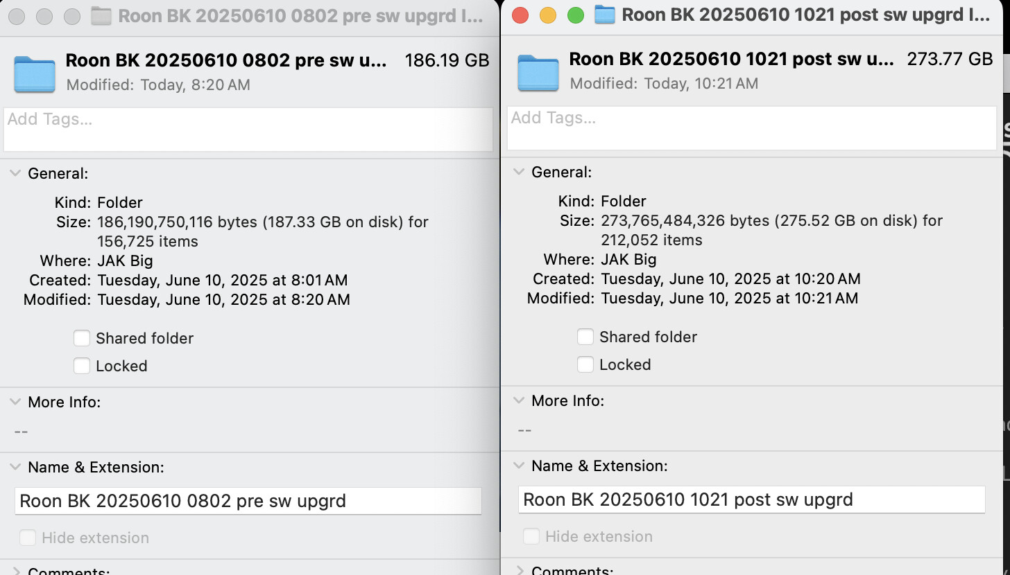

I did the back up before upgrading the version today. 184 GB. Took about 1-2 hours.
I’ll do the upgrade today and another backup.

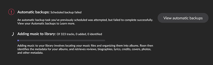

Tried BK after upgrading software.
And ROON is trying to add some files. I don’t know what these are as I haven’t
added in a while. But I did move some more files around yesterday.
I got the post Software upgrade backup to complete. A whopping 273.77 GB !!!
