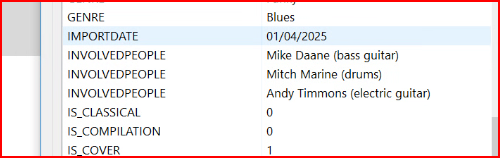

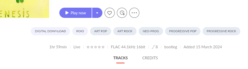

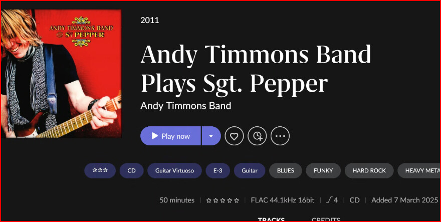

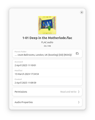

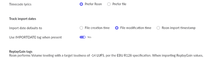

Roon is taking file modification time instead of IMPORTDATE. I’m pretty sure this was working properly a few months ago, but I have started over with a new database.
Am I missing something, or is this a regression?

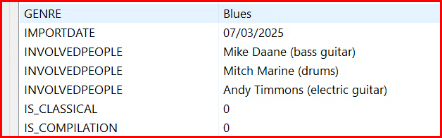

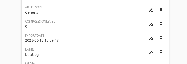

I did a couple of tests by modifying IMPORTDATE and it seems to work as usual
Maybe it’s the date/time format?
Thanks for confirming this. I note that the format isn’t mentioned here:
But, it is here, and uses YYYY-MM-DD
Sigh … DD/MM/YYYY
or MM/DD/YYYY
(?) is not the standard approach. I guess I’ll have to write a script to transform the dates, and preserve the original value. I may try dropping the time value first.

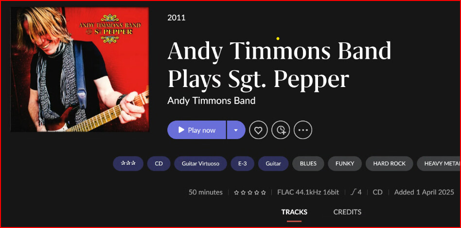

Okay, I’ve had a closer look, and the issue isn’t formatting, but rather the date itself. Roon only uses IMPORTDATE
if all the dates are the same.
In each case I checked, so far, they were multi-disk, and each disk had a different time stamp.
So, to summarize:
DD/MM/YYYY
works (I’m not sure how MM/DD/YYYY
is handled, unless Roon checks locale)YYYY-MM-DD
worksYYYY-MM-DD HH:MM:SS
worksAt least I can keep IMPORTDATE
as-is; I’ll write a script to check for differences in albums, just to be safe.
