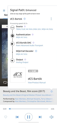

Can you share a screenshot of the signal path when playing to this?
Please find the signal path for your reference.
Hi @Edwin_Leung,
Thanks for the screenshot of signal path. Let me get your report over to our hardware team to see if they can test for this behavior, once I hear back from them, I or another support staff-member will reach out once more, thanks!

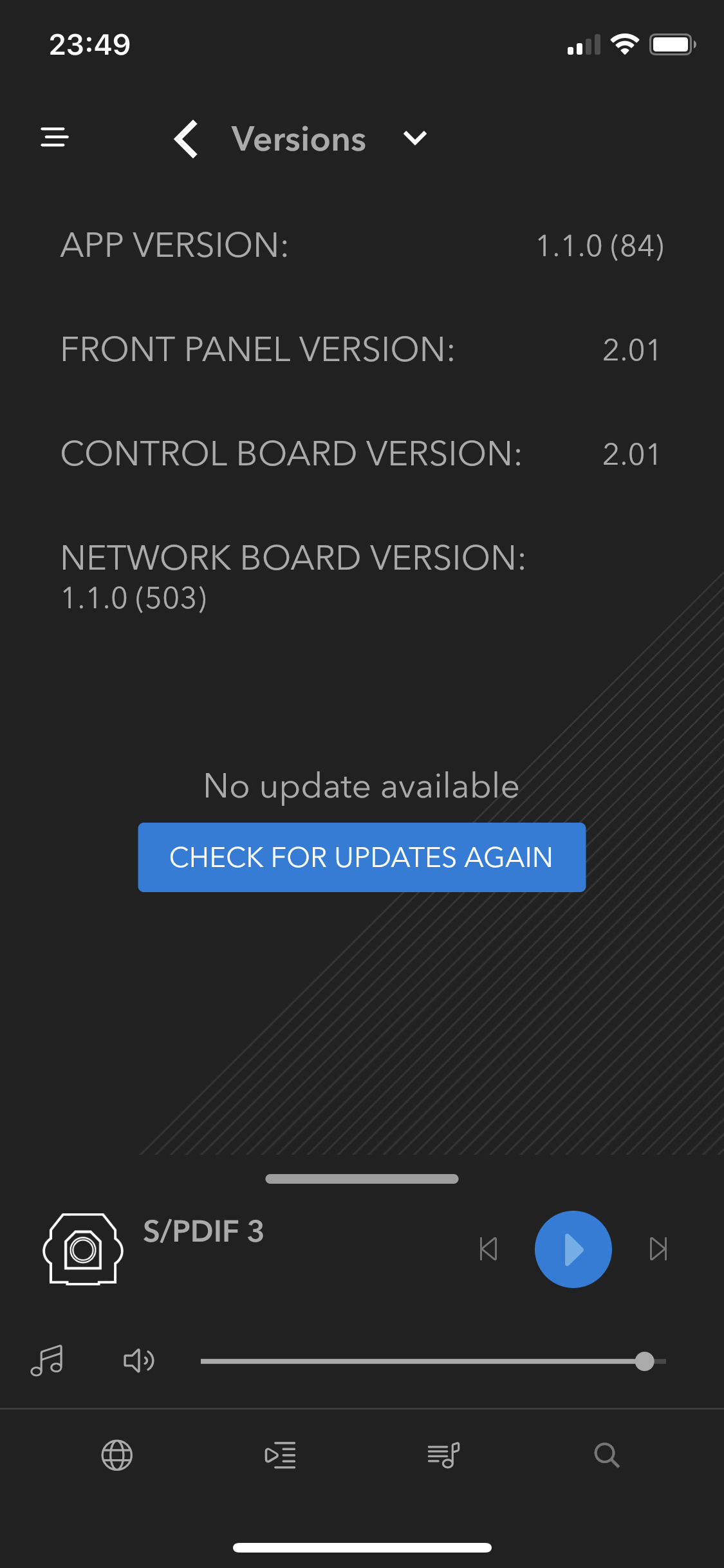

@Jeff_S, do you use your Rossini with the display on or off? Also, what is the “MAIN BOARD VERSION” as reported via the front panel menu?
Hello Andrew,
Playing with the display off.
Here the version(s) you are asking for.
I got this issue either the display is ON or OFF
