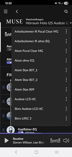

It depends on, for what you’ll use the different zones.
You will use here the same DAC (so potential upsampling should be the same), but different outputs.
So you can save one setting for using it as preamp as “BARTOK_PRE” and another as “BARTOK_CAN” for headphones.
For me I’ve a lot of different settings (using a lot of different headphones) for each zone:
which have different DSPs and also upsampling in use.
