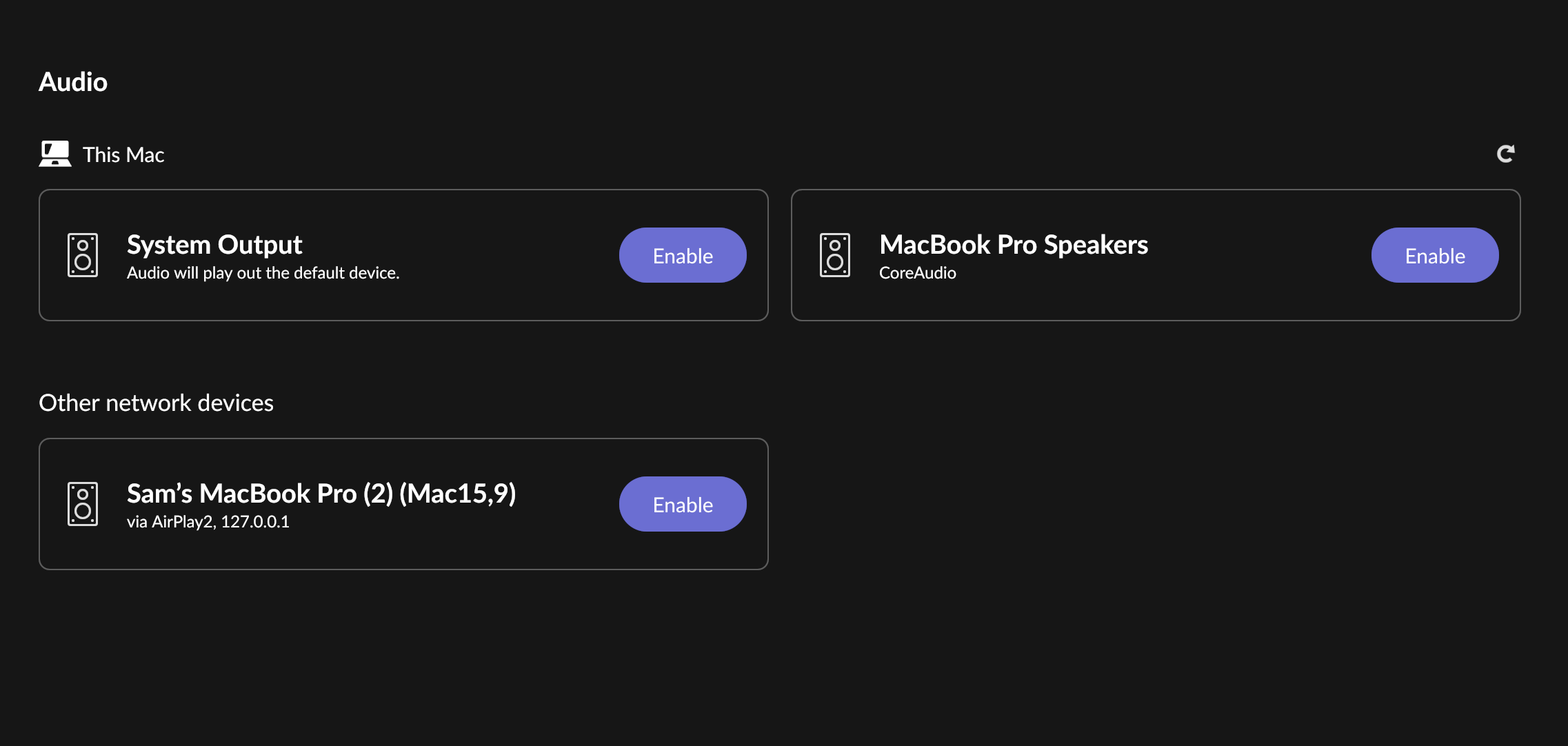

My dCS Rossini does not appear in my audio outputs with my MacBook Pro install of Roon unless I go into my Mac's system preference and select the dCS, in which case it plays with Airplay and not as intended.
Cox Router using top tier fiber optic 1GB... connecting dCS via Ethernet to the router and the MacBook Pro via Wifi to the router.
As I understand it, there have been some issues with Roon connectivity with Sequoia 15.2
As such, I have not updated my MacBook Pro from Sonoma 14.7.2
If I recall correctly, there have been other posts on this subject.
If you haven’t already done so, I suggest that you conduct a forum search.
EDIT:
This is one such post, with multiple replies…
Hi @Sam_Samaha,
Thanks for reaching out to us about this issue. @Bauer is correct that there are ongoing issues with Sequoia. Please try the below steps and let us know the result.
  1. Retoggle Roon permission in System Settings → Privacy & Security → Local Network when networked Zones disappear
  2. Restart RoonServer to rebroadcast device discovery
