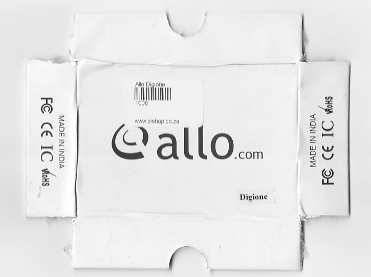

I have a Pi4 fitted with Allo DigiOne it works fine. . It was my daily streamer for several years before I upgraded
I was demoing a new headphone amp and needed a streamer so I made a fresh SD card , powered up and it worked fine. I am not sure what hardware rev the Allo Digone is , its quite old July 2018. It’s running as we “speak”.
Maybe Google AI is wrong ?
