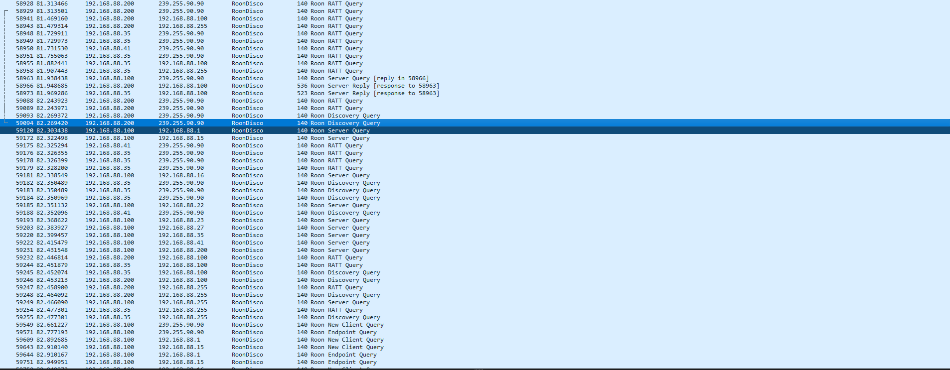

My ISP had a Calix tech analyze my traffic during error mode on Android and also looked at traffic with Windows, where Roon connected as normal. They came back today and indicated the Roon app is my issue.
Hey Jeff,
Mike from Calix finished analyzing the packets and had this to say:
“Hey Ty,
After looking at those captures, I am very confident that it is a Roon issue. Below are a few screenshots. In the first two are the working Windows device and the working android after the server was rebooted. You can see that I have highlighted a reply packet from the server. In the last screenshot, the broken phone, there is not reply from the server. This subscriber’s best course of action would be to engage Roon support.
Inline Image: (Salesforce)
Let me know if you have further questions. If not, I’ll go ahead and close this out as it is not an issue with the Calix system.
Regards,”
I’ll attach screenshots to the email so you can see what he’s talking about as well. I know you said that you were waiting for Roon’s reply on the issue last time we spoke, I’m hoping that they will be able to identify and fix the issue you are having. Thanks for all your patience and time and please feel free to reach out if you need any further assistance.

My ISP sent these 3 screen shots which show that Roon works with Windows and it works with Android right after a reboot of Nucleus. The 3rd screen shows Roon is broken with connecting to my Android Samsung S23 plus phone, just a few minutes after rebooting Nucleus. This proves that there is a bug with Roon software working with Android devices. Can this be fixed or should I return the Nucleus server and revert back to running Roon off my PC which had no issues with quickly connecting to Android devices? Thanks!

We are sorry to hear of your disappointment. Esentially from the screenshot you shared before both use cases looks broken.
We’ve reviewed the network capture from your system, and this does not indicate a faulty Nucleus.
The capture shows that the Nucleus is actively sending Roon Discovery and RATT UDP packets, which means the services on the Nucleus are running and functioning correctly. However, the expected discovery replies are not making it back. This pattern points to the network blocking or filtering the return multicast/broadcast UDP traffic, not to a failure of the Nucleus itself.
If the Nucleus were broken, we would not see consistent outbound discovery traffic at all. Since that traffic is present and correct, there is nothing on the Nucleus side that needs to be fixed — the behavior is consistent with a network-level restriction rather than a hardware or software fault.
Here is the screenshot for your reference how the networking works without any blocking
