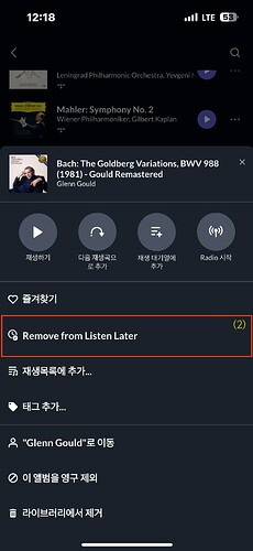

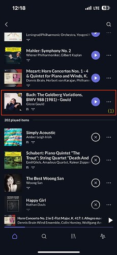

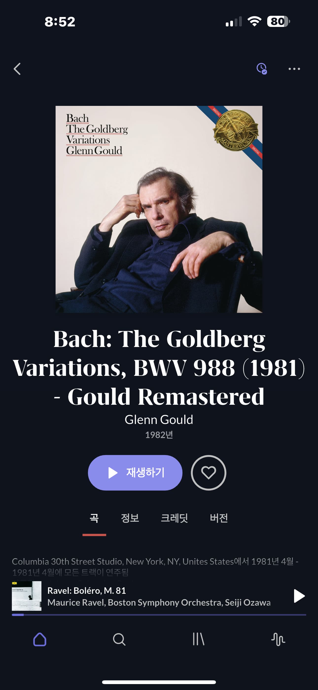

I deleted one of the albums in Listen Later using the Delete from Listen Later feature in Roon ARC, but it keeps getting added back automatically.

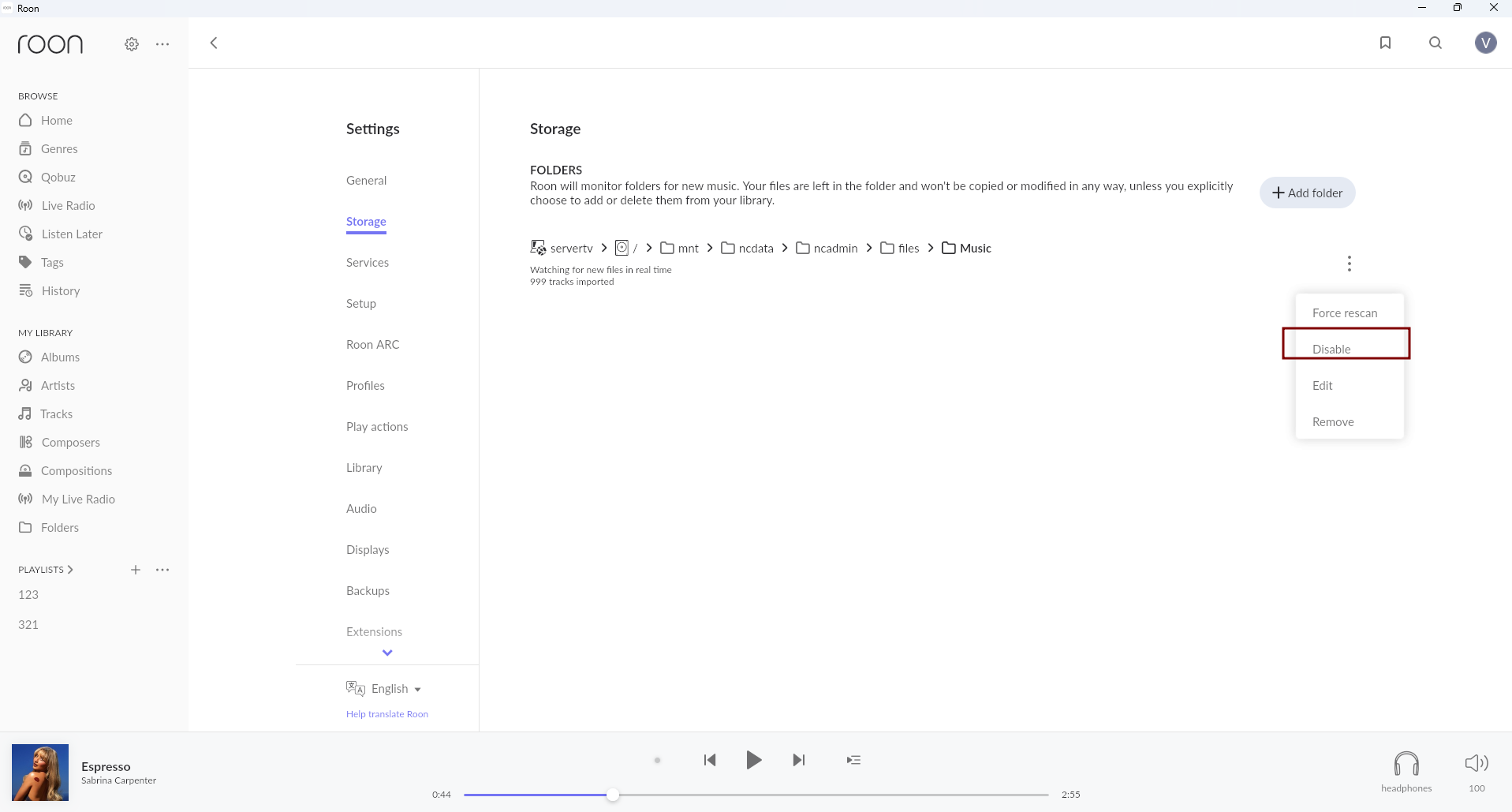

I was wondering how to temporarily disable storage in roon server and roon on my mac mini.
Do you mean to remove the folders specified in Settings >> Storage in roon?
Hello @dian92,
To temporarily disable the storage, please navigate to Settings > Storage, click on the three dots next to the storage folder, and select Disable.

Don’t remove the storage location. Just disable it as vadim showed.
Once you do that the listen later item will switch over to the ghost Qobuz or Tidal album you originally marked as Listen Later allowing you remove it. You will then be able to re-enable your storage location and it should permanently be gone.

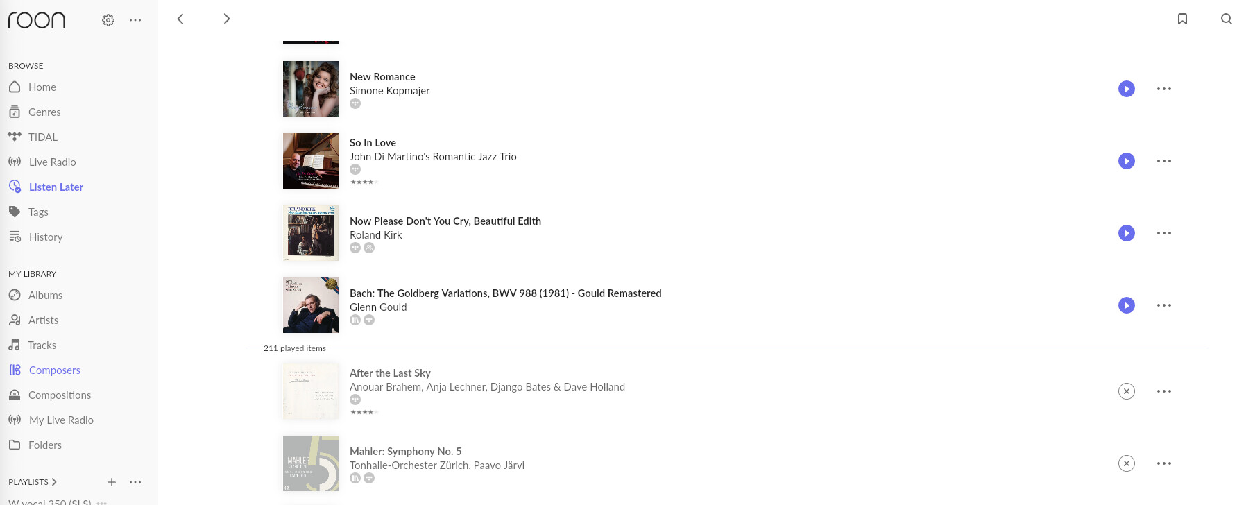

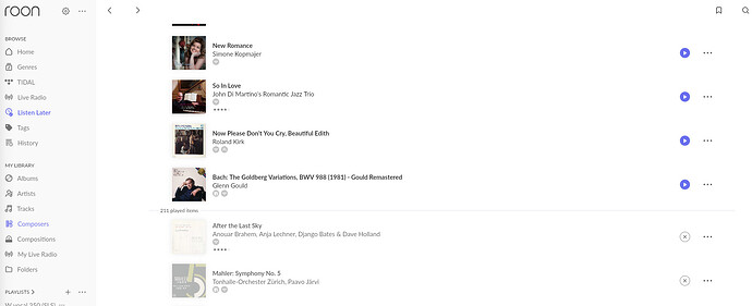

  1. I’m having issues with both Roon Remote on my Mac and Roon ARC on my phone.

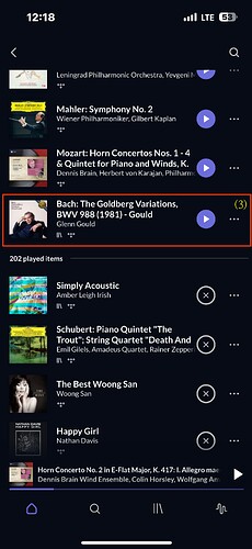

  2. I followed your advice and Roon Remote has removed the record, but Roon ARC still won’t remove the record.
  3. just in case, I deleted and reinstalled Roon ARC, but it’s still the same.
That’s the situation I was in until yesterday.
And below is a new situation.

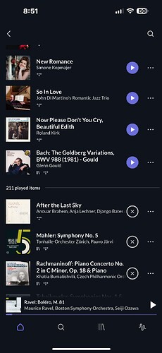

  1. I shut down Roon Server and restarted it.
  2. I launched Roon Remote and the same album is still in the Listen Later list again, and so is the Roon ARC.

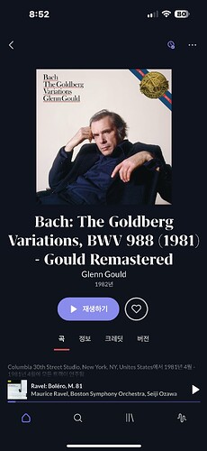

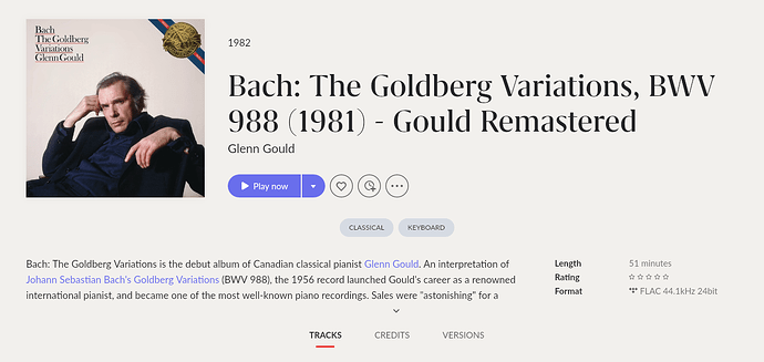

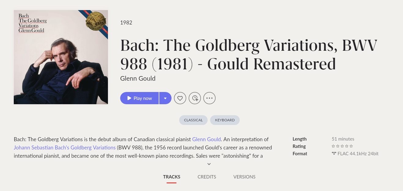

  3. interestingly, when I look at the information for this album in Roon Remote, the Listen Later button is off, and when I check it in Roon ARC the Listen Later button is on.
