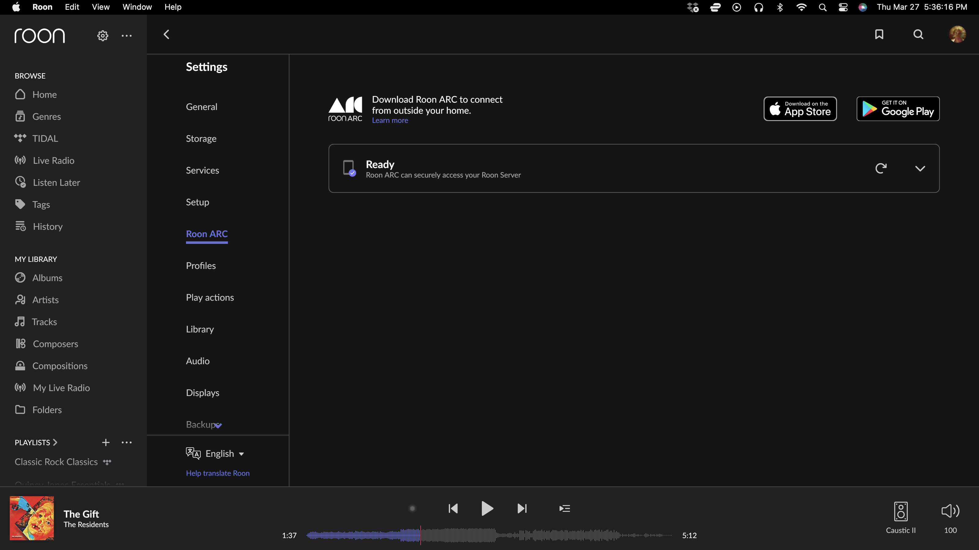

Do you see a diagnostic message in Roon Settings → ARC? What about in the settings page of ARC itself - do you see a red light next to the server connection status?

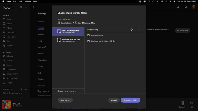

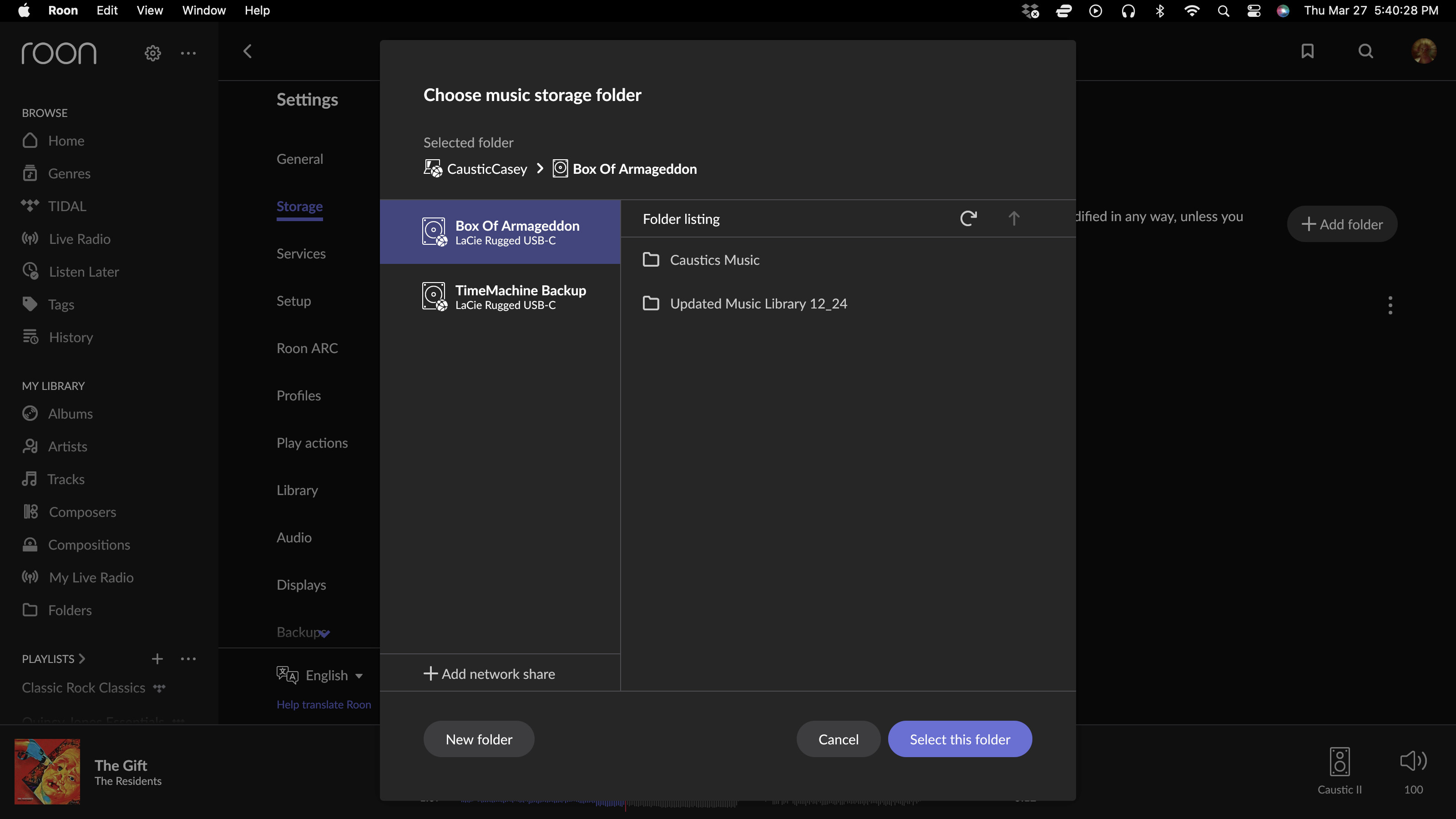

The Box Of Armageddon is connected directly to the Nucleus via USB right now. I’m not sure if the Nucleus has imported the library. I am on the network share but am having problems finding the right path, I get info, copy and paste, but I keep getting an error message. I apologize. I have a beautiful system, but am a low end audiophile. I’m a drummer. Hah.

Thanks for the screenshot! It does look like your library is indeed still hosted on the external drive. If you’re wanting to transfer your local library into the internal storage drive within the Nucleus, here’s more info on how to do so:
  1. Click into Finder>Go>Connect to Server on Mac.
  2. If you see your Nucleus, double-click to open it.
  3. If you don’t see it yet, enter 'smb://NUCLEUS ’ or 'smb://[IP Address of your Nucleus] ’ (don’t include the brackets, only the IP address ) - note that if you have a Nucleus One, you’ll want to type NUCLEUSONE instead of NUCLEUS
  4. If prompted for a login, enter: Username: guest Password: guest
From there, click into the Data folder > storage > and you should see your Nucleus internal storage folder. This is where you’ll want to import your local library into.
You’ll want access to the library on your external drive via the Mac as well so you can perform the transfer.
For Arc, it looks like your issue isn’t related to port forwarding or your connection to your Nucleus - what issues are you having specifically with it? While you’re on your home wifi, make sure you open Arc and perform an initial sync to your Roon Server. Let me know if you’re able to do this, thanks Casey! :+1:
