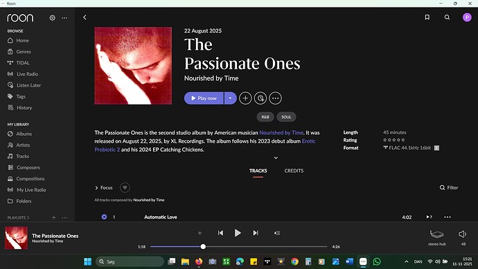

how to delete automatic playback
after playing a number roon continue playing random pop music i have not chosen. how to delete automatic playback

thanks. found it.
it should be placed under “play actions” make no sense to place it at the play control bar.
