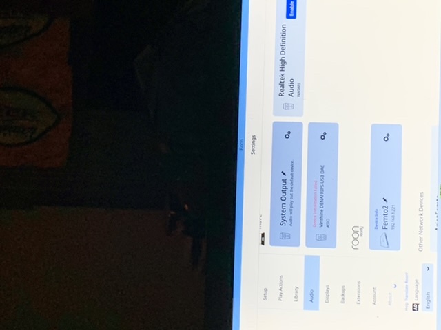

I went in and downloaded the Theyscon driver this evening on the Windows based Laptop.
Installation complete, however no option to select audio output. I streamed Roon again all working

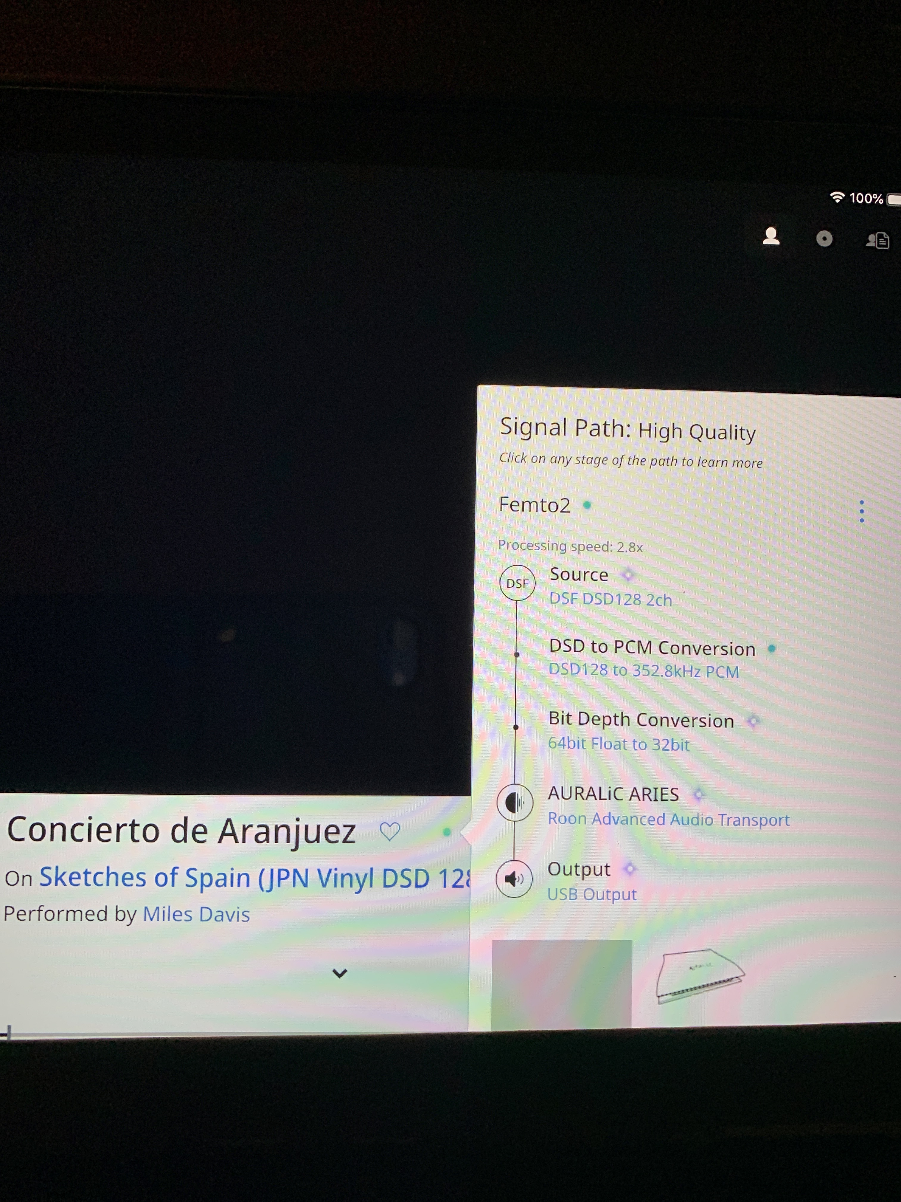

Here is a snapshot of the steam via the old Amenaro driver.
Here is the new driver output showing up in Roon. I can not enable it?image
I have re booted the DAC and the Roon program. Same results.

I just saw something here. What do I need to change in the settings? Or is it in the AURALiC Aries Streamer Setting?
Ok, figured out the DSD issue. AURALiC Aries was converting SAD to PCM. However Roon states the down conversion was producing the highest sound quality? The Indicator light was green.

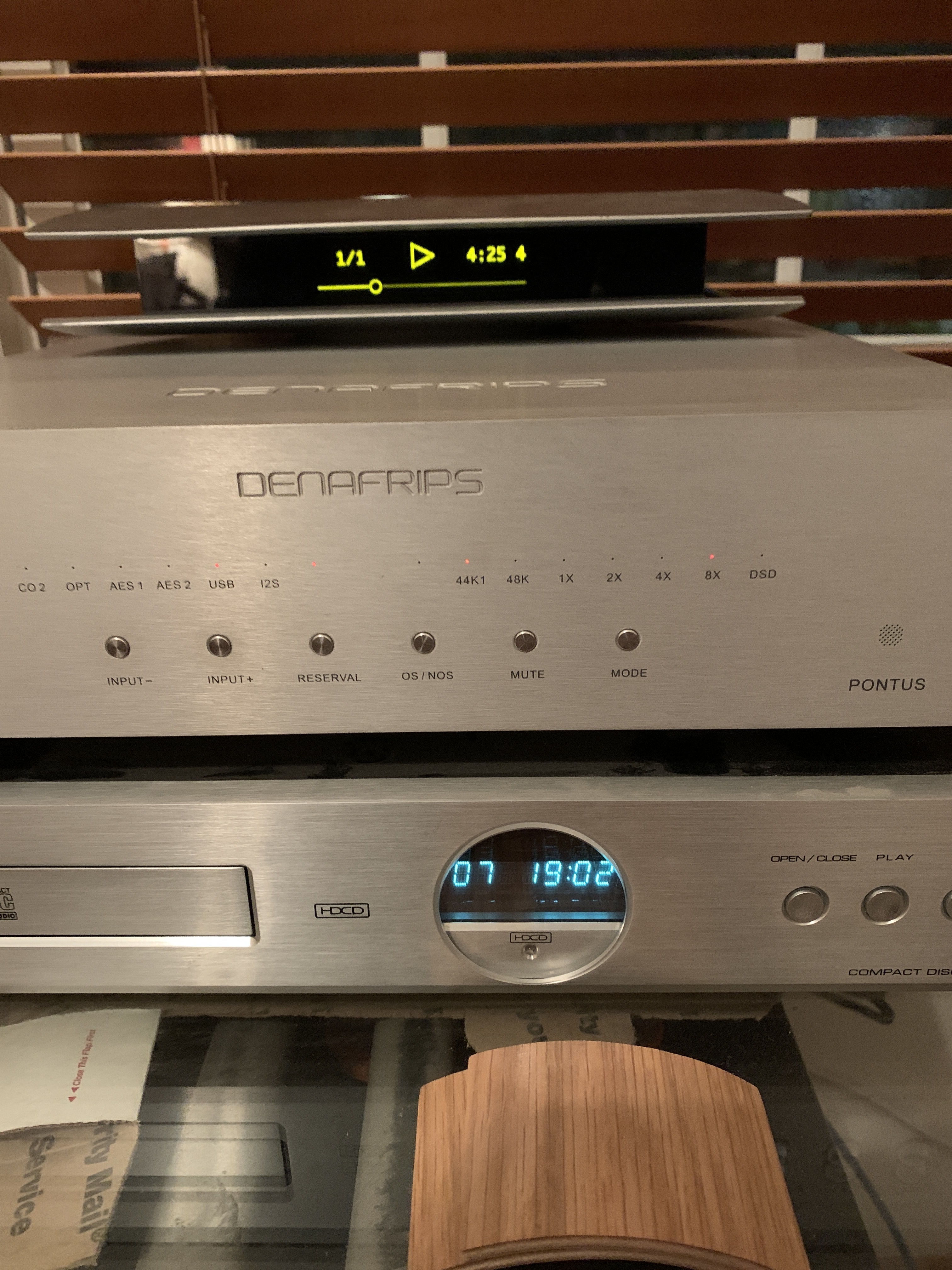

The DAC now has the DSD 4x lights on and the 44x light on? Not Sure about that. And it will only play part of the song. Performance issue hardware or media moving slow. Audio file is loading slowly.
** Alas I still can not “enable” the USB Vinshine Denafrips USB DAC States connected to core.
@alvin1118 Alvin might be best to answer here but what core are you running that won’t see the Pontus if it’s connected directly via USB?? Windows driver is only going see the Pontus on USB direct not behind the Auralic
