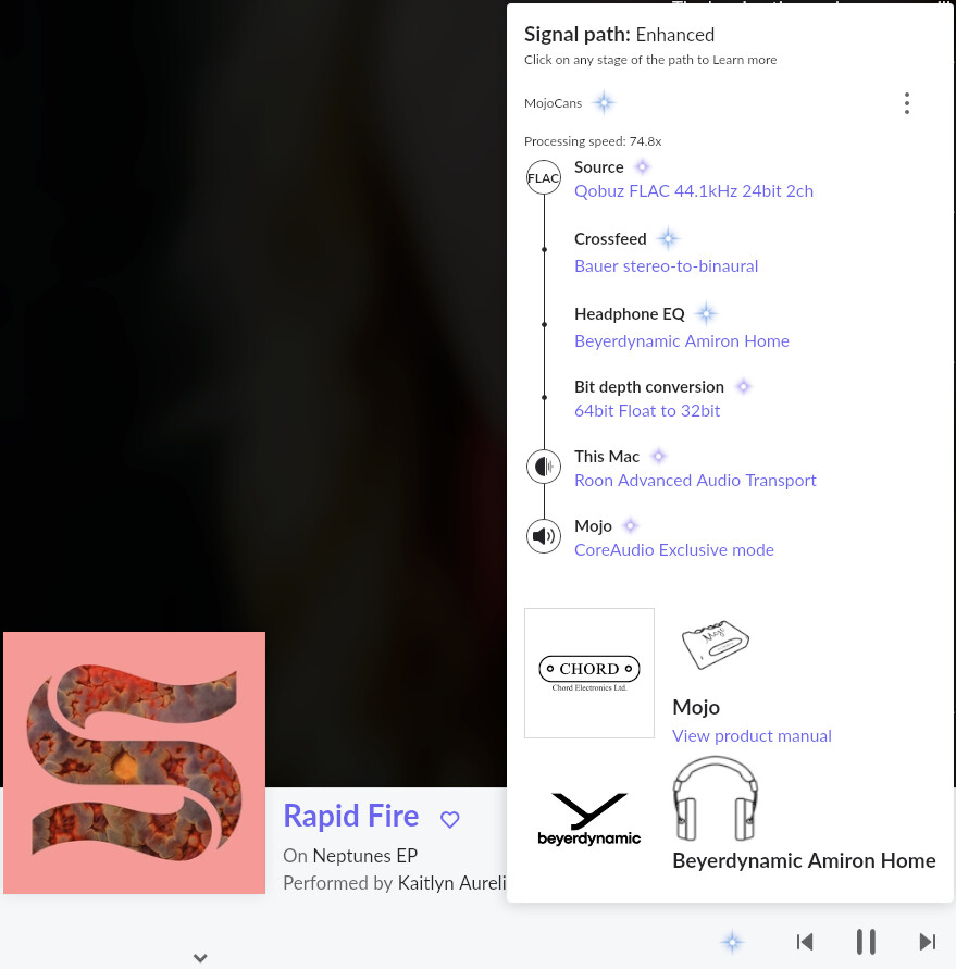

· Chord Mojo (1) via USB-C to Mac Mini M4
'Destroyed zone' repeatedly causing playback interruptions from Qobuz to Mojo connected via USB-C to Mac Mini M4 Roon Server.

Are you running with Mojo in Exclusive mode or Private? Maybe try turning that off and see what happens.
Thanks but no, I’ve not enabled Exclusive / Private mode.
I’ll want to continue to access Mojo from other remotes.
