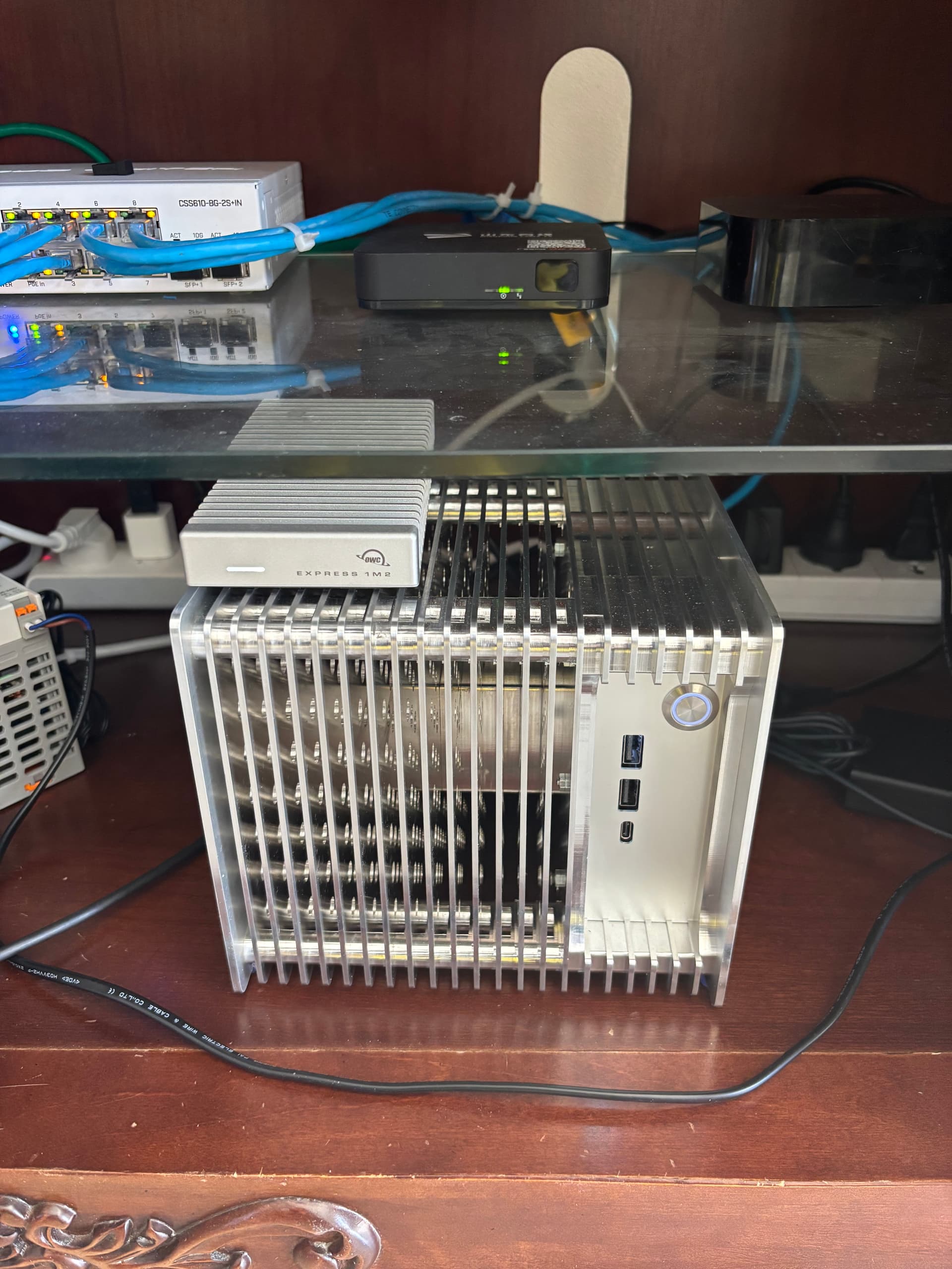

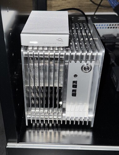

@Wade_Oram - I have a “small” challenge related to energy consumption.
If I turn off my DietPi headless PC than the new OWC Express 1M2 (see below) is still one. But I can’t finde any setting for that.
That is not the case when connecting OWC Express 1M2 to a Windows 11 PC. If I turn-off the Windows 11 PC than OWC Express 1M2 also turns-off
Torben
You are sure the DietPi is actually off when you think it is?
I would imagine that is either a machine architecture or BIOS setting thing. I know you are using Thunderbolt (rather than plain USB3/4) but I have had PC’s in the past which supply permanent power to the USB ports (or at least a subset of them).
It is certainly nothing to do with the DietPi performance settings which are related to the processor only.
On the picture both are on :slight_smile: If was just for illustration

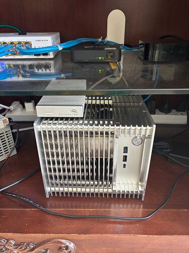

Here a real PIC where the DietPi PC is off and the Thunderbolt is still on:
Torben

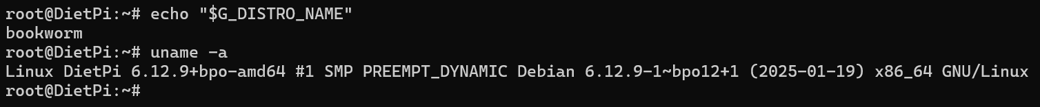

Hi Sam. I am running DietPi v9.10 and Linux DietPi 6.12.9+bpo-amd64 #1 SMP PREEMPT_DYNAMIC Debian 6.12.9-1~bpo12+1 (2025-01-19) x86_64 GNU/Linux
and it works fine.
