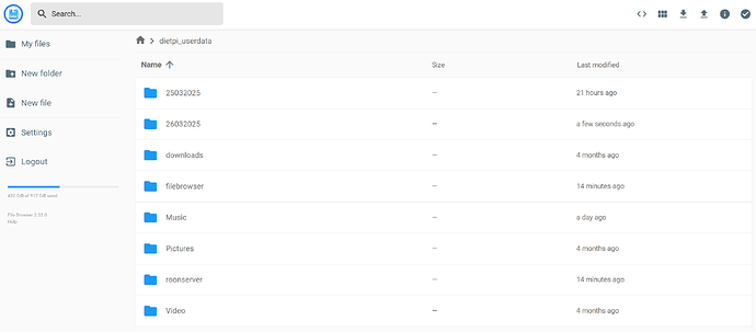

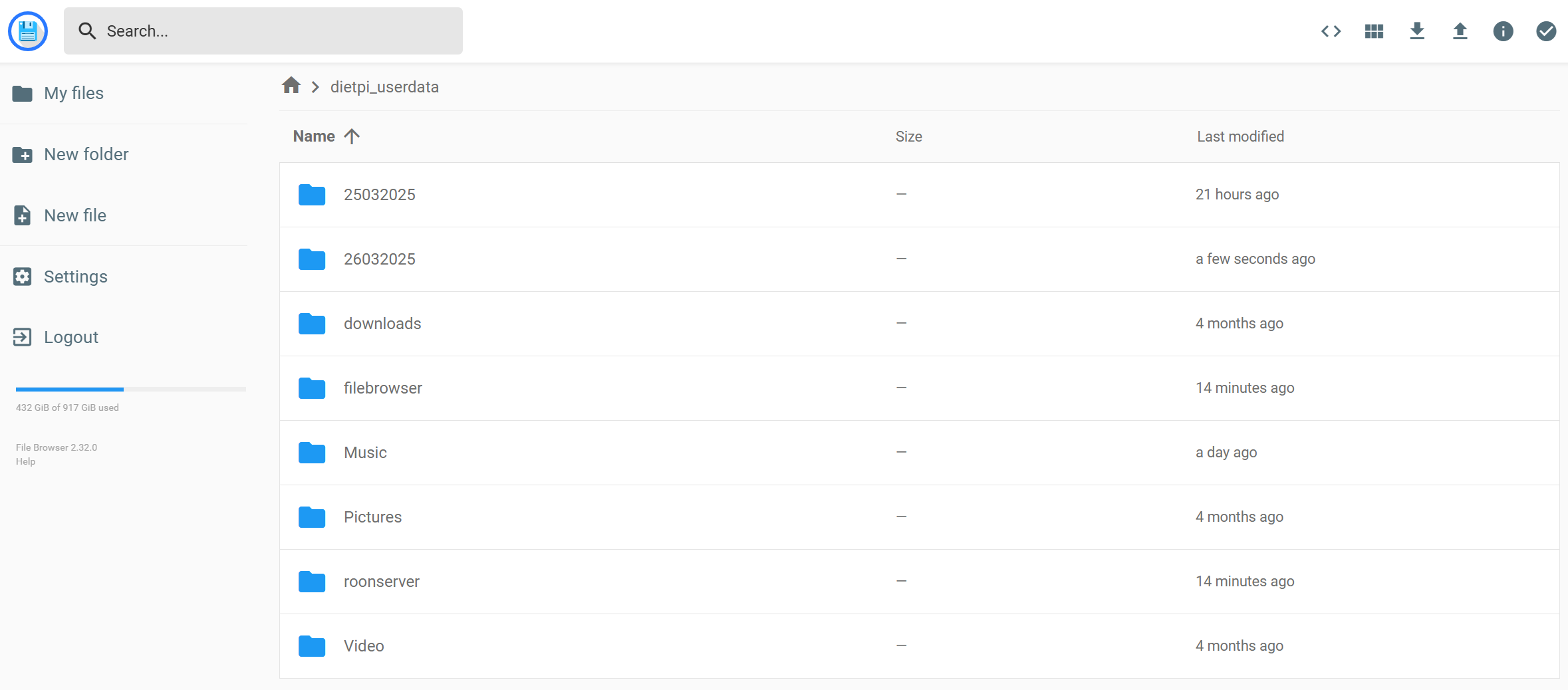

Just installed it. Very nice user interface, better than DietPi Dashboard
Torben
They are not aiming to do the same thing. Yes, this appears nicer (from your screenshot) than the file browser part of DietPi dashboard, but the latter is not the primary purpose of the Dashboard. In fact, I have never used the DietPi Dashboard file browser (I even had to run up the Dashboard to confirm that it even offered this functionality because I couldn’t remember with any certainty :slight_smile: ).
The intersection in functionality between File Browser and Dietpi Dashboard is likely very small indeed.
Nor are they mutually exclusive. You can have both running on the same DietPi installation.

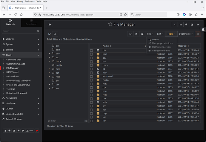

Another alternative is Webmin. This is also supported out of the box with DietPi and it offers a file manager that is closer in appearance and may offer even more functionality - for permissions management, for example.

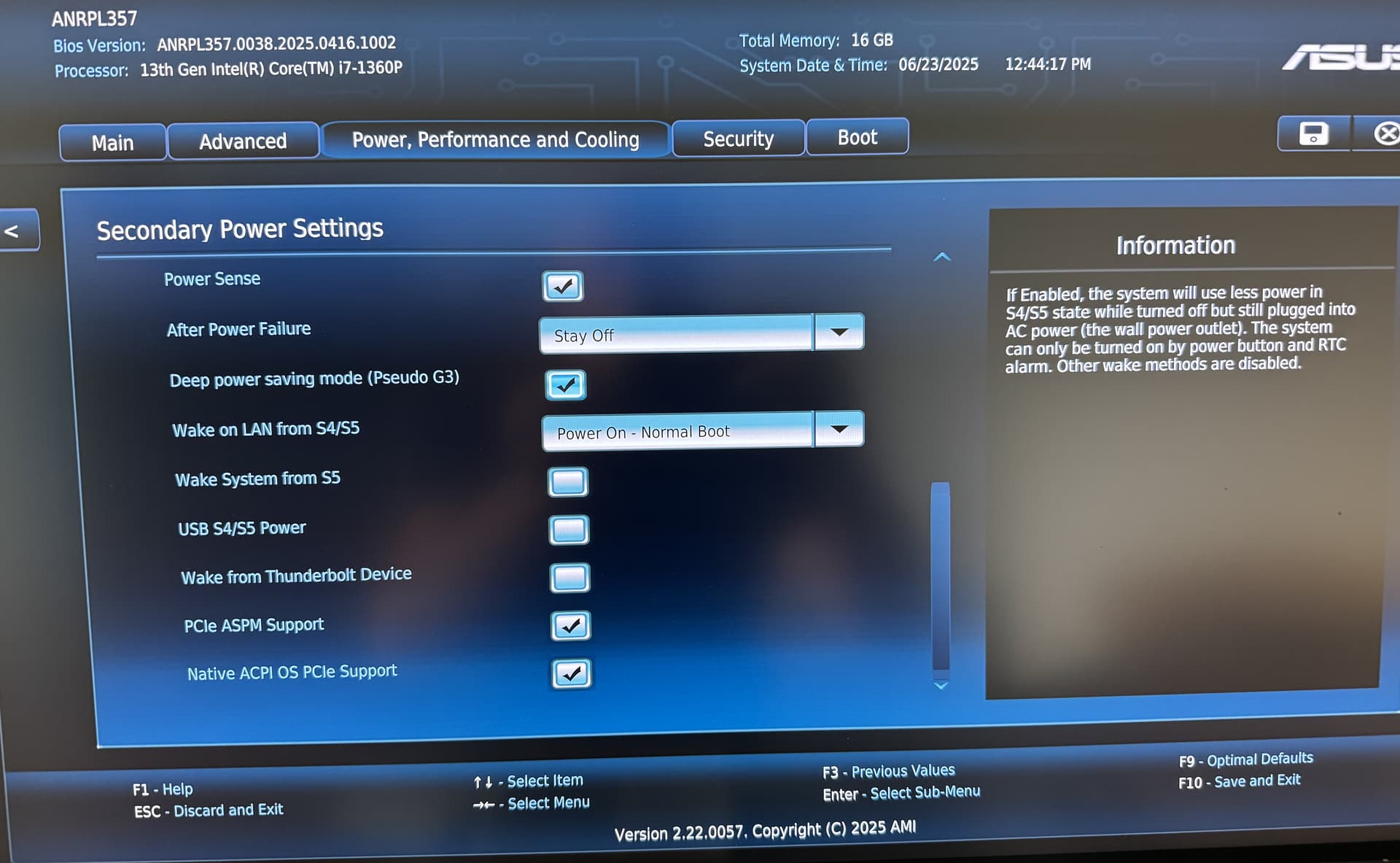

Currently I have activated “Deep Power Saving Mode” to make sure that my OWC Express 1M2 also is turned off, when turning off the NUC. But now I can’t use Wake-Up-Lan anymore. Currently it is not possible to have both.

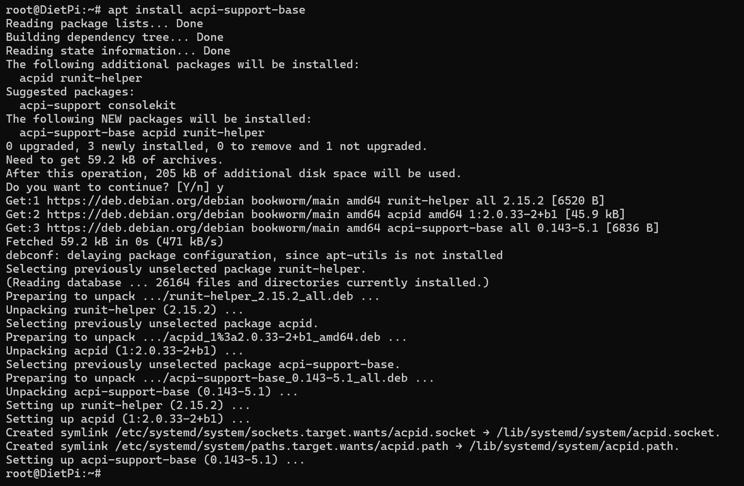

@Roland_von_Unruh Hi Roland
There seems to be a more simple solution. Just use
apt install acpi-support-base
Nothing else, it includes the power button trigger.
acpi-support-base is a Debian package that provides scripts for handling basic ACPI (Advanced Configuration and Power Interface) events, such as the power button press.
Torben
The installation look like this:
