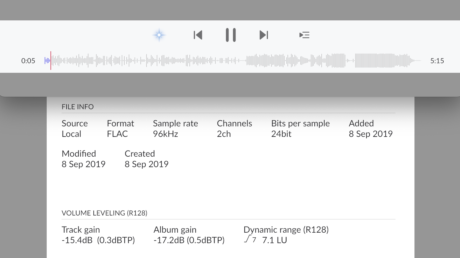

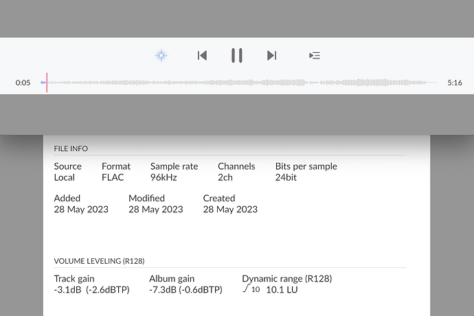

I have imported a couple of Vinyl transfers into my collection and noticed that the waveform for these is a lot more subdued comparing to the digital download version of the same song.
  1. Digital Download
  2. Vinyl Transfer
For this song the waveform from the Vinyl transfer looks a lot less dynamic than the digital download even though the Dynamic range supposedly is greater.
Is this expected behavior based on the file info or what is going on here?
Thanks for clarifying this :smiley:
It looks as if they are different tracks (although they are not). The vinyl transfer version completely lacks the silence periods that are in the digital download at 1/2 and 3/4 of the track.

In my experience, this is expected. In terms of peak levels, analog transfers are conservative, while digital downloads are almost always over the top. The true peak level of the download is 0.3dBTP, which is positive and thus already clipping in theory. The true peak level of the transfer is -2.6dBTP, which may be a bit low, but will have no issues with clipping during playback. (Ideally, it should be around -1dBTP, so it can still be safely scaled up a bit.) The download’s peak is about 40% higher than the transfer’s, which is definitely visible in the waveform.
Also, peak levels and dynamic range are not directly related, so you can have a wider dynamic range and lower peaks. The download is most probably dynamically compressed to sound louder. This is why the track gain (i.e. the amount of gain you would need to bring the track to a reference loudness level) is way lower for the download (-15.4dB) than for the transfer (-3.1dB). This suggests that the download is about 12.3dB louder.
