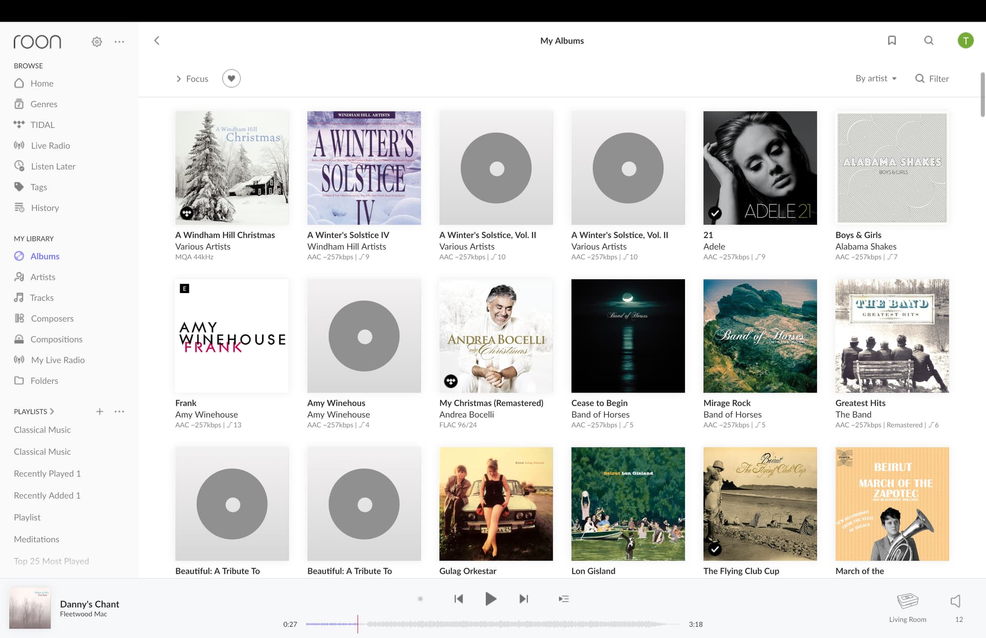

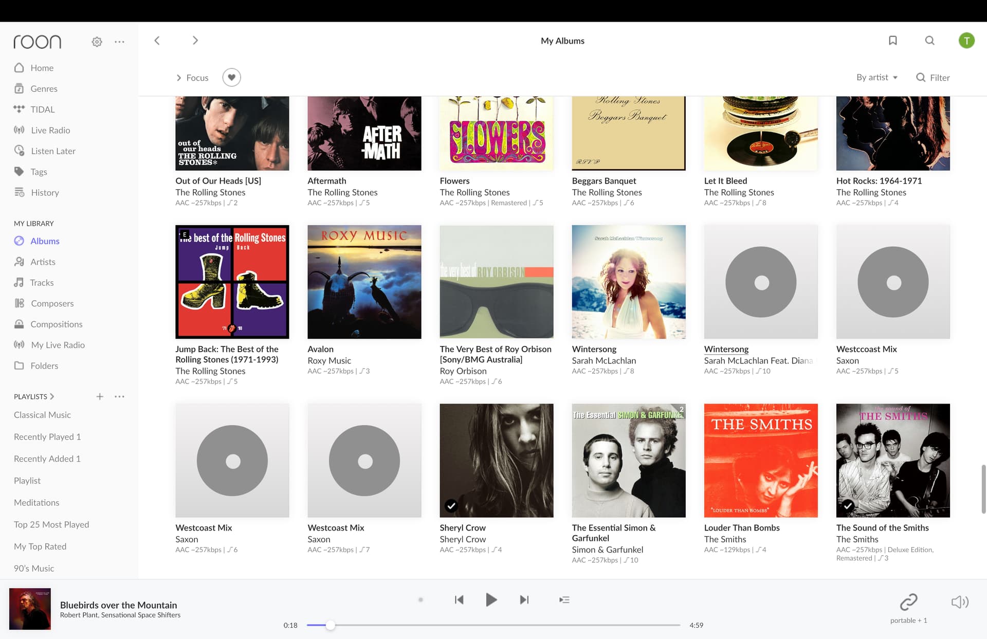

However, I now have duplicate and triplicate albums likely because I had inadvertently stored my music in a number of files.
When I tried to deleted a duplicate album, it ended up deleting both albums.
If we assume that the duplicate/triplicate albums are due to them being in more than 1 file, what is the easiest way of deleting the duplicate albums.

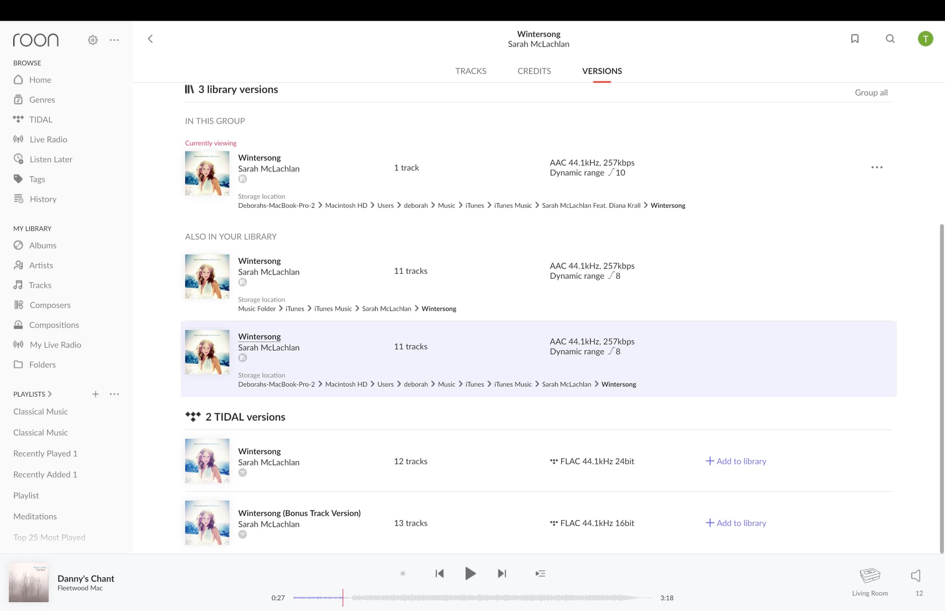

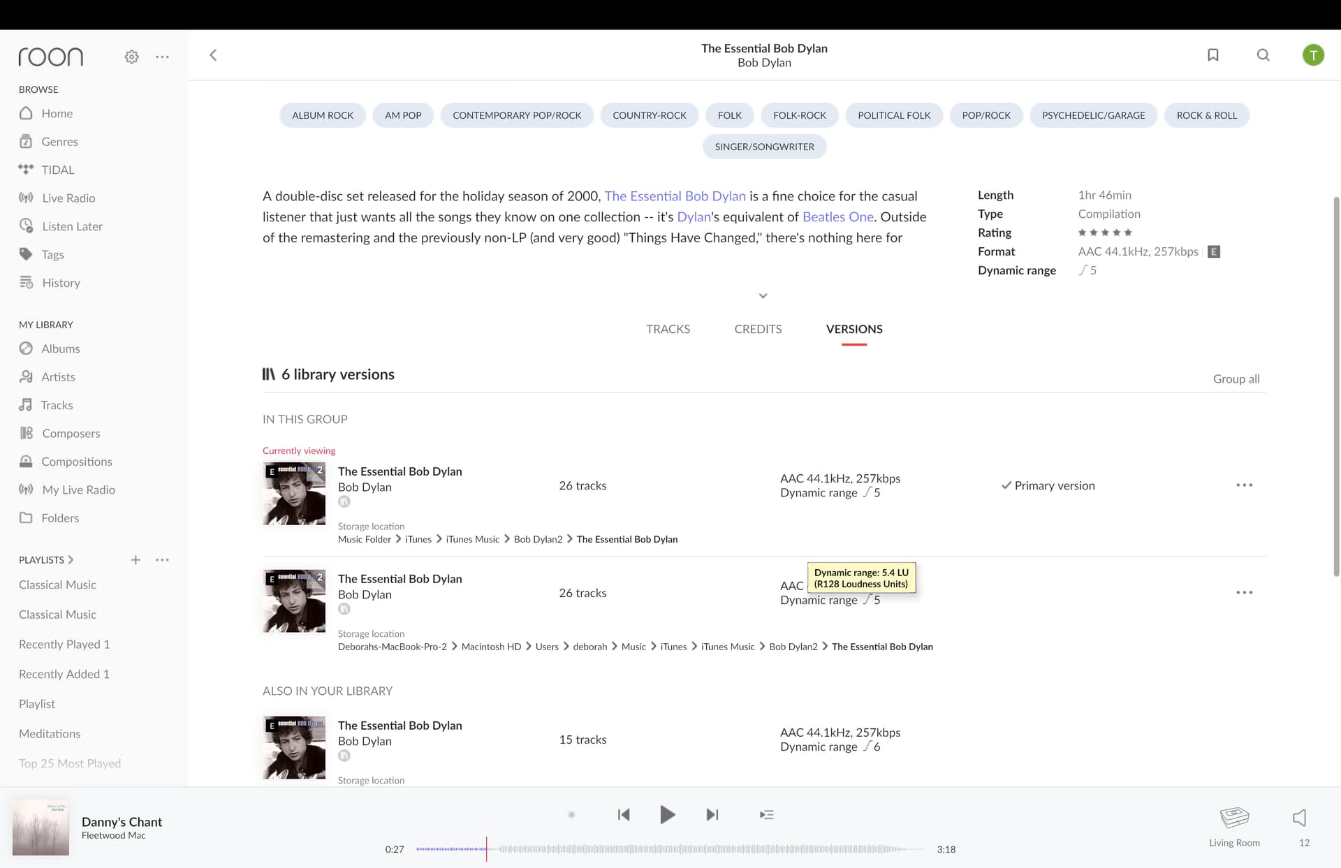

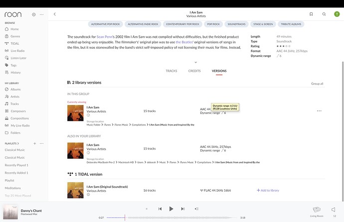

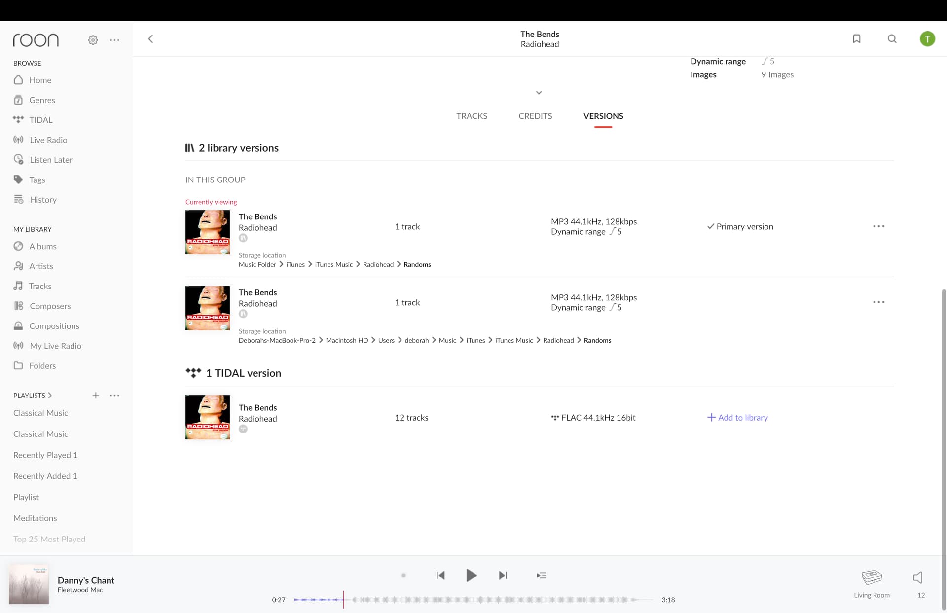

  1. Are the albums duplicated in your actual music folders, or are you only seeing duplicates within Roon?
  2. Please share a screenshot of one example duplicate album.

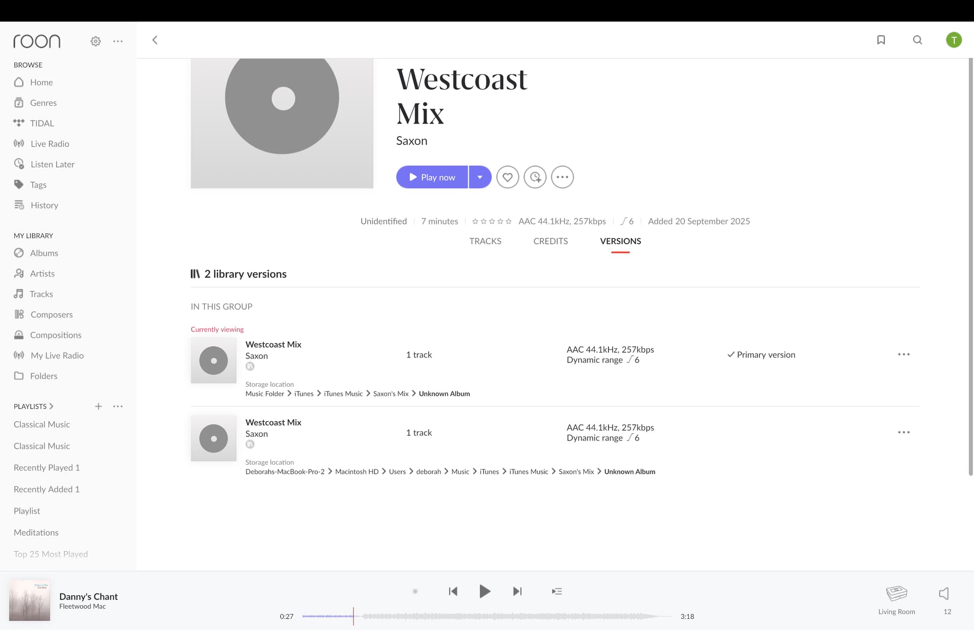

  3. For that same album, please also open: Album → Versions* and share a screenshot of what is shown there.
This will allow us to determine whether Roon is displaying multiple versions from different sources (e.g., local + streaming), or if the files are actually duplicated on disk.

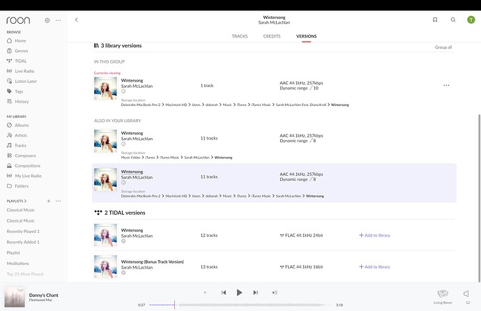

Hi Ben, I know you said 1 screen shot but there are 2 situations. Most are strictly duplicates, but some are albums which fragmented when I changed over to my new server. Thanks again, Tim

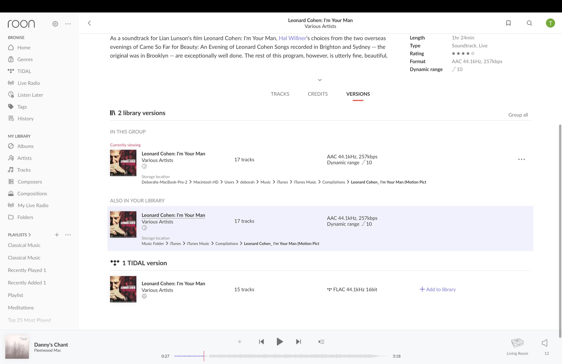

I was unable to find “Versions” of the albums by going into the album.
Hi, I found “Versions” on most, but not all, of my albums. I did not send you shots of the albums that had no Versions.
Tim

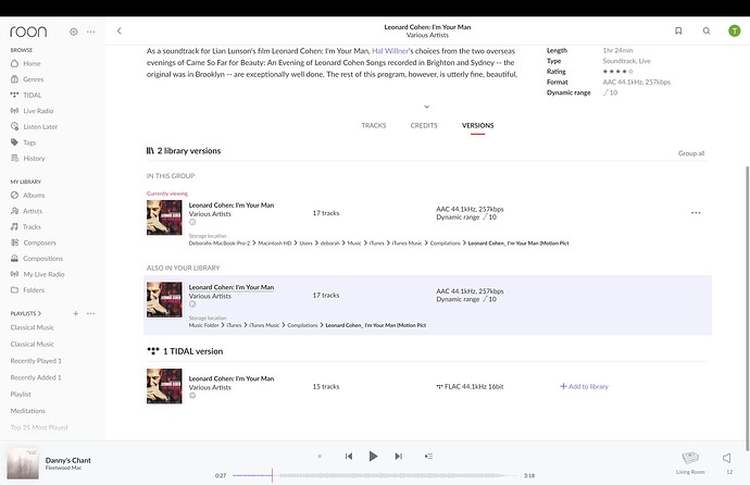

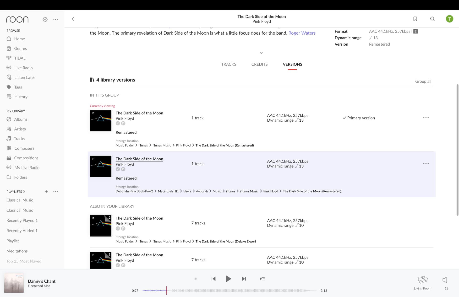

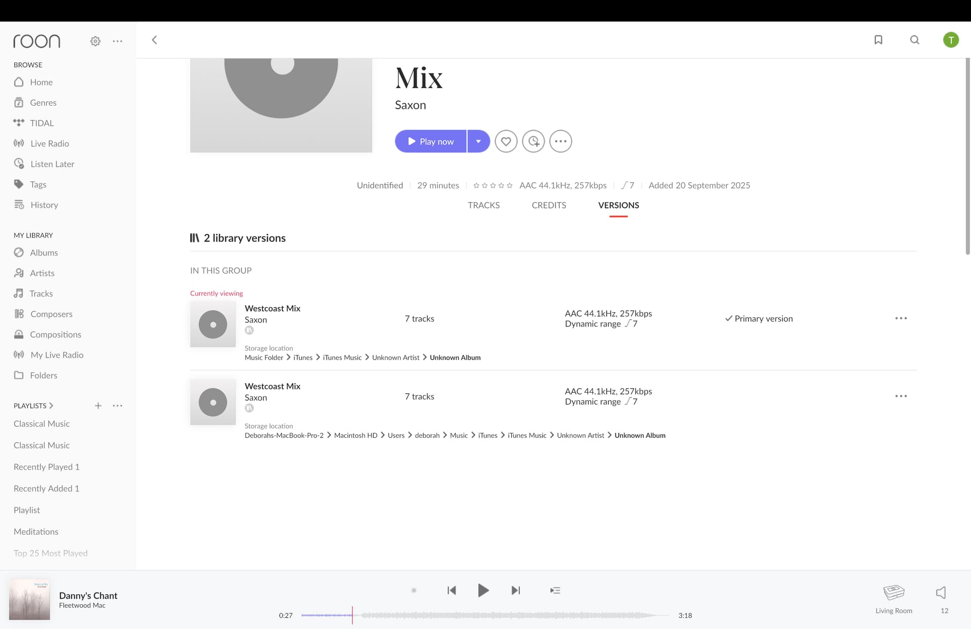

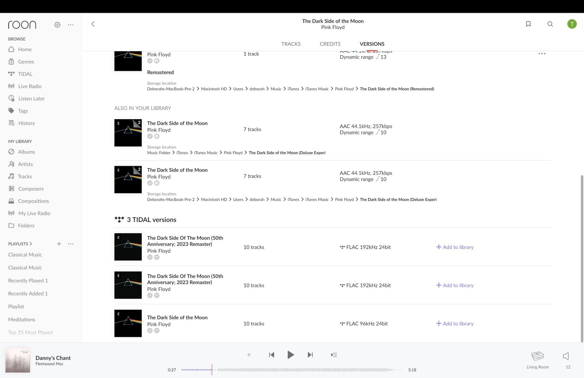

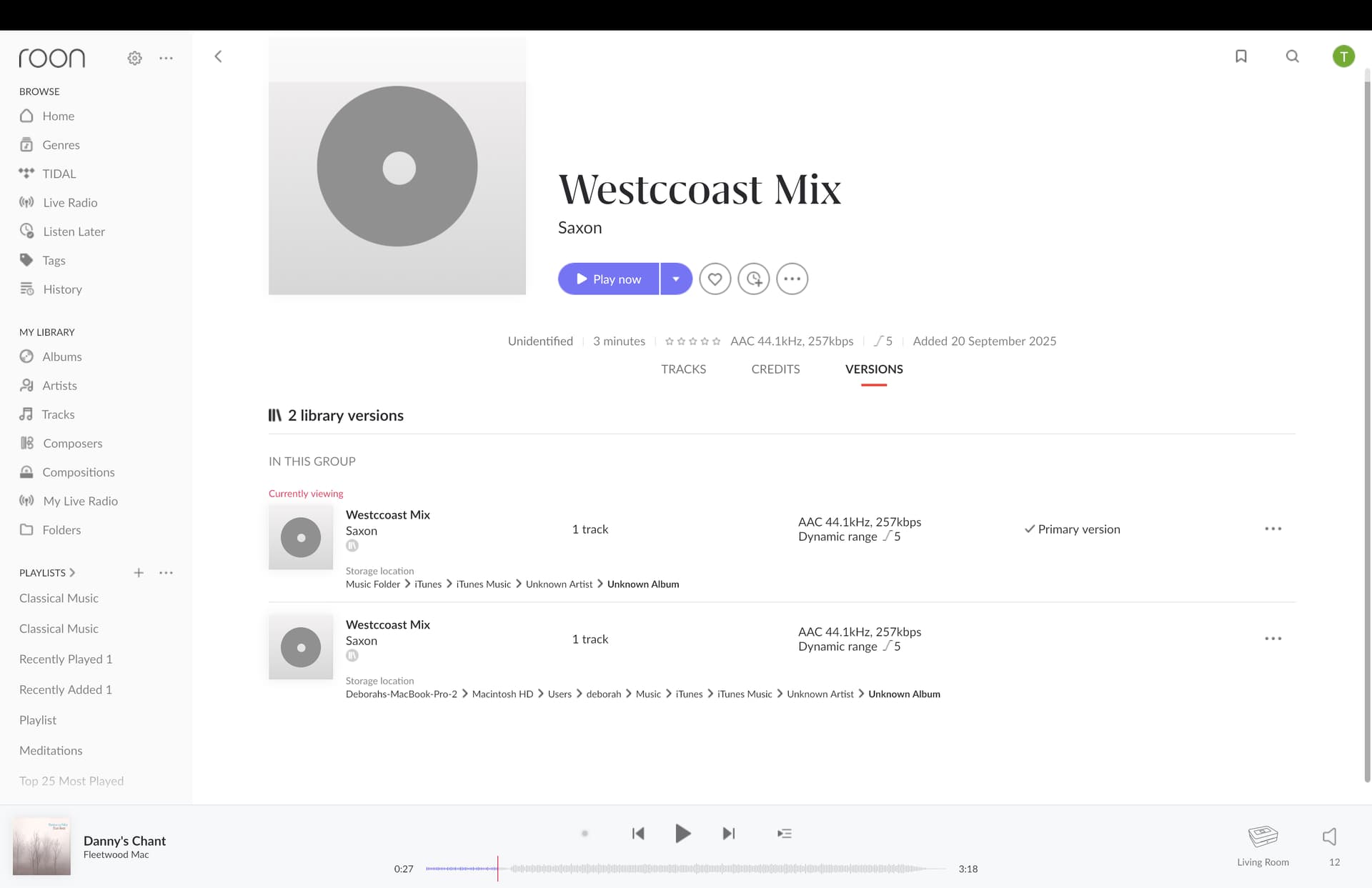

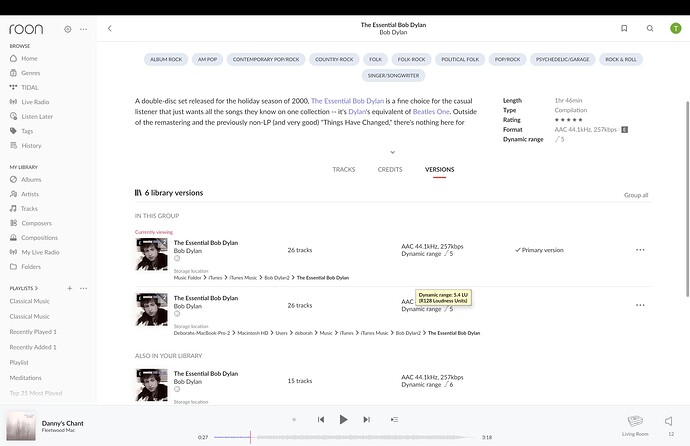

All duplicate albums seem to be present in two different storage locations.
In settings → storage you can enable and disable storage locations.
If you don’t want to disable locations, you can also choose to not show hidden tracks and albums under settings → general. This way, all albums with more than one version in your library will only show up once in a view.

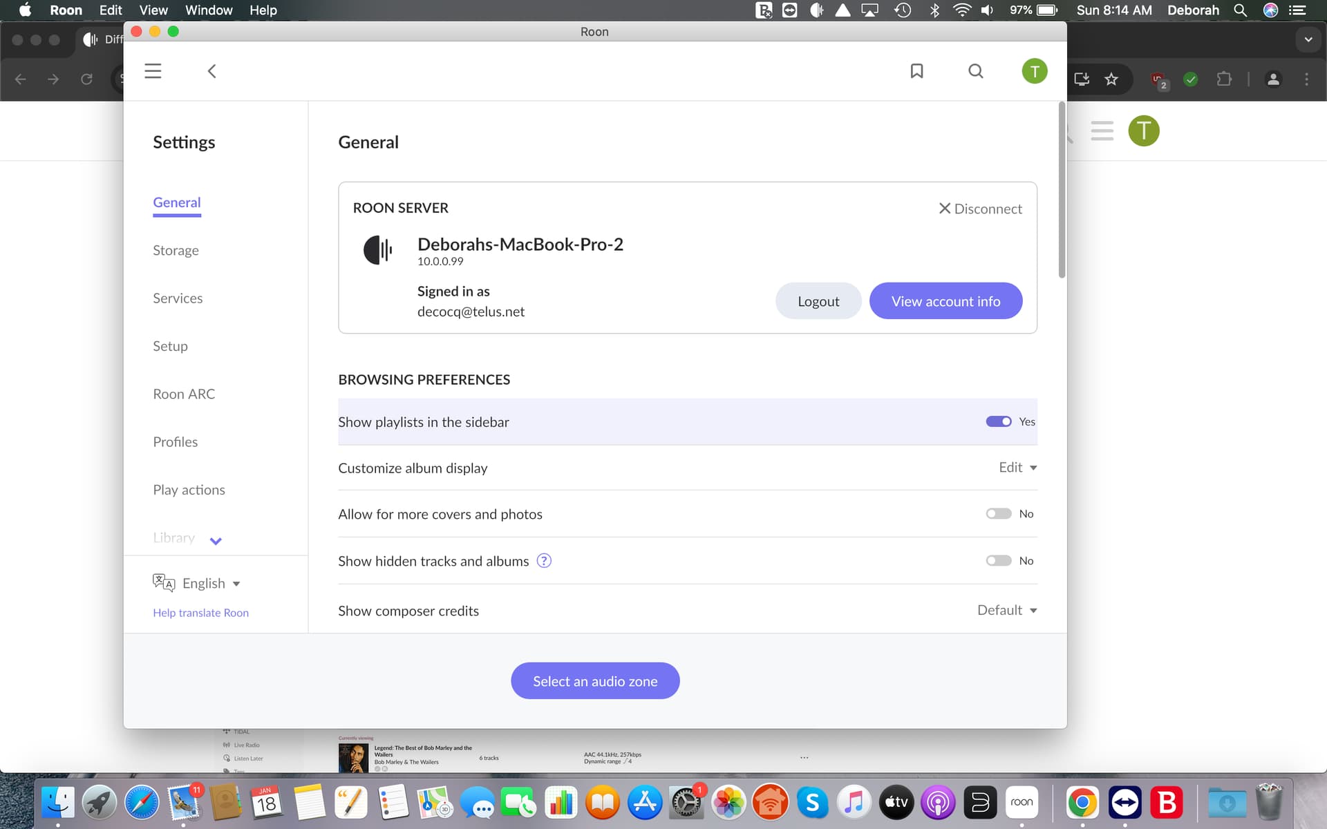

As per screen shot, hidden tracks and Albums have already been turned “Off” (disabled) by default in settings>storage.
And, what will happen if I choose to ‘disable’ the files under ‘General’? If I do this, in what file will Roon store my music?

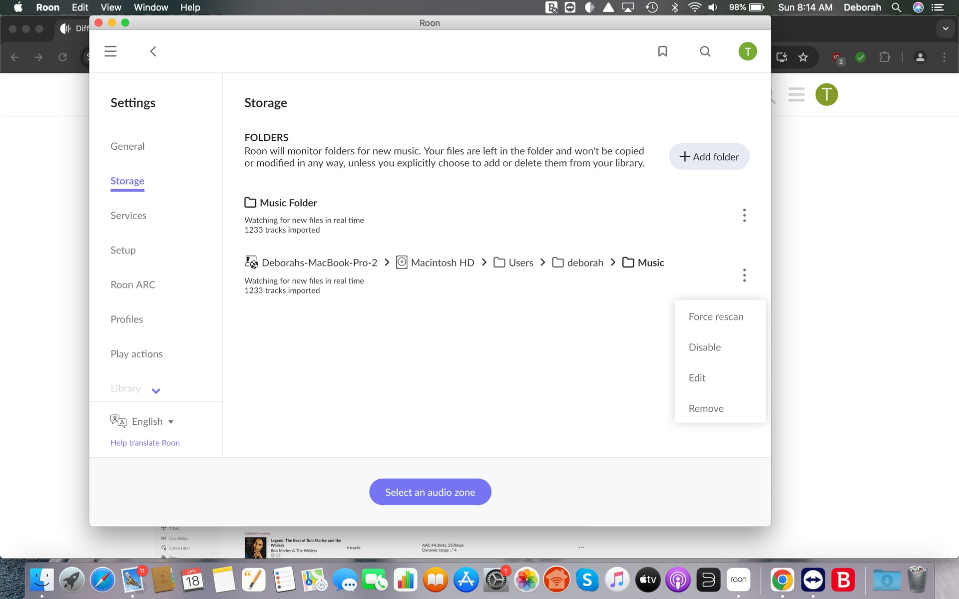

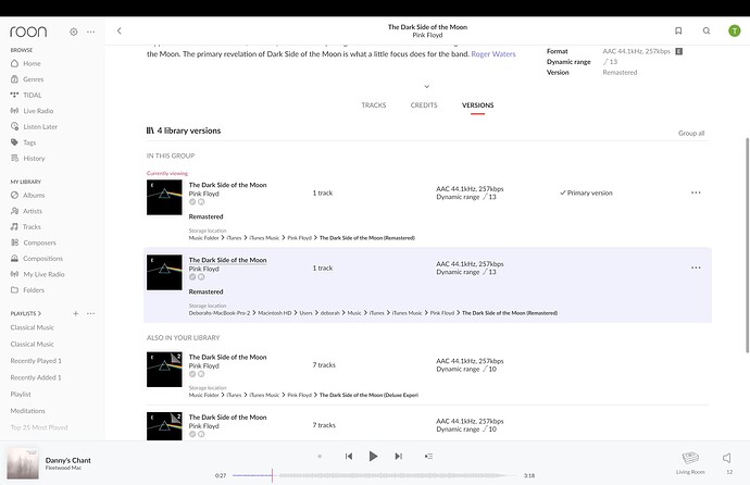

Your last screenshot in the above post shows that you have explicitly added the Music folder on your Mac (where your Roon Server is running) as a Watched Folder.
The thing is, the Music folder has also been added by Roon Server by default (showing as Music Folder).
So you have the same folder set as a Watched Folder twice - hence all your albums are duplicated.
Just delete the second instance of the Music folder that you added - use the “3 dots” menu and choose “remove”.

Yes, that’s it.
Don’t worry, you won’t break anything.
Okay, but did you read my question?
Yes, the one that you added manually, because it’s a duplicate of the same one that’s already there by default („Music Folder“)

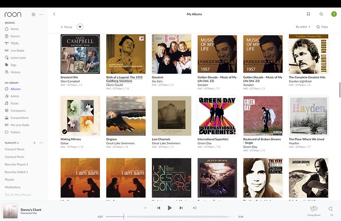

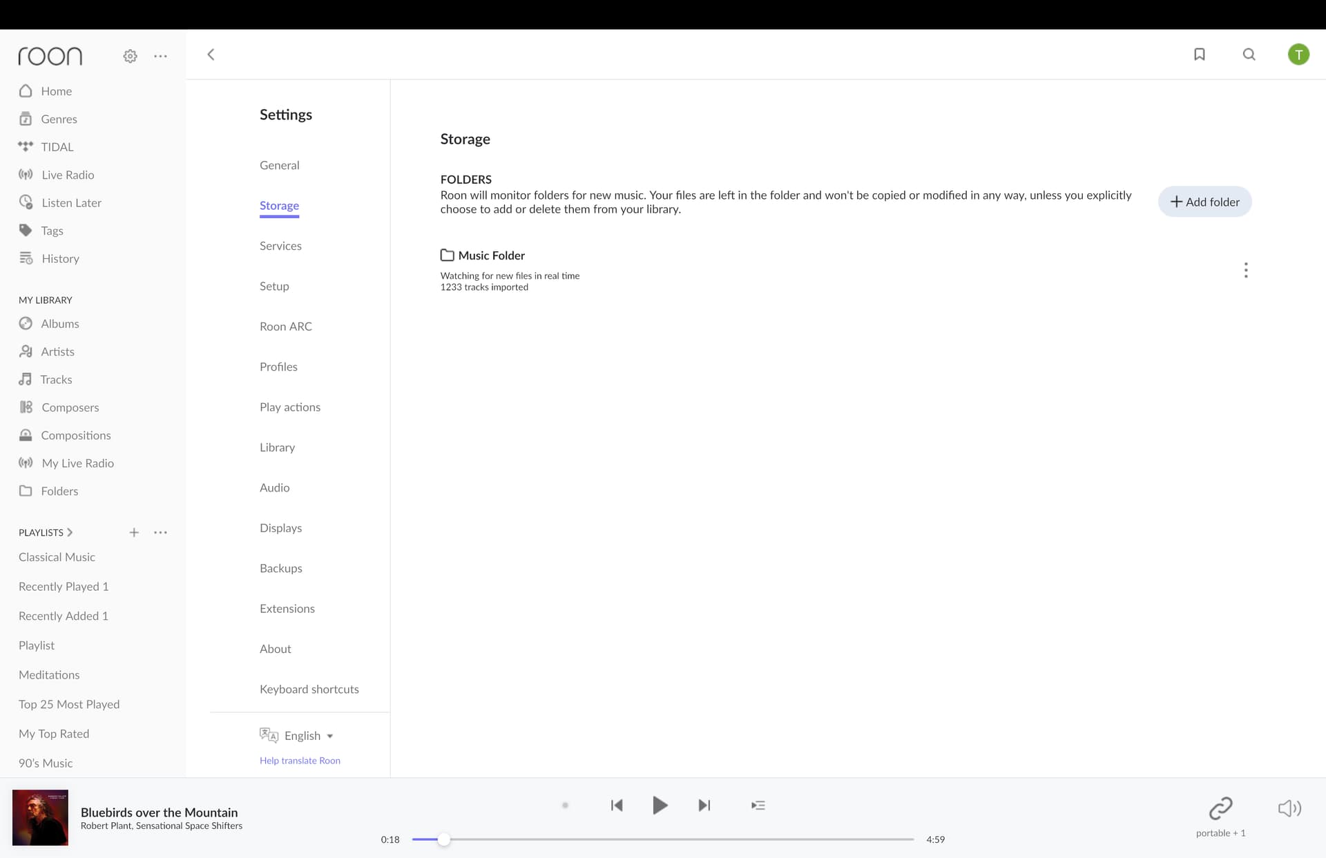

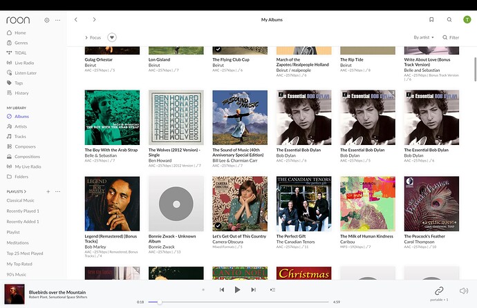

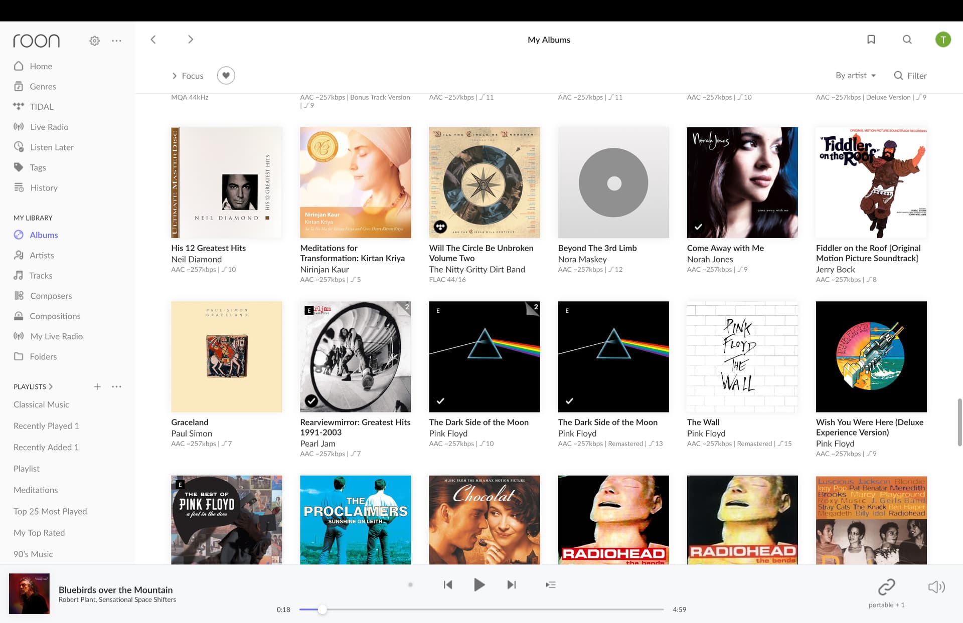

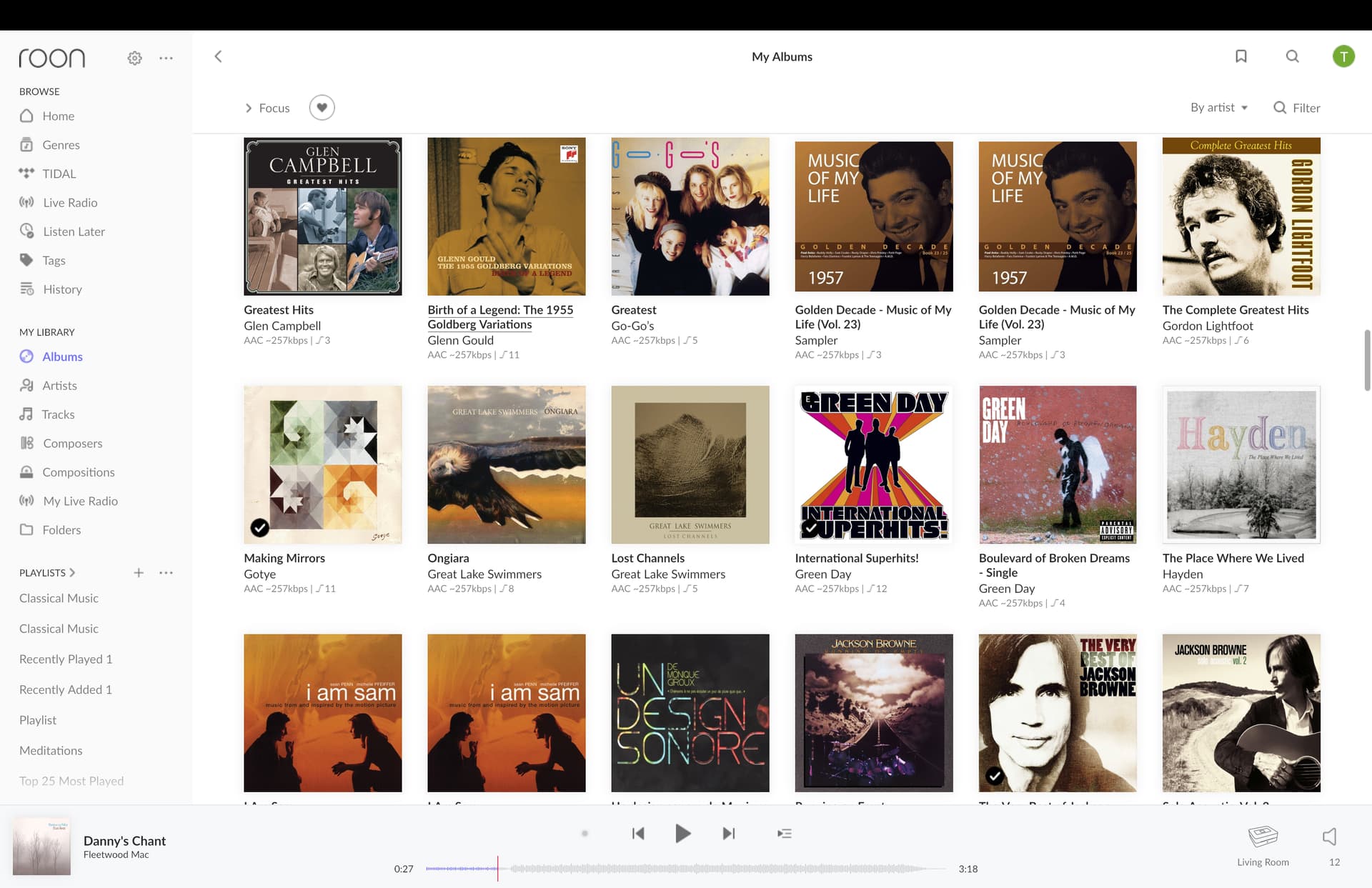

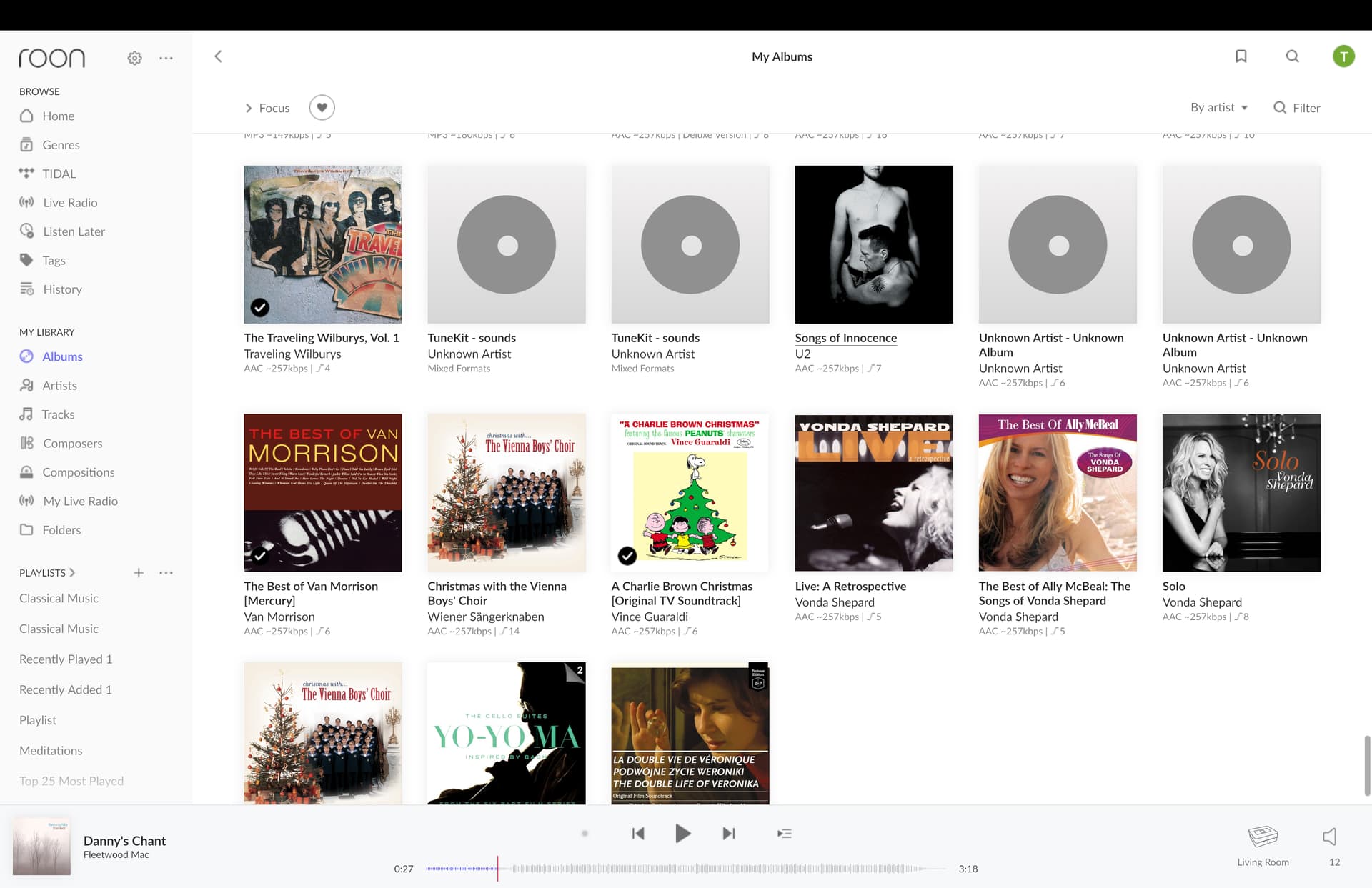

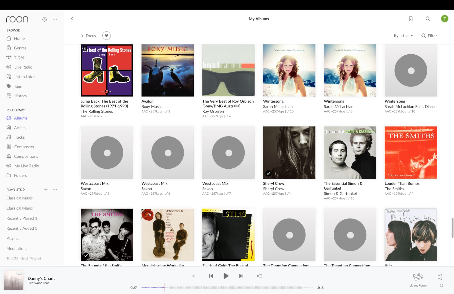

Okay thanks, please see the folders I “Removed”. ( I am just left with the what I presume is the "Default Music folder) While this fixed a number of duplicates, I still have a number of duplicates and triplicates. See attached.

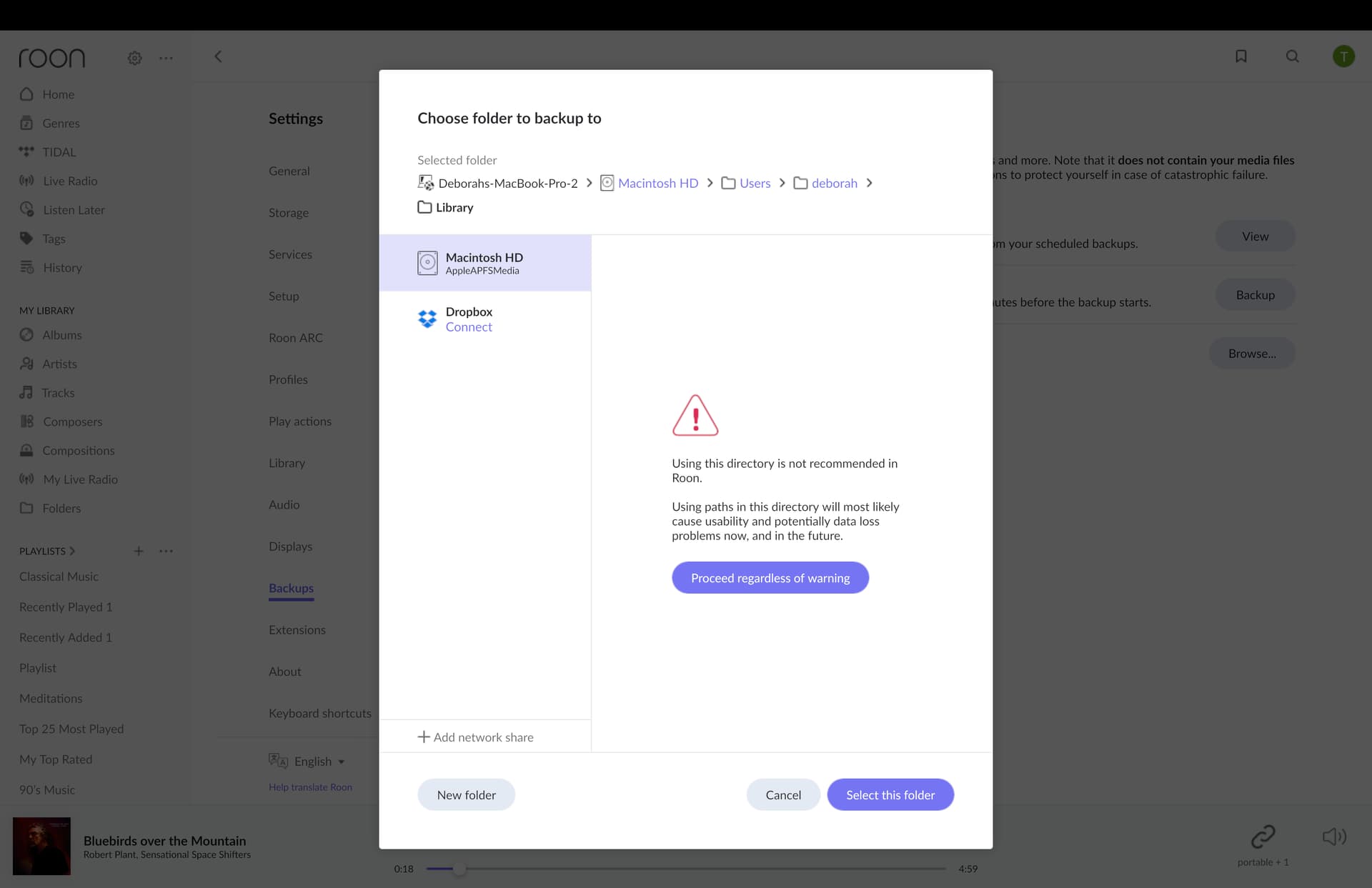

Just to be 100 percent safe, perform a backup first, under settings → backups.
And after that, goto settings → library → library maintenance → cleanup library. Tick all the boxes there and perform the cleaning.

(1) When I go into settings>backups, it gives 3 options one of which is"Back Up Now". It then tells me to select a location. Next screen says Choose a folder to backup to. Library is in bold but nothing happens when i select Library. This page also says Warning, Using this Library is not recommended.
After you advise me what to do, I will go to your next step of Library Maintenance.
Create a different folder on your Mac, anywhere outside the Music and Library folders, and choose this.
(By the way, you should always have a working backup configuration at all times, ideally more than one on different drives, if you value your Roon library metadata content. Bad things can happen)
Could you select ‘Deborah’ at the top, then click ‘new folder’ at the bottom, name that folder ‘Roonbackups’ and proceed?

Yeah, so don’t select that one…
Either do this…
Or, e.g., in the Mac Finder go to “Desktop” (or some other place) and create a new folder, e.g., MyRoonBackups. Then, in Roon, go to MacintoshHD > Users > deborah > Desktop, and select the new MyRoonBackups folder.
