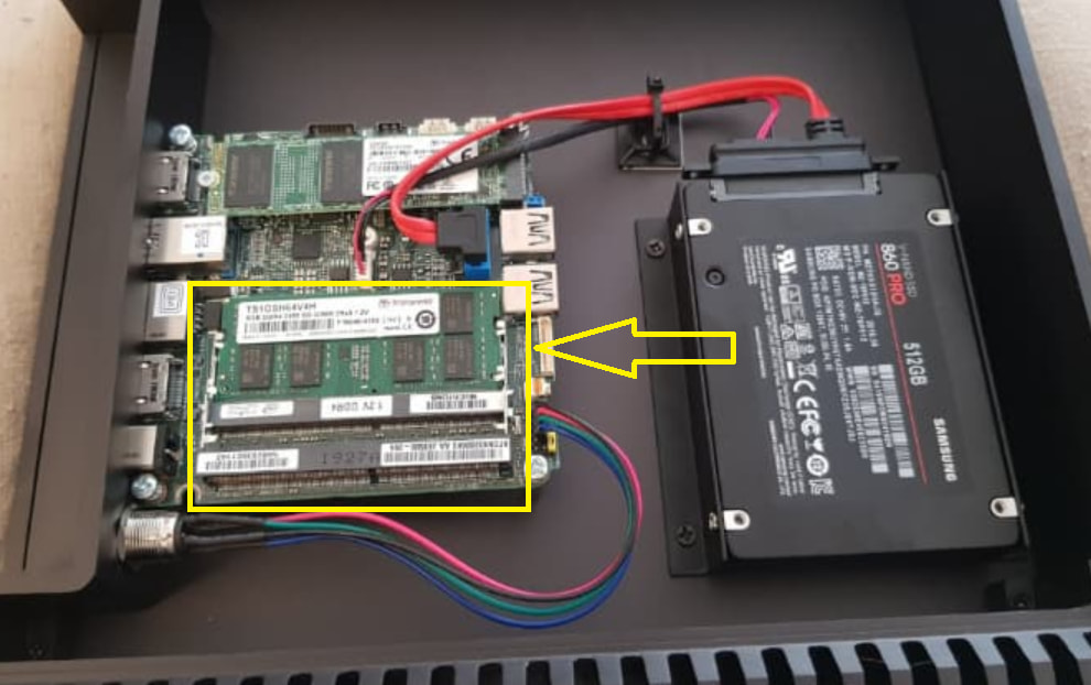

When you remove the bottom plate on an older Nucleus, it should look something like this. I’ve pointed and highlighted the memory chips.

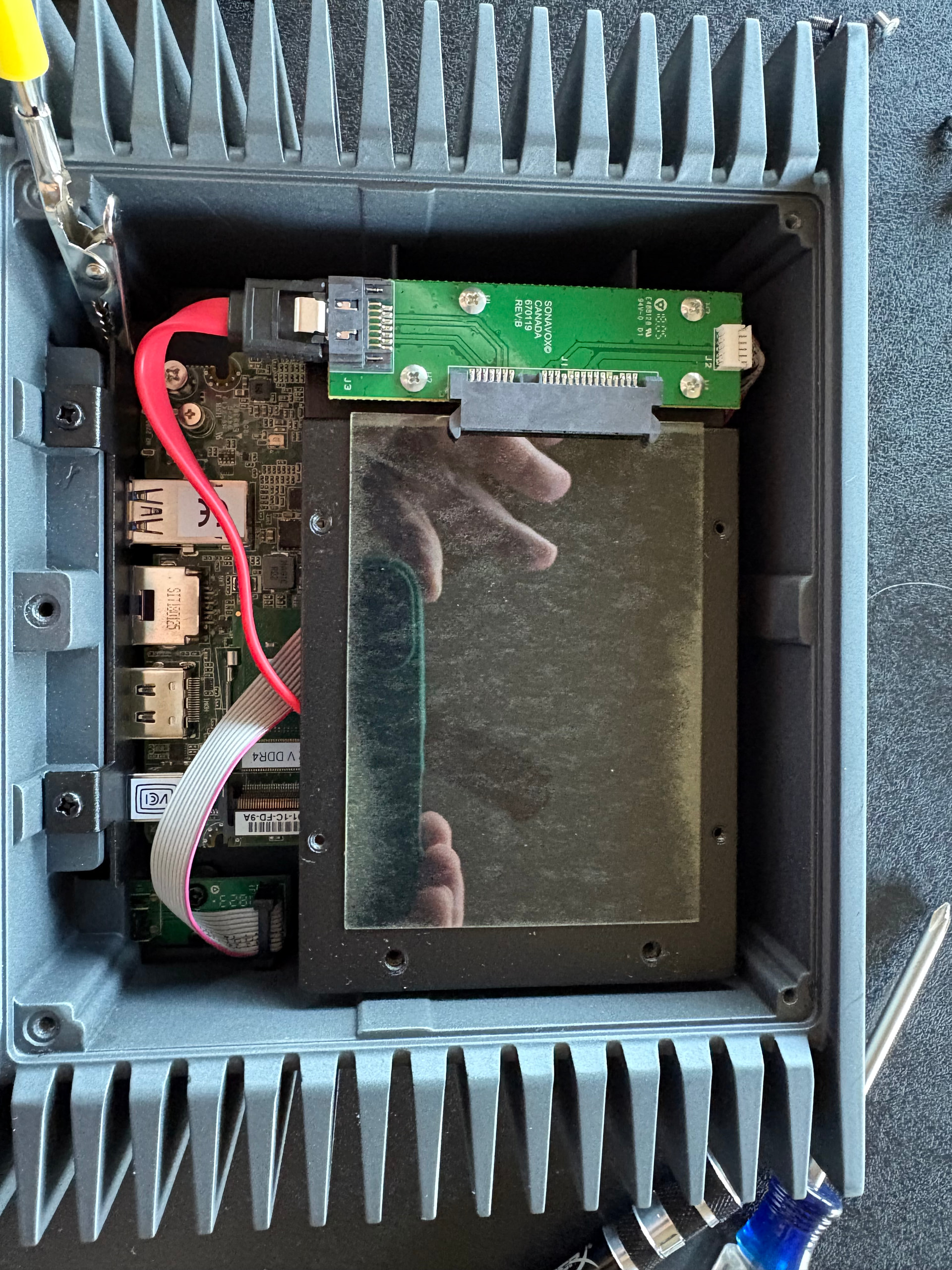

I think Rev A is the oldest nucleus model and the interior does not look like that. The SSD is above the motherboard rather than next to it. I’ll post a photo when I open it up again.
Here’s a picture of the rev A:
You will have to remove:
  1. The bottom panel from the case
  2. The drive cage for better access
Then you can unclip the ram, tilt it 45 degrees and then u can take it out / replace.

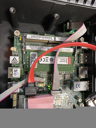

Hard drive has been removed but I have no idea how to remove the “cage”
You can see two tiny black hexagon-screws holding the ssd. Those need to be removed. You can see the module that says ddr4 in the bottom left of the picture.. I guess that will be your ram-module
I think I got it. I also needed to unclip the red cable, then remove the 4 silver screws connecting the board that the ssd connected to. Then I gently lifted the ssd connection board (keeping the other cache connected) and there were two more black screws holding the ssd cage. Once those were removed as well as the other two black screws on the other side of cage, I was able to lift out the cage and swap them ram. Everything reassembled smoothly and everything is working correctly - and performing faster! Thanks to everyone’s assistance! Hey Roon, you should consider updating your instructions. Cheers!
