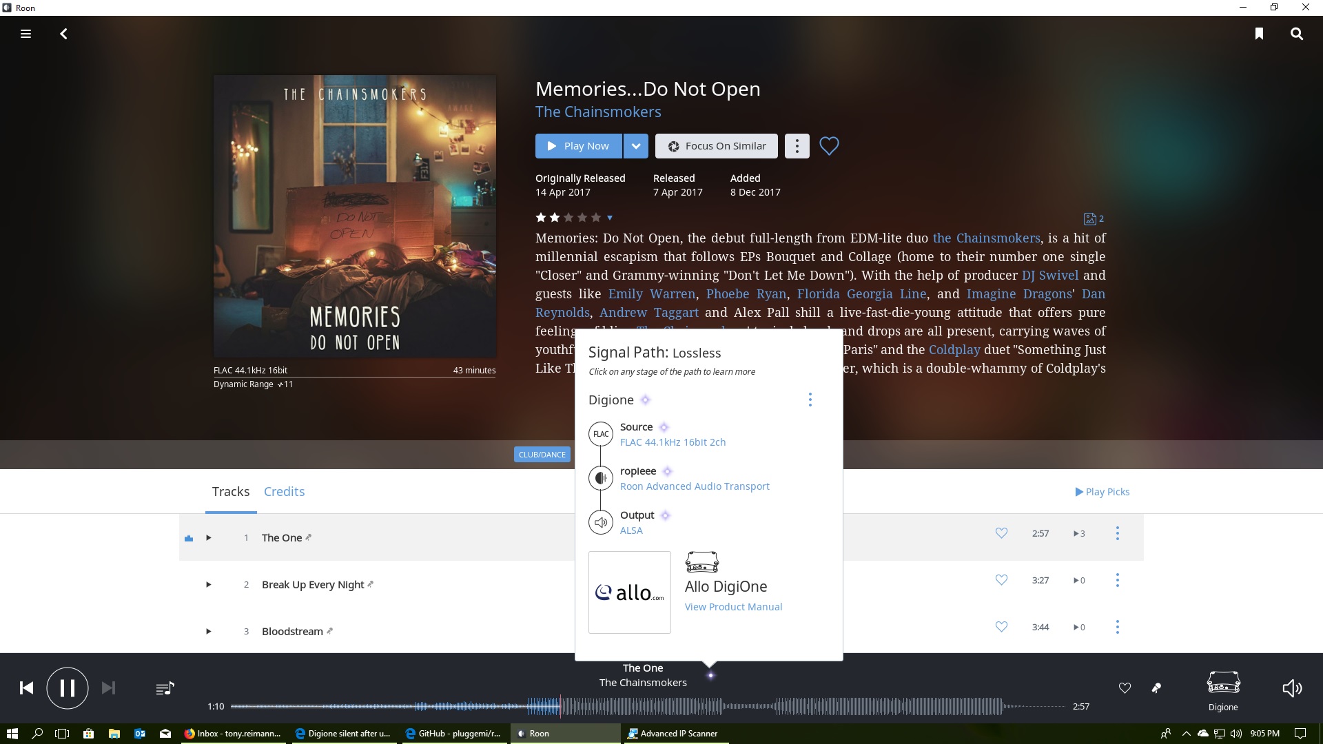

@support Since the last update to Rock a few days ago my Digione doesn’t output sound. It is running on a Ropieee system V095. Everything shows as playing in Roon and on the Screen attached to the Pi running Ropiee, where the digione hat is also installed, but no sound out of the amp. I have checked all physical connections, rebooted everything etc.
You don’t have the volume down on the Roon remote interface do you? Can you maybe post a screen shot of the main window and the audio path too?
Volume is fixed and controlled by integrated amp.
