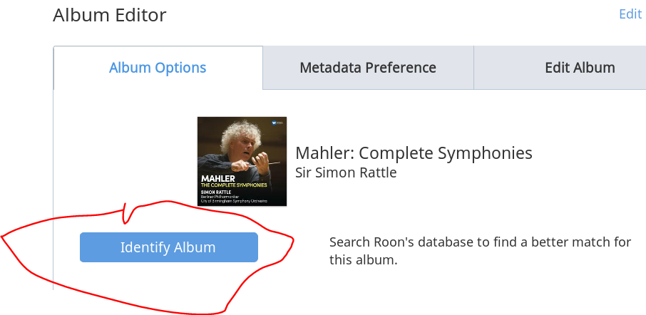

I found another possibility. Are you familiar with the album identification wizard? There is a digital download version of this album which has a single disc with 36 tracks, but a different level of concerti grouping which might be more to your satisfaction.
I’ve heard this mentioned a few times now. What is it?
I think it is this:
choose edit and:
Ah. I use that all the time. I didn’t know it was a wizard. Thought there was something I had missed.
I only use it with unidentified albums (or at least try to) and bought digital/downloaded classical works to get better metadata (so linking it to a physical release).
I ignore all other wrong metadata. In general Roon does a pretty good job, but then again I have very few classical works.
