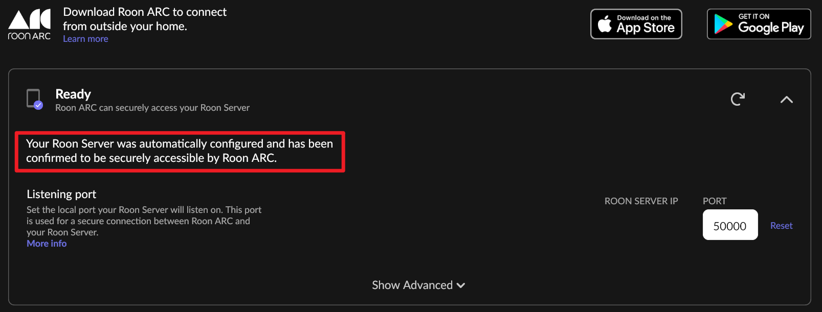

Roon ARC works after clearing the cache and removing data, on the local network only. However, Roon (Remote) still refuses to start after performing the same steps. (Both on Android)
I suspect a lot of my Roon discovery issues are due to UniFi switches and gateways. UniFi really managed to royally screw up IGMP and mDNS. Fortunately, the latest Early Access firmware (7.2.122 for switches) seems to fix things (fingers crossed).
That being said, Roon ARC has not been able to connect remotely for a few months now.
