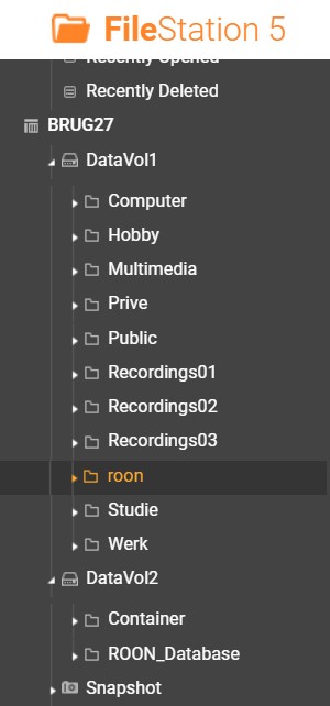

Thanks …. but QNAP help clarifies how to move a folder to a different VOLUME not how to move them to a (new) folder. (They are way too big to try a copy).
I accidentally hit Enter before competing my post, so please revisit.
Do not create a new volume because all the files are on a single volume, and moving files is near instantaneous.
Thanks for the clarification warning.
Still do not understand how to MOVE the 3 recordings folders to /Music (my very limited understanding is these recording folders are “shared folders” and cannot be moved).

You may be able to use File Station to create the new folder, and move the folders.
However, so not use a remote computer as this will copy rather than move the folders.
Thanks for reaching out, but as per my original question: you cannot move shared folders un file statuon.
You can move folders under the mount, i.e., DataVol1. File Station 5 has the move feature in the toolbar and context menu.

There was/is NO move option in Filestation (for shared folders) only copy.
Moving Files and Folders
You can only move subfolders underneath a mount. You can move files or folders either individually or in batches.
Thanks for trying to help me out but … as stated in my original question there is NO move option in the menu (only “copy”).
Well this appears contrary to the QNAP documentation.
It may be helpful if you could take a screenshot of what you’re seeing and upload here.
