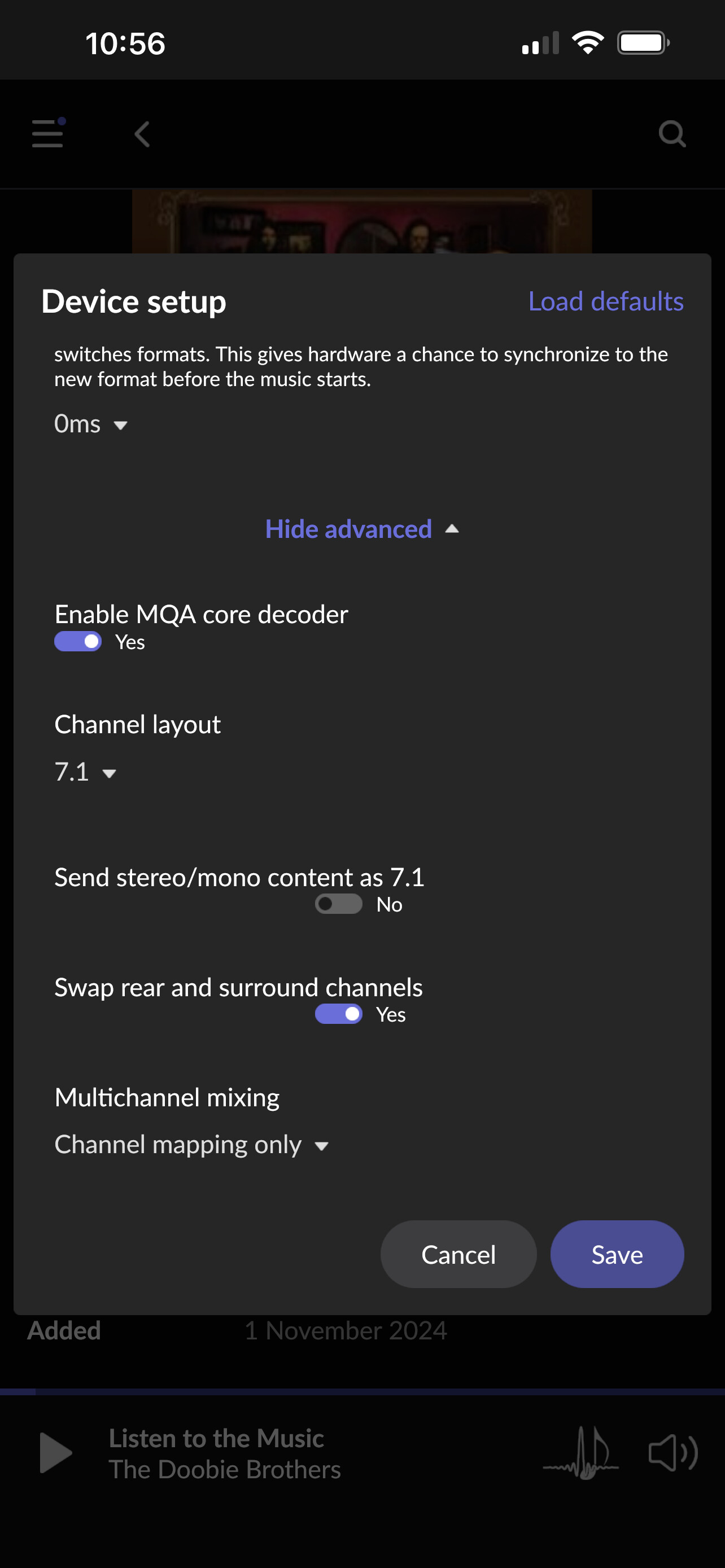

Ok, so setting the output to 7.1 in ROON should alleviate those issues is what I read. I bought 5 Revel F226BE’s to get that matching timbre people are talking about. With 6 channels of Purify power this will hopefully result in magic!

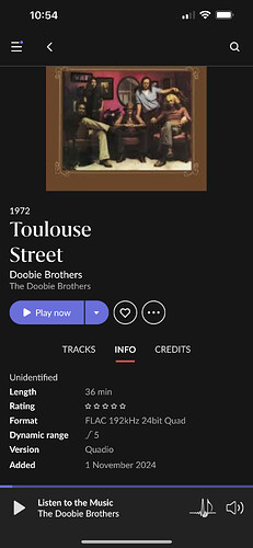

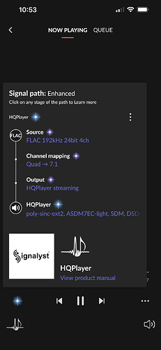

Quad works fine with Roon and an Okto dac8pro. Here’s my settings for a typical quadio recording. JCR
